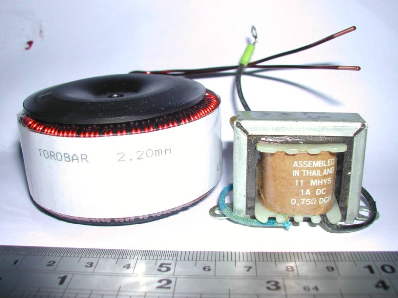

Uli, I'm not convinced. I agree th 10A number is probably AC, but if you look at the picture below. The small one is 11mH/0.75ohm and can take 1 A DC. I'd say the Torobar should handle 4-5 A. Neither have gap's. Anybody tried? or able to make a test?

Of course they work, but you should measure
their HF-damping abilities and then recalculate the inductance.
In circuit you wont see a problem as you dont see the actual
inductance under heavy load!
BTW everybody can use what he is happy to use, if it makes
sense in a financial or technical way is another question!
I would be careful in using techniques for which I dont know
the basic principles as amateur.
Uli😎
PS: normally the classic (right on the pic) chokes have not
a closed loop core but they leave out e.g. the I in an EI core!
Solution is easy: partly unwind a toroid, cut a gap in the core
with a sharp saw, put some paper in the gap, rewind!
PPS: In my youth I worked in an R&D department designing
switch mode PSUs. The main problem was to design the
chokes and transformers with calculating the width of the gap
influencing the rate of inductance loss.

Anyway, the toroids look cool, i.e. you get something
for your money.
Not to be misunderstood, its safe to use them, until the
rated current is reached (AC or DC) but for dc use
there exist better parts for less money.
U.
