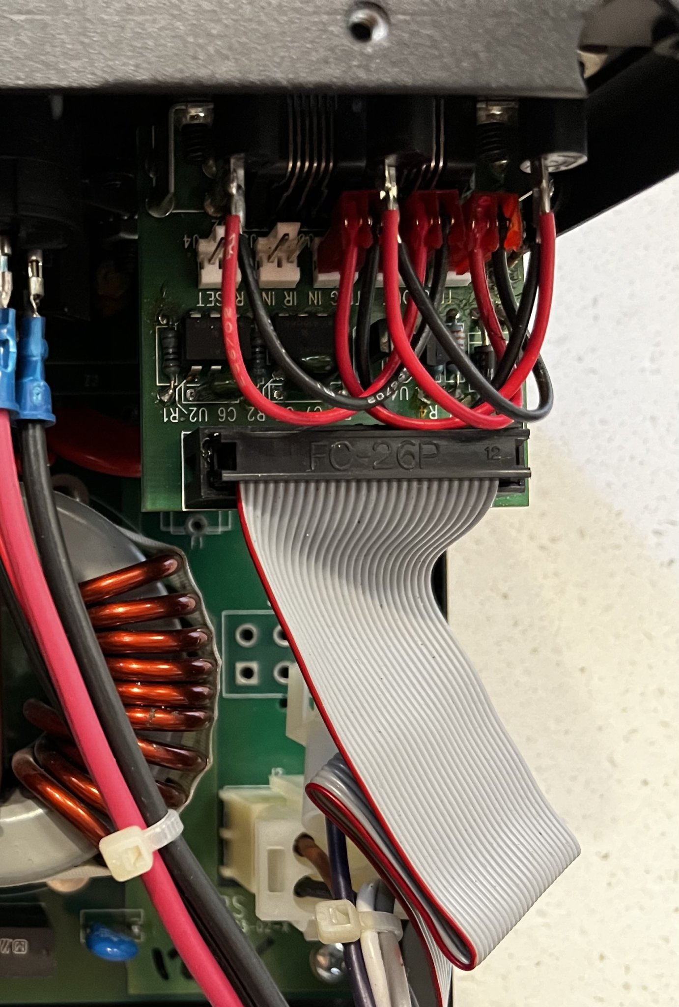

Does anyone happen to know what part this is on the PCA-2 preamp?
The PCB says it’s part “F1”.
Not enough of it left to know what to replace it with.
Thanks in advance for any help!!!!

I’m hopefully that there isn’t too much more damage because the board is just at the power input and is connected by a ribbon cable to the rest of the power supply. Here’s a pic of the board from above with the diodes on the right…just visible through the wires.

It looks more like a dead thermistor to me, rather than a dead fuse.
I have seen many dead inrush limiting thermistors, used to limit current as the capacitor bank charges up, they fail eventually because they are designed to run hot.
They fail when rectifiers or transistors short out, too.
Now you have a choice between an NTC inrush limiting thermistor, which is most likely, and a PTC overcurrent limiting thermistor, which is less likely.
You need to do a bit of reverse-engineering to work out a suitable substitute.

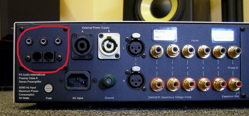

It seems odd, but this board is just connected to the 12V DC triggers and the "PS Bus", which allows the preamp to "communicate" with other PS Audio components.
See the circle in the attached photo.

Do you have a multimeter to help trace where the fuse goes? To the 12v trigger sockets?
It would seem to be a PTC thermistor if there are no bus caps involved, they work like a resettable fuse, just give it time to cool.
Makes me wonder how it burnt like that, what happened? Does it work without that fuse?
I’ve never used the triggers, but recently had a problem when I unmuted the preamp and the volume went straight to full output. Haven’t been able to replicate that issue, but found this damage. No other obvious signs of distress and the preamp seems to be working fine.
