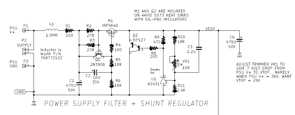

Reading NP's power supply commentary he says, "A far less expensive approach achieves some of the regulation goals, and that is to regulate or otherwise isolate the low power front end of the amplifier, leaving the output stage looking at an unregulated supply." Doesn't this suggest that having stiff to the front end and soft to the OP is desirable?
People enjoy simple and cheap. Simple and cheap DIY projects are much more likely to be attempted and completed successfully. Is powering a front end from the same supply as the output stage "good enough"?? Usually yes by many standards, and it's simple and cheap, works fine. Simple "RC" filtering on the front end voltage rails can be acceptable regarding noise levels and performance.
Do I believe a well regulated front end with voltage rails 5 to 10 volts higher than the output stage to be desirable and "better"? Yes. Is this more trouble and expense for some small (maybe tiny) performance gain? Yes. Is it "worth it"? Obviously opinions are going to vary... Beauty of DIY is you get to do what YOU think is best and right for your own situation with stuff like this. I like mono block amplifiers; some people say that's a total waste.... people say lots of things don't they?

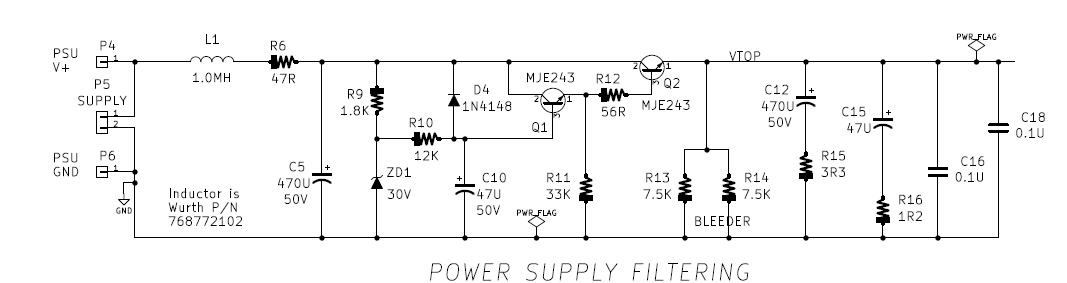

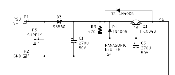

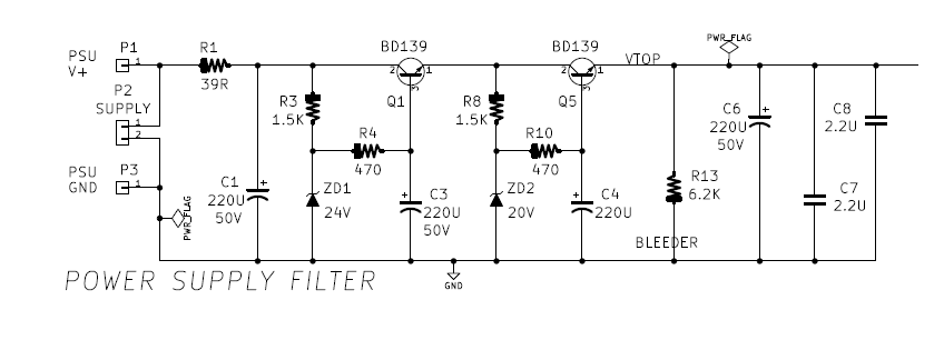

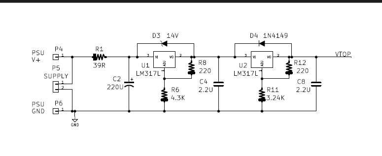

Perhaps one or two of the supply filter circuits that are included directly upon the interchangeable front-end cards for the Ship Of Theseus power amplifier, might give DIYers some ideas or germs-of-ideas. Of course you'll want to modify these, to personalize them so they are optimum for your particular environment, with your particular supply voltage(s), your load currents (drawn by your front end), and your available heatsinking.
