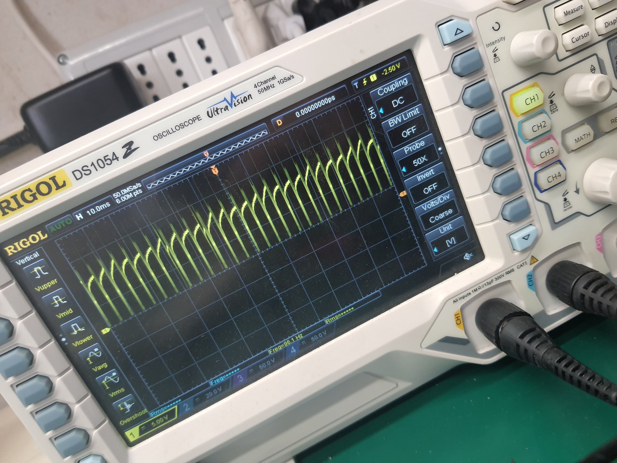

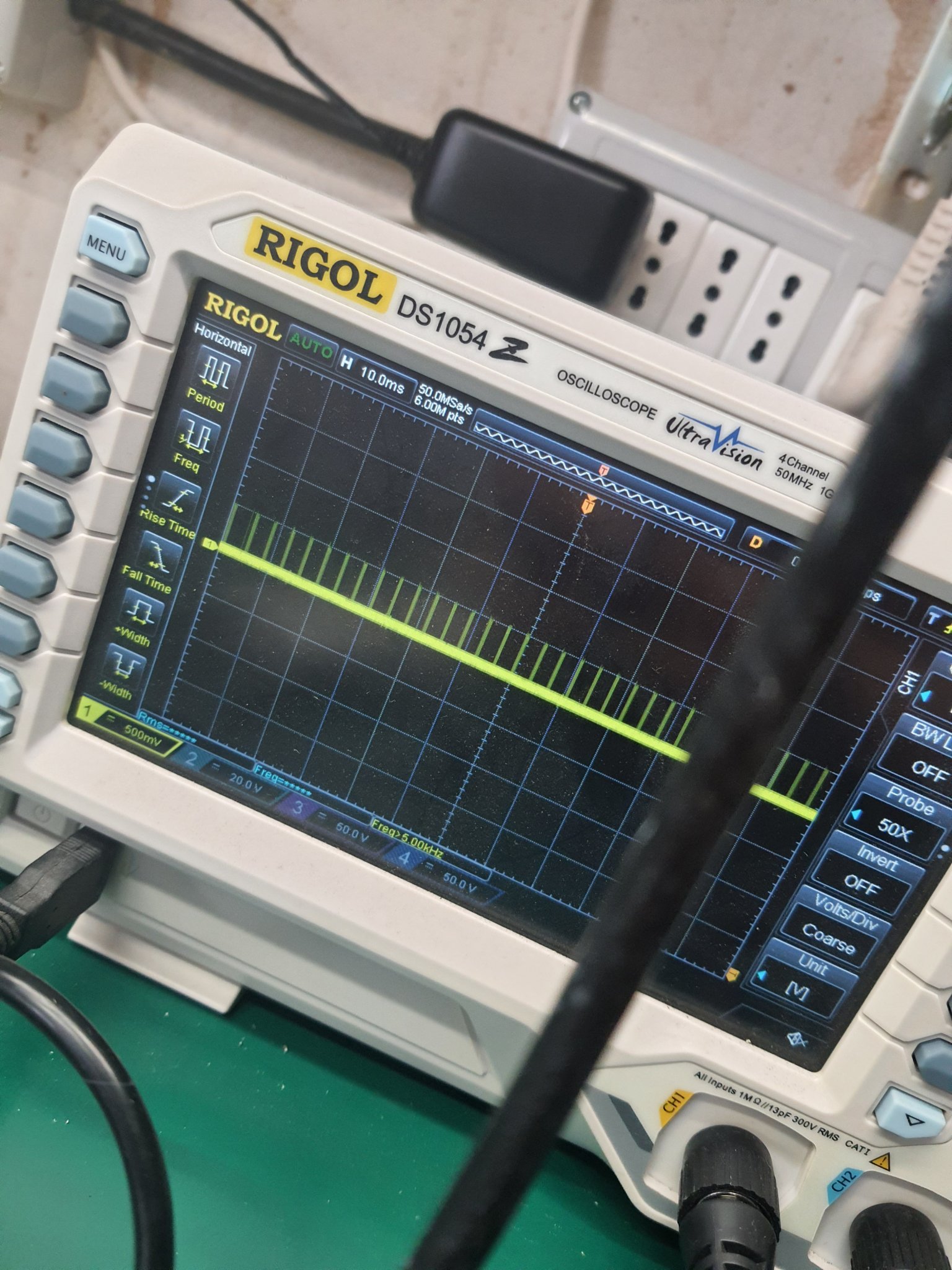

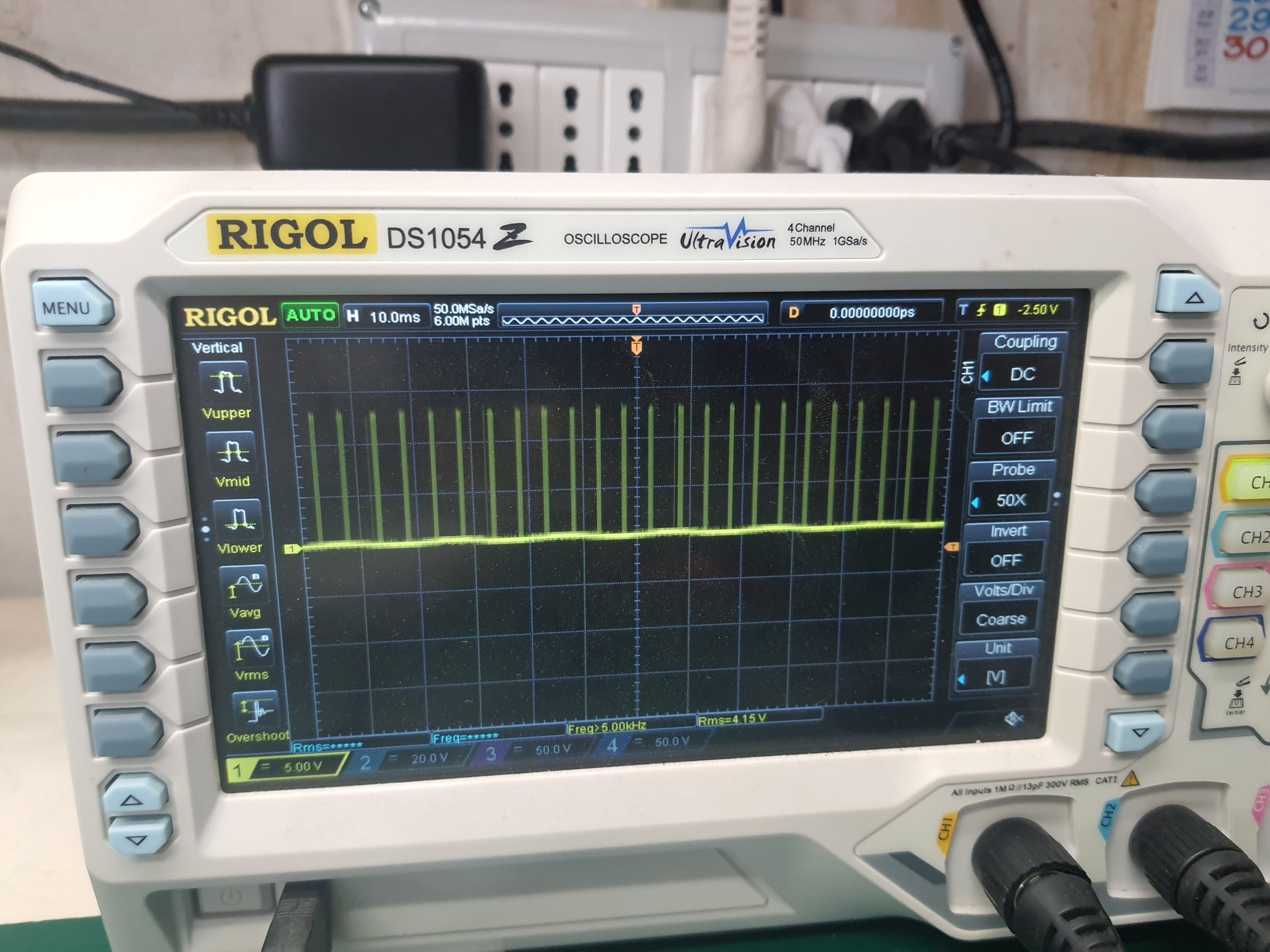

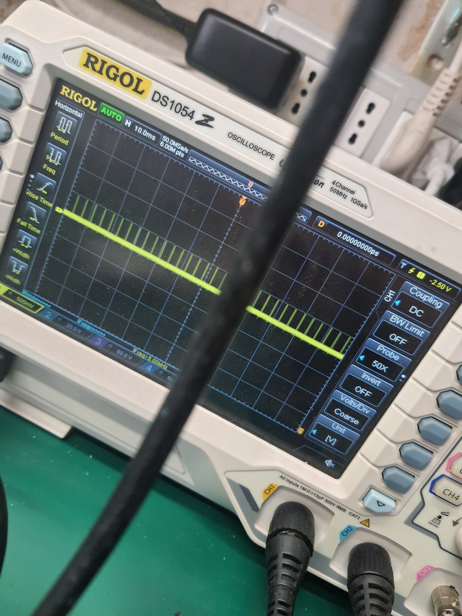

Hi , check all the mpsw42 transistors and the zener diode(D607) if working .......inject a 18vdc across c634 and limit your bench power supply to 0,5amp.your psu should be drawing around 50ma or less......now check the waveforms on U602 ...pins 9 and 10.From there check output of FAN chip and then gates of mosfets.............PLEASE NOTE IF ITS YOUR FIRST TIME DOIN A REPAIR L;IKE THIS ......PLEASE STOP........DONT DO ANYTHING !!!!!!!!!

these are the waveforms i have on pins 9 and 10 ! I made the measurement with the differential probe
