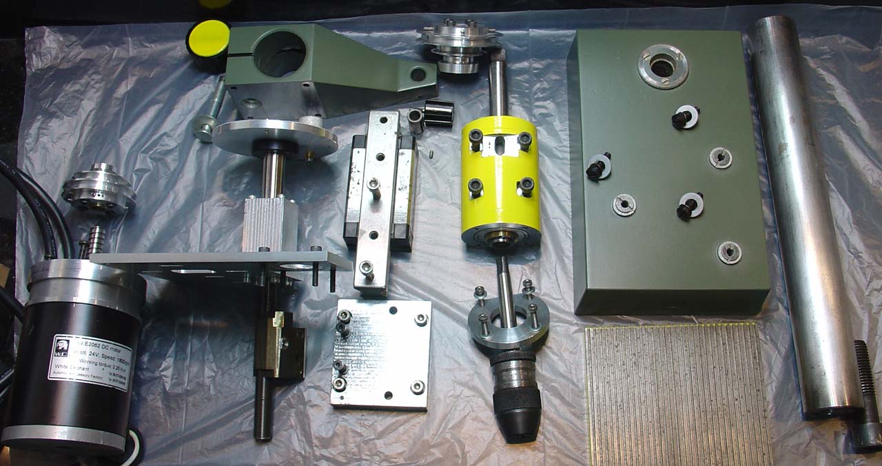

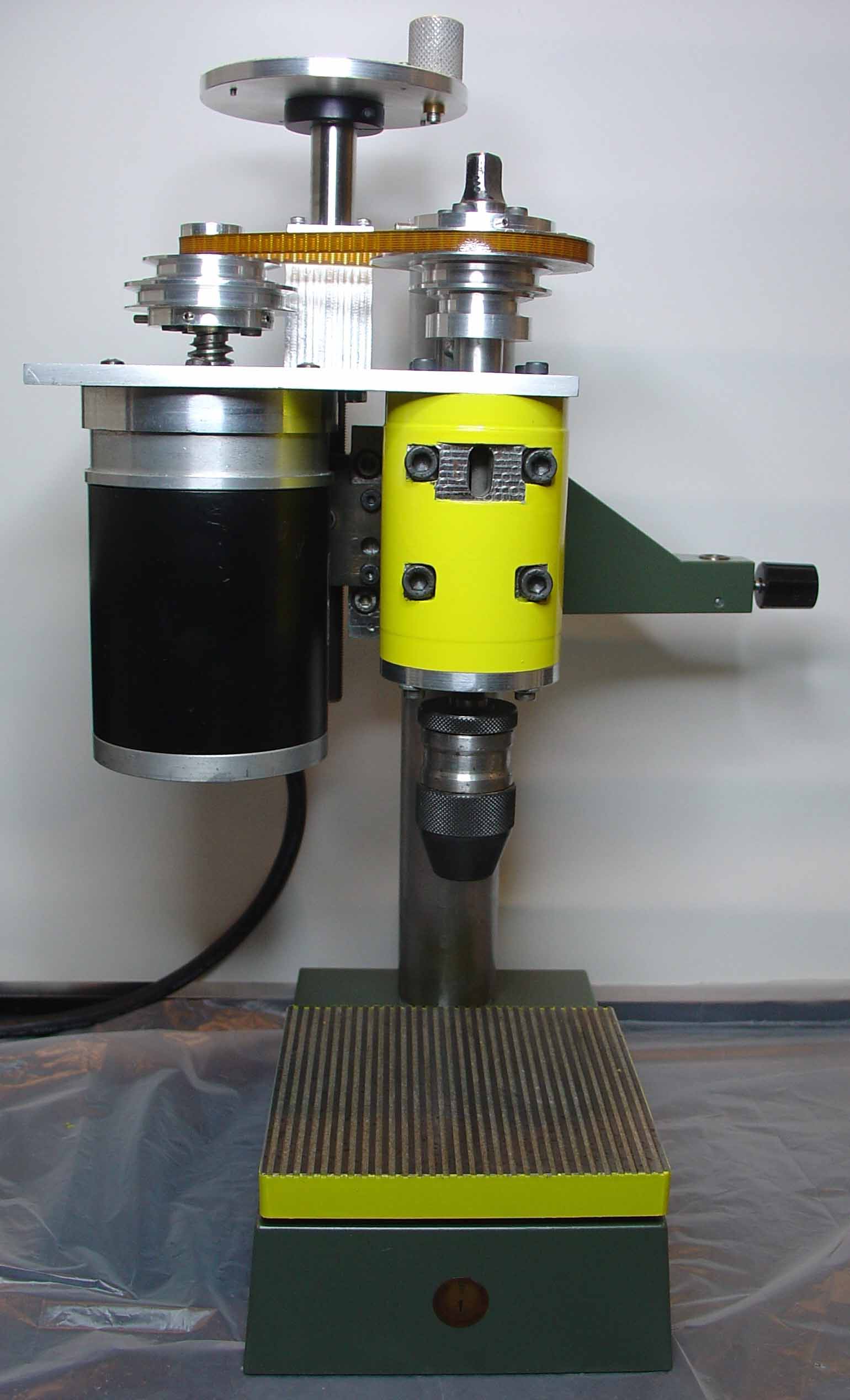

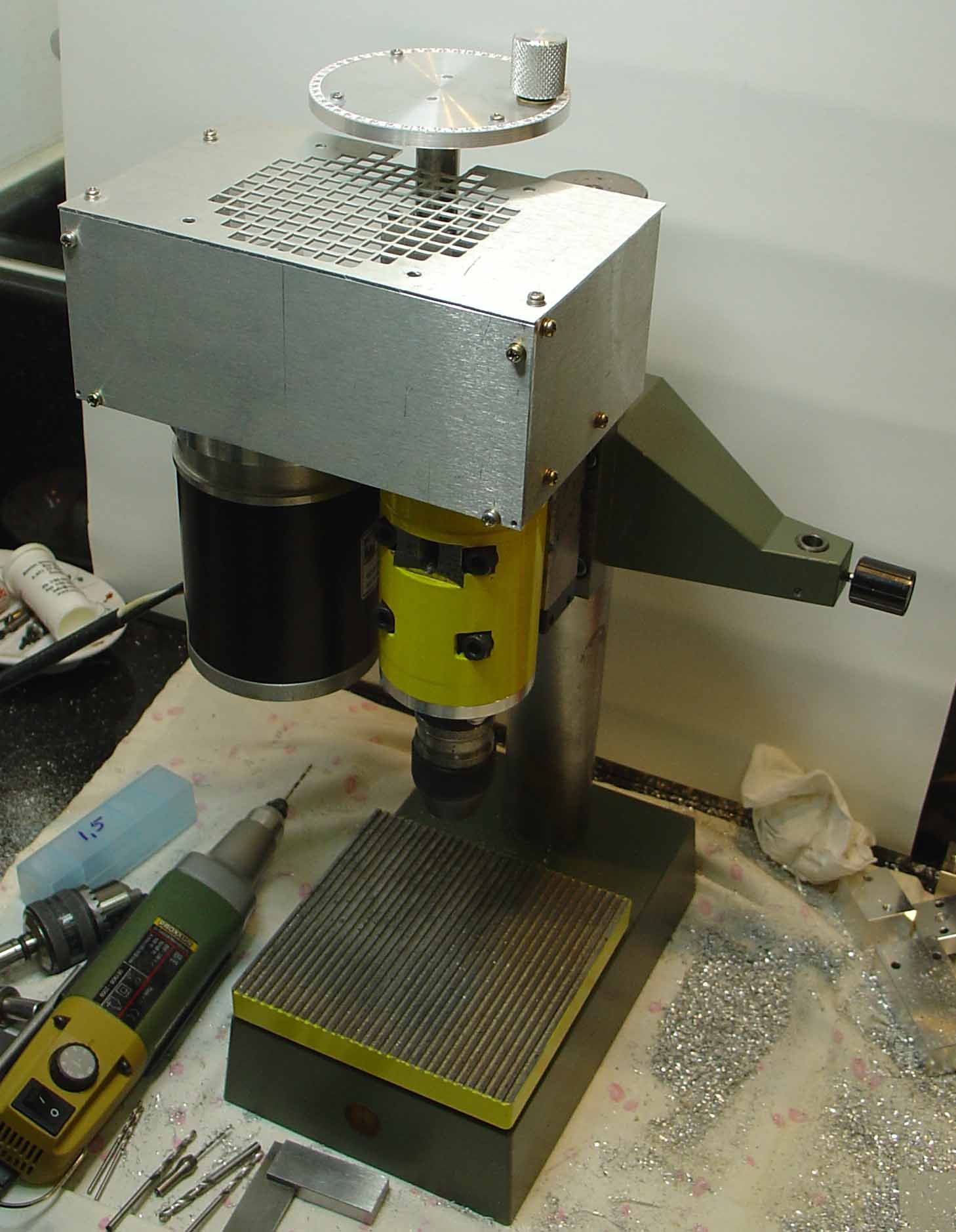

When I bought cheap bench drill for less than $100 (similar to links given earlier), I had to throw it away as it had too much play.
While trying to improve it by replacing bearings with SKF make, I found out that motor winding were made from aluminium wires (varnished to look like copper).
Motor was getting hot even without drilling and the whole drill was very noisy.
I ended up making my own drilling machine.
Motor is 24V DC and with adjustable power supply and 3 pulleys I can achieve from 100 to 3000 rpm, run-out is around 0.01 mm.

Very pretty indeed, but what did you use to drill the drill?

I've used that terrible Chinese drill, Proxxon MF70 mini mill and PD230 lathe to make it.
