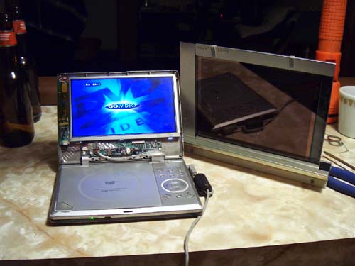

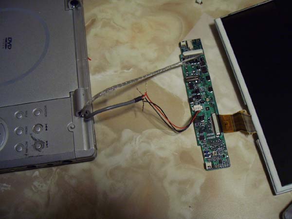

Portable DVD player screen
GoVideo gvp-7811. DVD did not play anymore but all the inputs still functioned, picked it up for 9.99. It has a 7" display, smaller than the 8.5" it is replacing but I hope that the size reduction will be less evident due to the updated technology. See the two screens below.

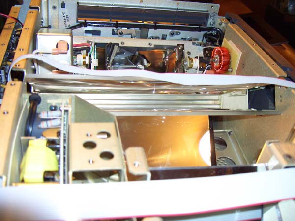

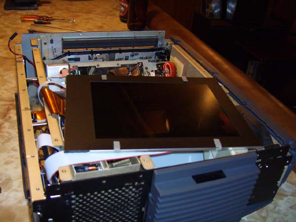

Where to place
If you look you can see two acrylic fresnels that the lcd must be situated between.See the picture.
I had to make a frame for the replacement as there was a size difference between the original and the replacement.
