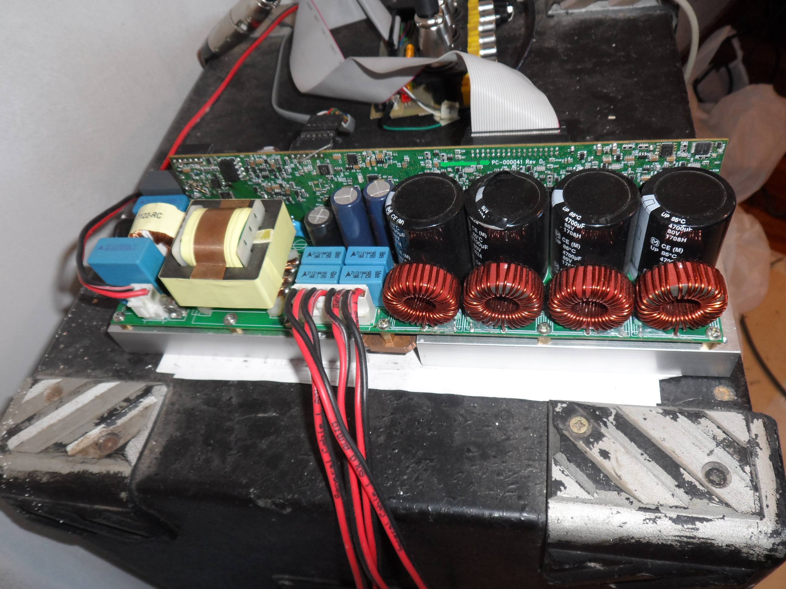

Hi guys.
I am after some images of class d amps being prototyped,
Veroboard / Strip board / Breadboard etc.
Any and all images help!!
(If there is a specific thread for this please let me know, I have already looked in most places....)
Thanks 🙂
Mark

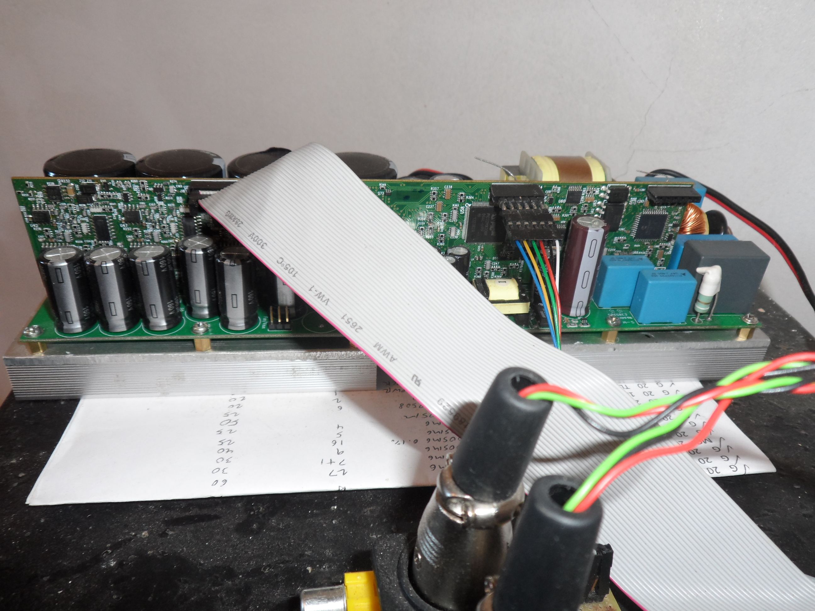

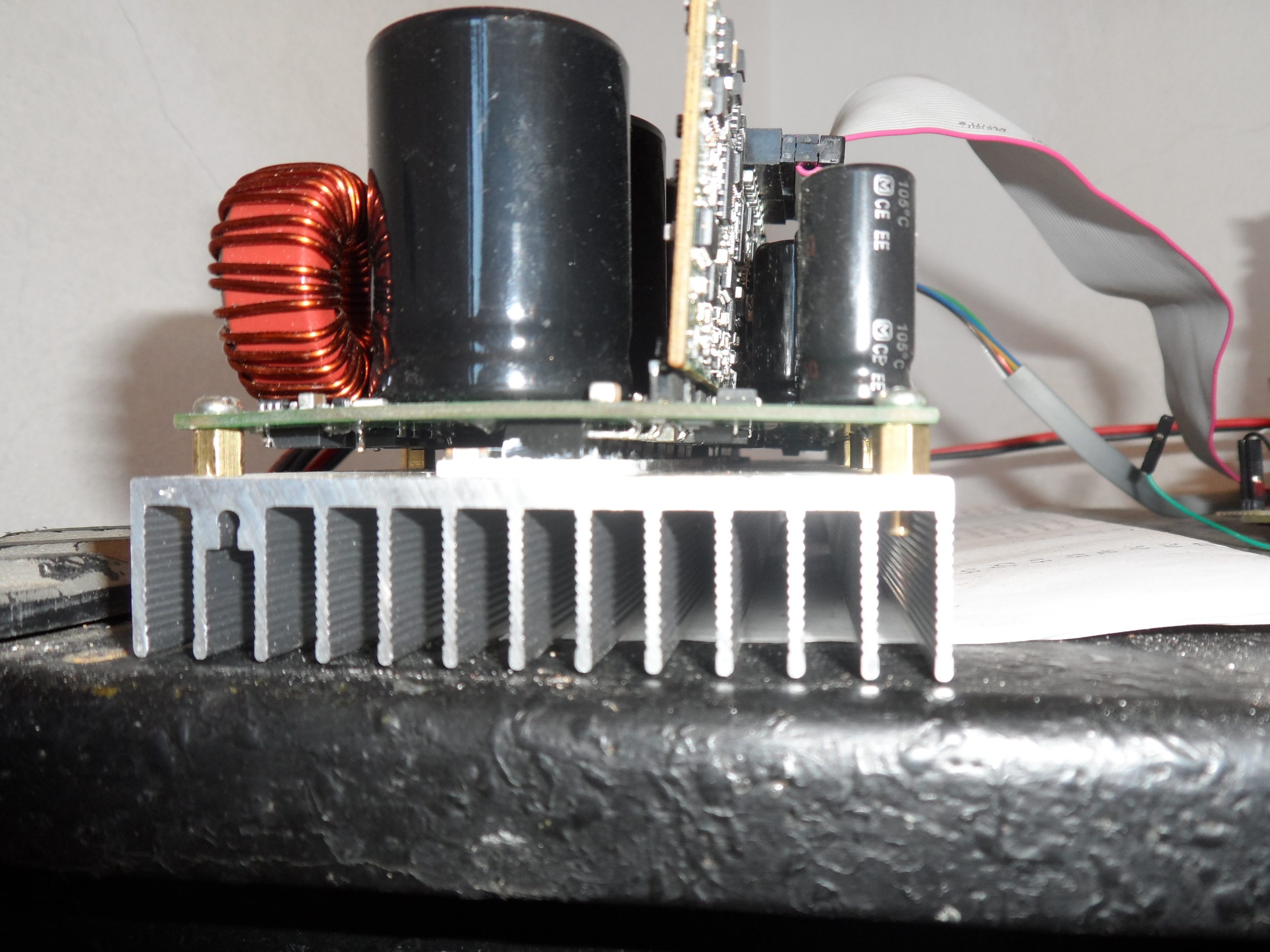

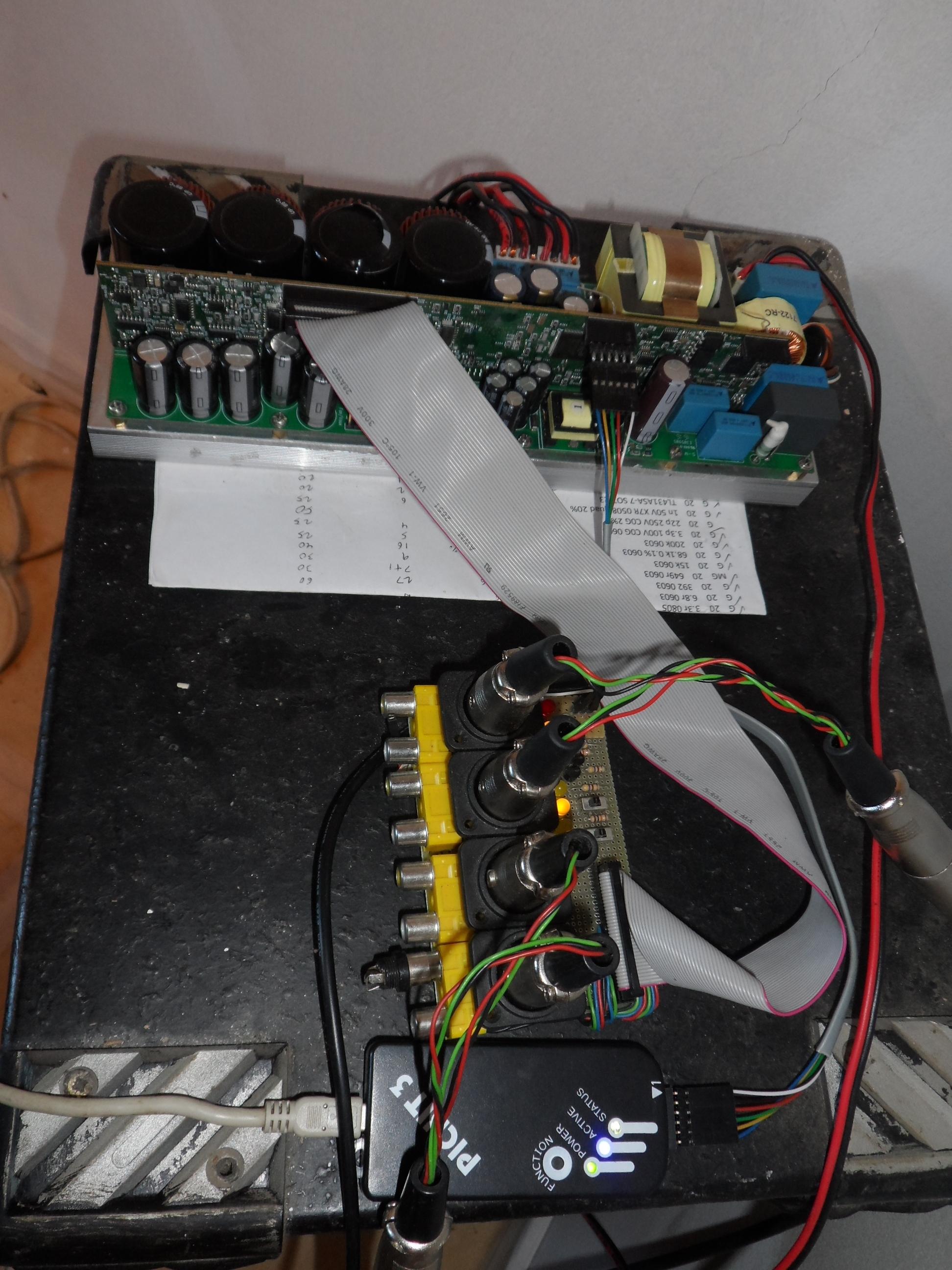

Pics taken while refurbishing and painting design room. This innovative amp is unreleased yet. Class A monotonicity to 50W. 4x250W/8. 2x900W/4. Excellent limiting for loud applications, gain reduced just at the right rate.
Early resonant flyback PFC power test @ 1600W audio output: https://www.youtube.com/watch?v=ztISHByR88s
