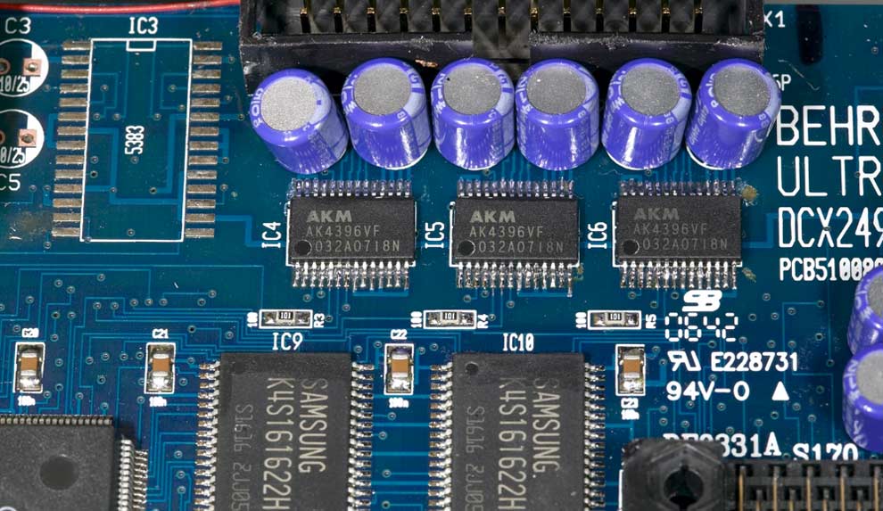

I just came across this great thread. This is very interesting because Behringer DCX 2496 uses AK4393 chips. As far as I understand AK4393 and AK4396 are pin compatible, so exchange on the existing board is possible. Receiver chip in Behringer is CS 8420 and that should be exchanged for CS8416 in order to use full potential of new chips.
Macgyver could you please confirm if my thinking is OK? Any news on your project?

Yes, AK4393 and AK4396 are pin compatible. I'm not familiar with the receiver chip, but I think you will find some info in the datasheets etc.

just to report that I did swap those two chips - 4393 with 4396 and it works great.

AK4396
AR2,
Can you provide more info about your apgrade?
I want to upgrade my SRC2496 with AK4396.
thanks
AR2,
thanks
Re: AK4396
http://www.diyaudio.com/forums/showthread.php?postid=1370667#post1370667
And here is the picture.
Here is the link for the upgrade I did:baszta said:AR2,
thanks
