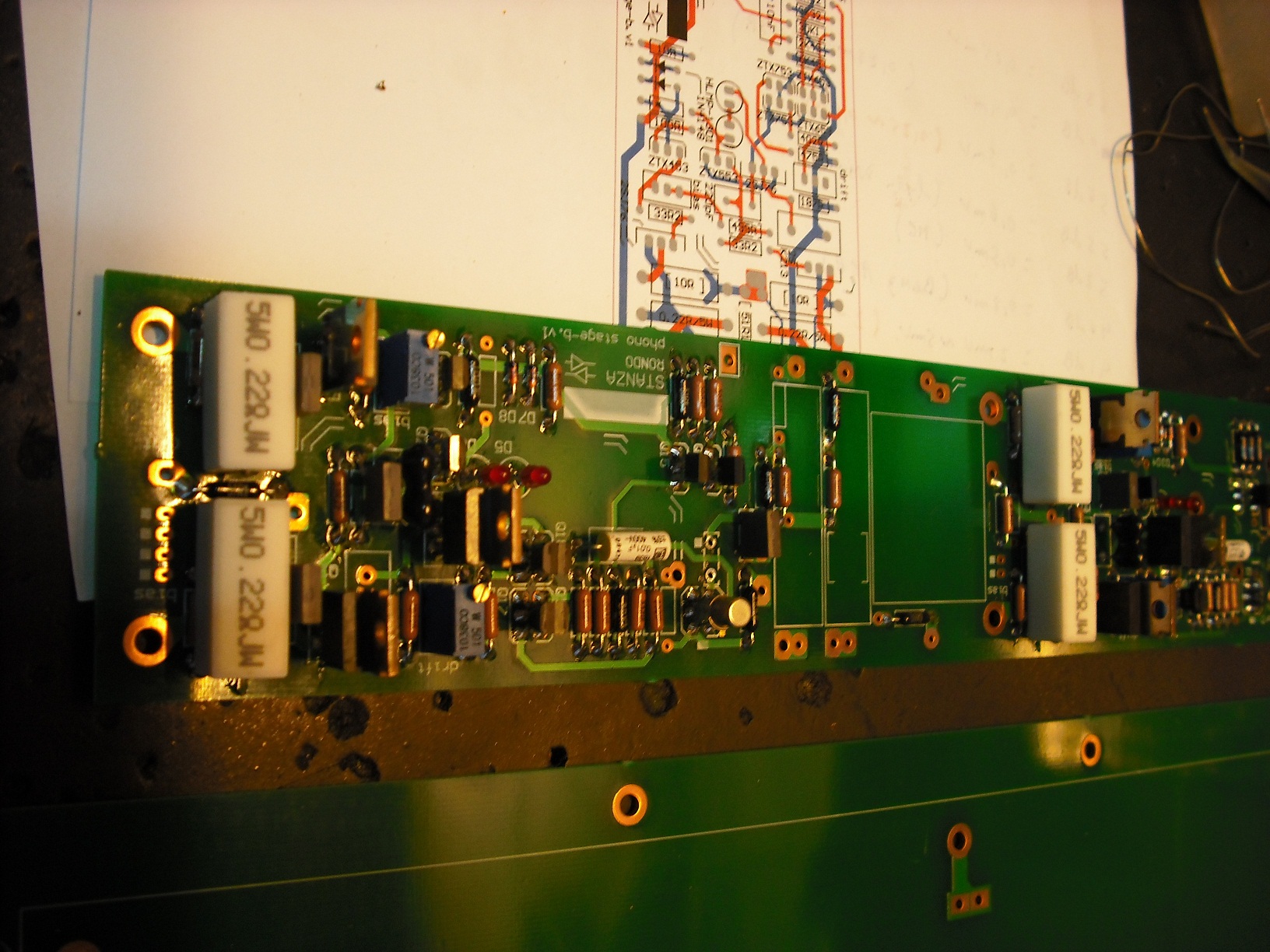

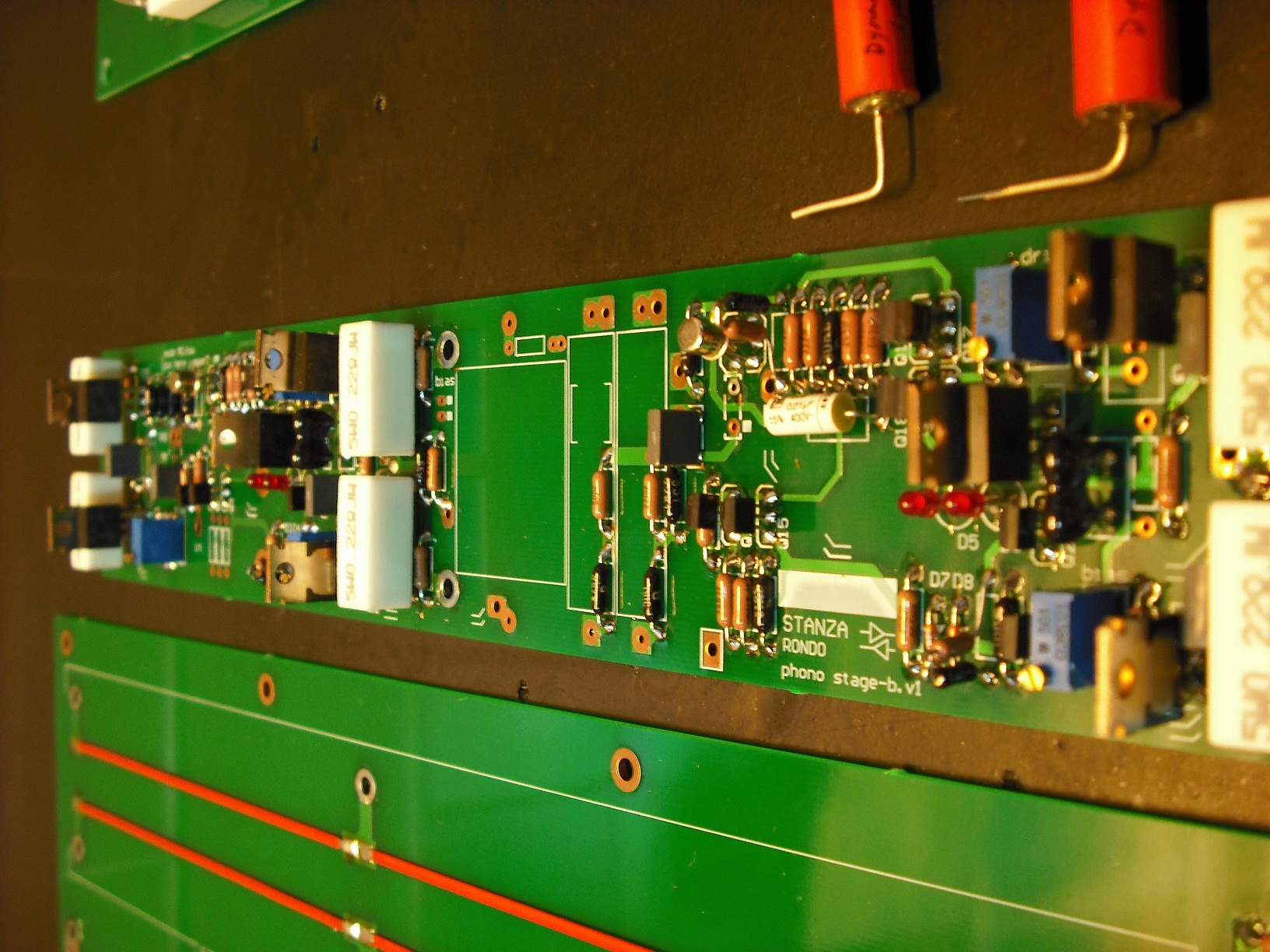

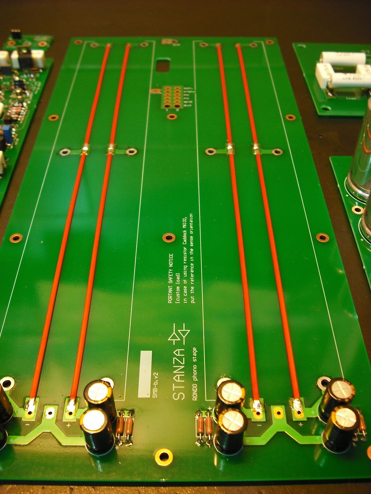

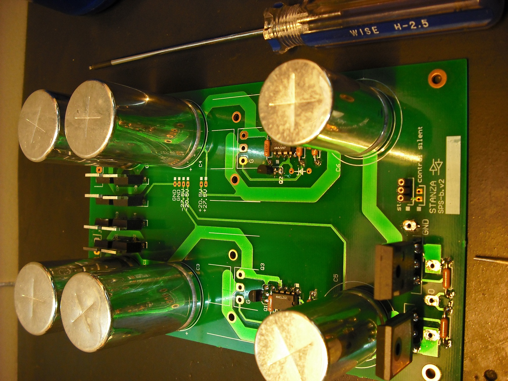

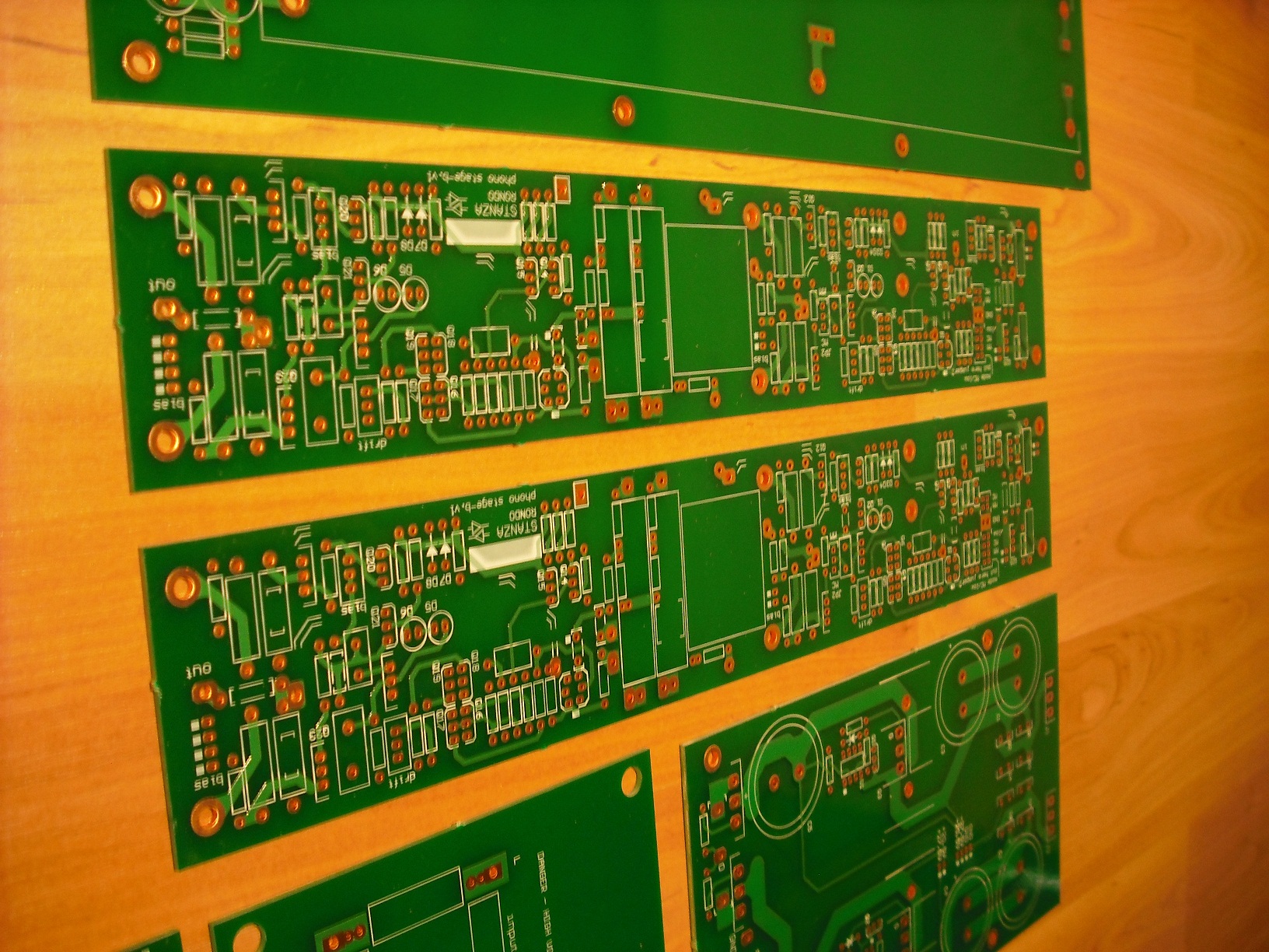

I'm now developing unit riaa (phono stage), if possible I'll put here a topic about my new project.
Here is some pictures of that unit.
-riaa passive correction, with capacitor dynamicap,
-mother board, supply rails with a copper OFC 6N.
-power suplly identical to the preamplifier
-and one module of amplification right or left.
note: the boards do not have all the components and after all the components are placed. is cleaned resin of solder.
