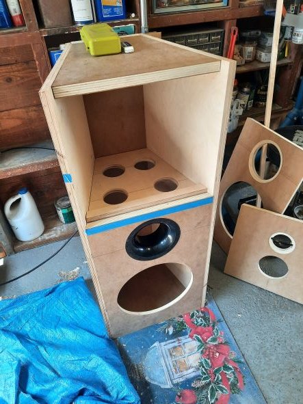

Mark, I have a 6 inch port 11 inches long. That is the low 30's (if I am correct) The woofer free air resonance is 22hz. So is there anything to worry about regarding the zma? regarding the 75cm dimension. I will check but the cabinet is 40 inch high, and the midrange enclosure may reside at 29 inches so maybe that is causing an issue??
True devotees to reflex systems might argue both peaks should be equally high. I'm not one of them. The issue at 130Hz (the midrange enclosure could be at play) could be fixed by placing a sheet of acoustic foam 4-5cm horizontal, between port and woofer, but that's just an educated guess.
i could put the foam on eith of these two locations the bottom level is between woofer and port, the higher level is between port and mid enclosure. Note that port is not shown but you may be able to sneak a peak at the flare attached to the front panel.
