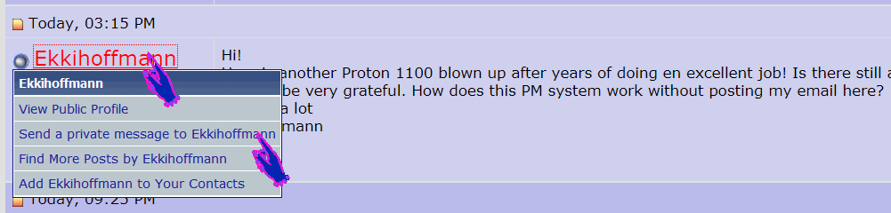

....How does this PM system work without posting my email here?....
Click on the name of the person you want to contact privately. The drop-down menu includes "Send a private message to {person}"
One possible glitch. "New members" are restricted until management sees they are not making trouble/spam. You have been a member for years but only one public post.
