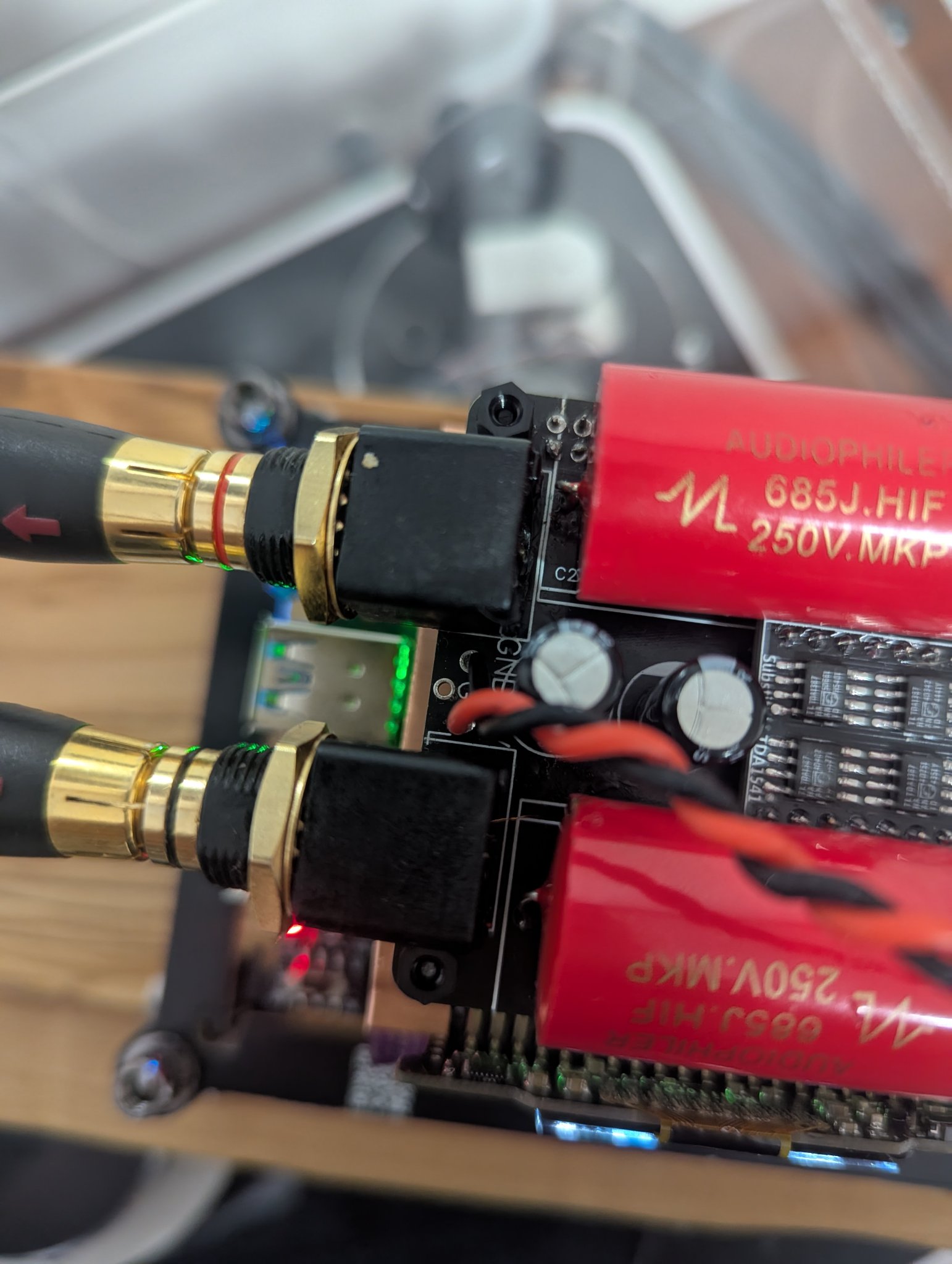

Hello Experts,
Im new to building dac streamer based on Gaby's post.Running on NO sound issue. MonitorPI is showing the streaming info when played from Moodeplayer (photo attached) but no sound is coming out. Not sure if I need to do any code change.
Protodac mounted directly to RPI works fine
Please see details below

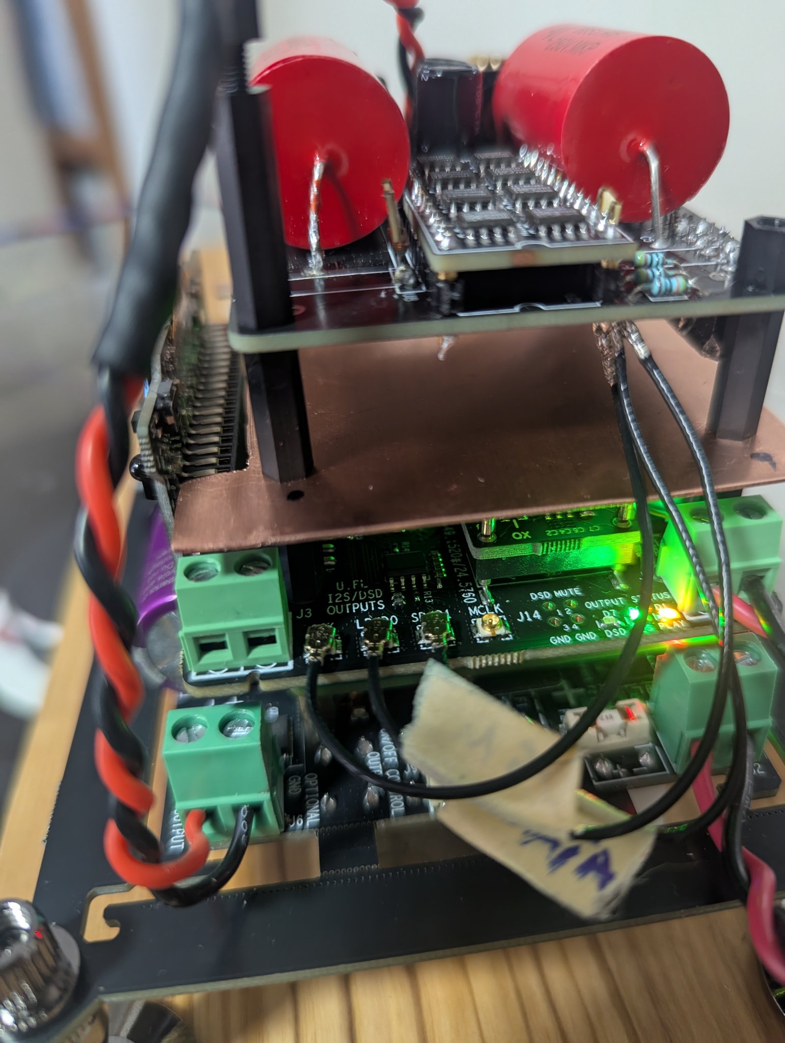

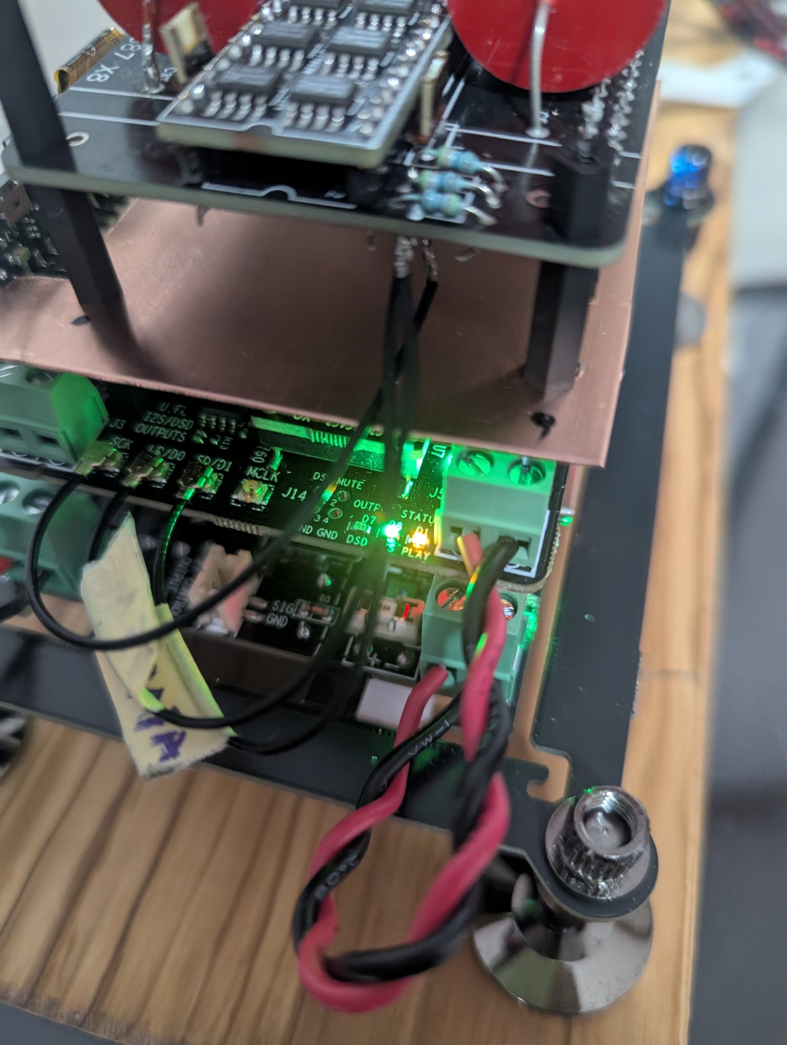

I did the GPIO bypass for Protodac connecting directly to Purepi 5v as Gaby did (13:56min time in video)
- Also soldered the UFL Cables to 3 resistors output - it is 1- WS / 2 - DATA / 3 - BCK (photo attached) for the I2S
I researched the forum found the following post and verified all listed item - they are all correct

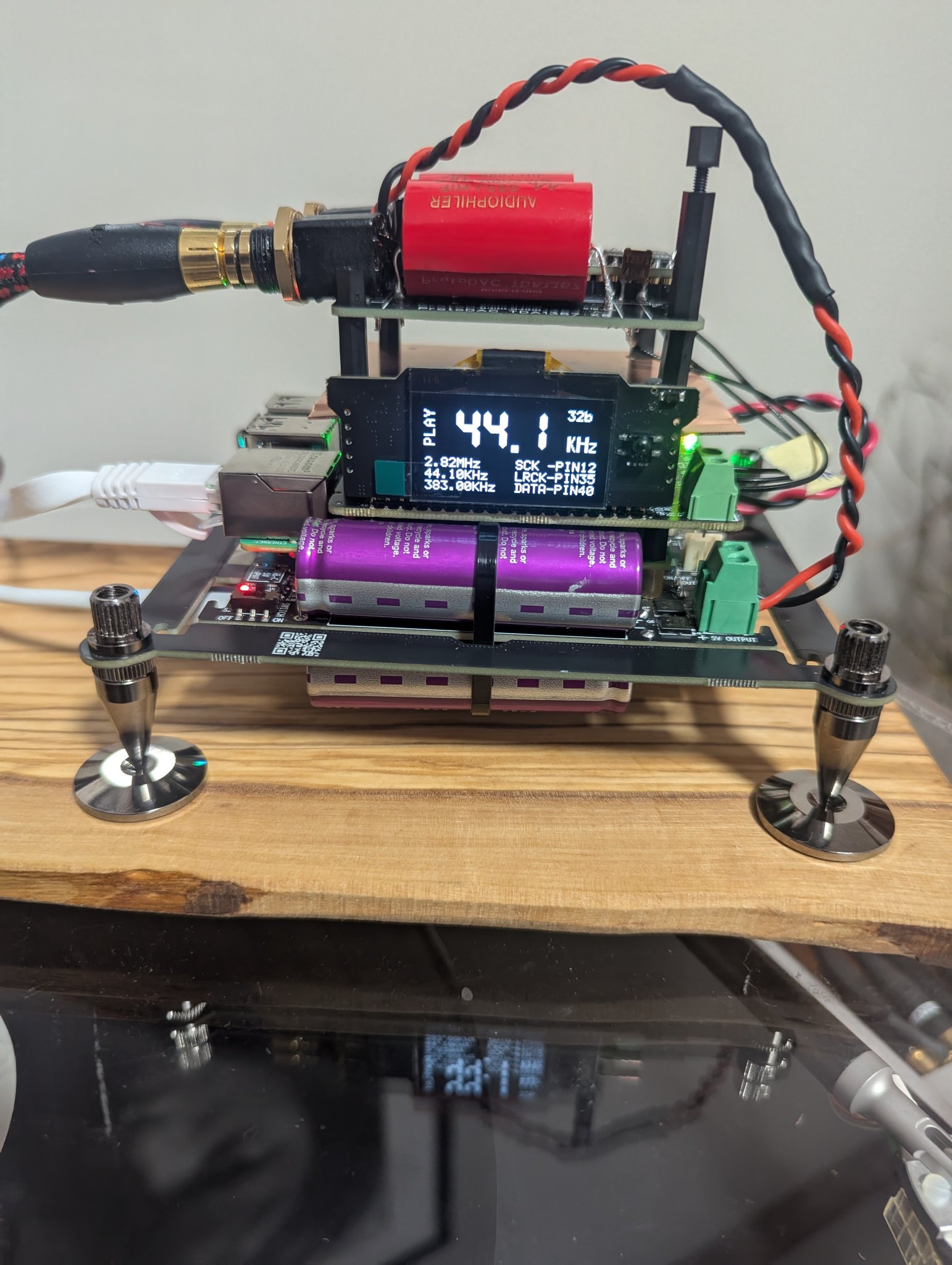

Hello,
I am building a streamer with DAC;
Here is the troubleshooting that I have done so far:
1- I first have installed the Protodac on top of the Raspberry and good sound was comming out of it...
- Raspberry running Ropieee mounted on a StationPi Pro
- FifoPi Q7 mounted on the clean Side
- MonitorPi Pro mounted on the dirty side of the FifoPi Q7
- ProtoDac mounted on the clean side of the FifoPi Q7
- StationPi Pro Raspberry side powered by a 5V linear PS
- Jumper on J9 of the StationPi
- FifoPi Q7 5V by LinearPi + UcConditioner
- FifoPi Q7 3.3V by LinearPi + UcConditioner
- J0F0

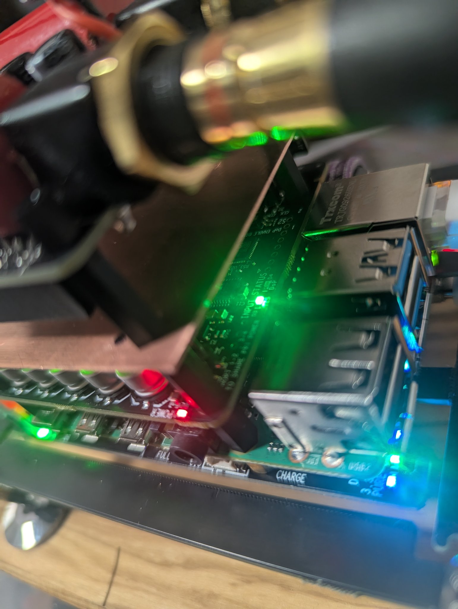

- LED of XO1 or XO2 clock - Light up (photo attached)
- The lights that are on (in the Fifo) are:
-D2 power of course
-D3 I2S format input
Please see attached photo

Do you have an oscilloscope? If so, what is its bandwidth and number of channels? (a scope is the most appropriate piece of test equipment to take a look to figure out where the problem is, right?)
Also, it would be helpful if we could know how much you understand about electronics. Such as, do you understand I2S bus, what the mods you did were supposed to do in a signal flow/processing sense, etc.?
ProtoDacs need 5VDC for the dac section. Your configuration is not one that works plug'n'play. Check the ProtoDac thread (v long now) on the MoOde forum.

Protodac is powered using the 5V connection of the Purepi ...In this configuration Protodac is not connected to the GIPO at all

I do not have an oscilloscope. Also this is my first electronics project....Im a total new to this - trying to learn doing these projects.
Without a scope, you can use Monitor_Pi to check the I2S bus input to FIFO_Pi and then the output of FIFO_Pi. There are two GPIO bus connectors on the component side (top) of FIFO_Pi. The connector closer to the edge of the board, IIRC, is where Monitor_Pi can be plugged in to show what is coming into FIFO_Pi from RPi. The 2nd GPIO connector should also work with Monitor_Pi to show the output of FIFO_Pi.
Have you tried using Monitor_Pi to verify when you have Moode play different sample rate audio files that input and the ouput of FIFO_Pi show the correct sample rate data?
If not, how to do it should be explained in Monitor_Pi manual (this is all from old memory only, so you may want to double check on what I am suggesting).

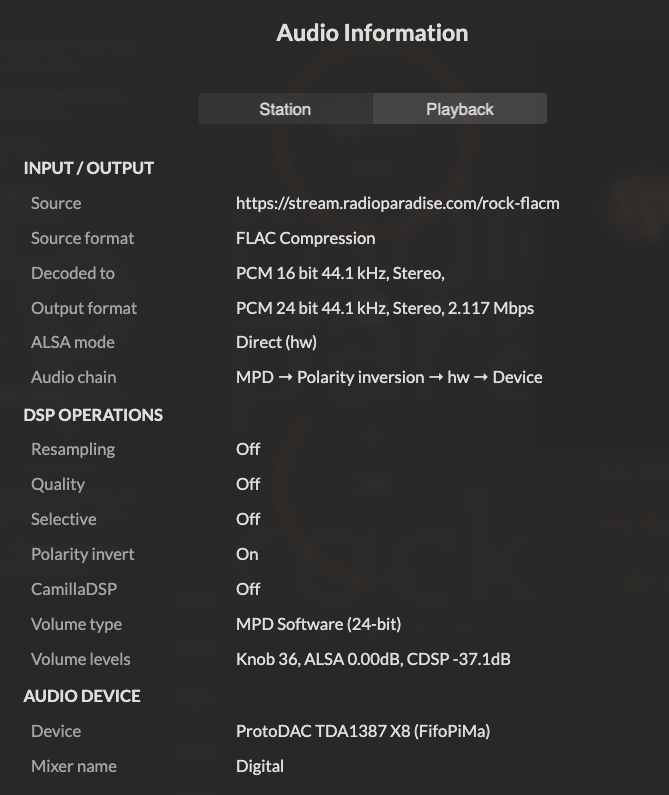

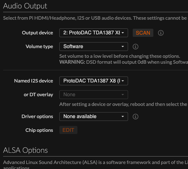

Couple things to try.
1. When a track is playing, Menu > Audio info and note the "Output format" line. It either shows the complete PCM or DSD format being output to the audio device or "Not playing". If it shows "Not playing" then #2.

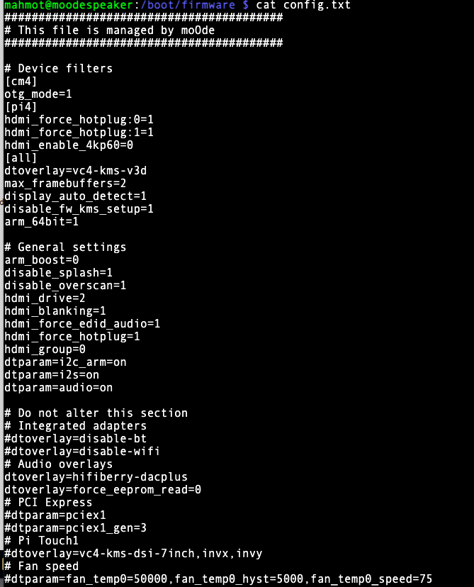

2. Try the passive mode I2S driver since you are using the U.FL outputs which are separate from the GPIO. The passive mode driver is configured when selecting "ProtoDAC TDA1387 X8".
For reference the passive mode I2S driver is "i2s-dac" and the master mode driver is "hifiberry-dacplus". The driver is specified in the file
/boot/firmware/config.txt

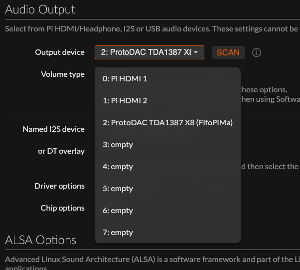

Hi Tim,
If I use "ProtoDAC TDA1387 X8" No Signal show in Monitor Pi but if I use
"ProtoDAC TDA1387 X8 (FifoMa)" Monitor Pi shows the correct playing signal

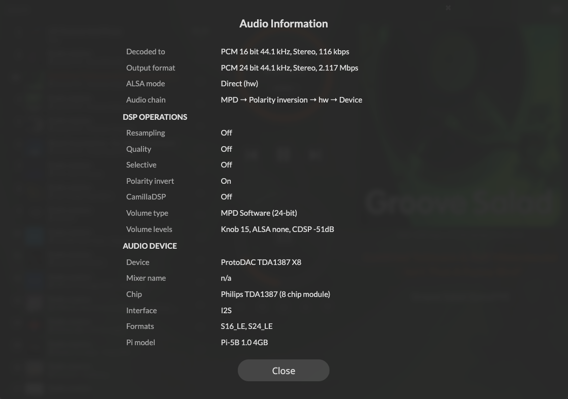

- When a Track is playing the Moode audio Info Show the correct value (see screen shot)
The selection "ProtoDAC TDA1387 x8 (FifoPiMa)" corresponds to the config.txt entries below which matches your screen shot.
The Audio info screen shot shows
"Volume levels" lists "ALSA 00.0dB" and "Mixer name" lists "Digital" but the ProtoDAC has no on-chip hardware volume controller (mixer) so these capabilities must be coming from the hifiberry-dacplus driver but its expecting the DAC board to have a hardware mixer. I've never tested a FifoPiMa so I'm not really sure what the exact config should be.

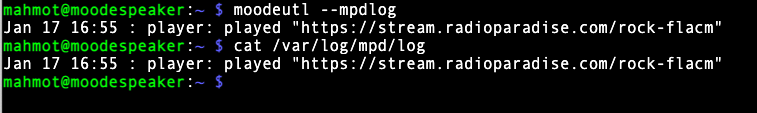

Play a track and check the MPD log for errors regarding the mixer named "Digital"
Here's an Audio info screen shot from one of my ProtoDAC's that sits on top of a Kali Reclocker which is passive mode I2S. Note "ALSA none" and "Mixer name n/a"
Here's a post from our Forum regarding ProtoDAC and FifoPiMa. You might want to request an account and PM that user to see how he configured things.
https://moodeaudio.org/forum/showthread.php?tid=5531&pid=51401#pid51401
Code:
# Audio overlays
dtoverlay=hifiberry-dacplus
dtoverlay=force_eeprom_read=0
Code:
moodeutl --mpdlog
cat /var/log/mpd/log

Im trying to capture the log now....keep you posted

Tim,
Here is the debug log for startup and Mpd log screen shot (no error on mpd that I can see)

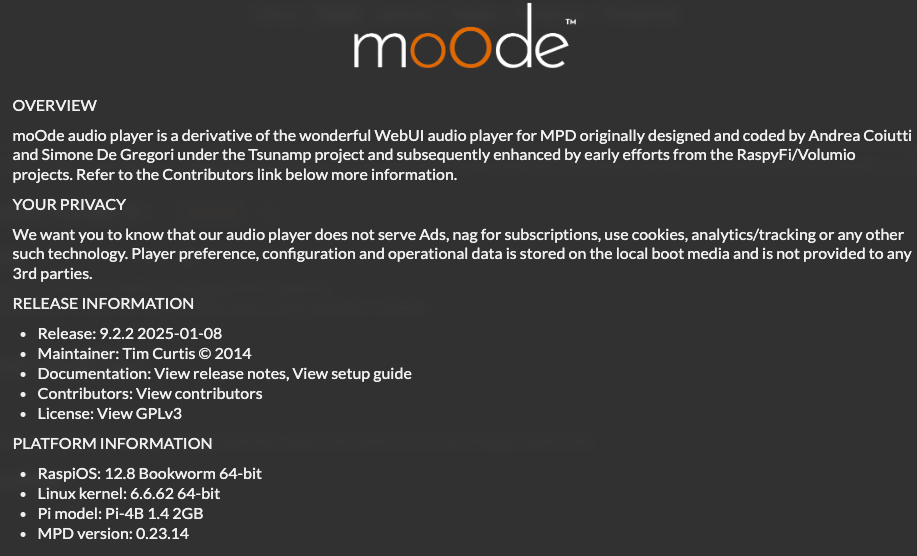

20250117 165616 worker: RPi model: Pi-4B 1.4 2GB
20250117 165616 worker: moOde release: 9.2.2 2025-01-08
20250117 165616 worker: RaspiOS: 12.8 Bookworm 64-bit
20250117 165616 worker: Linux Kernel: 6.6.62 64-bit
20250117 165616 worker: MPD version: 0.23.14
Startup with Debug turned on:

20250117 165813 worker: -- ALSA debug
20250117 165813 worker: Cards: 0:vc4hdmi0 1:vc4hdmi1 2:sndrpihifiberry 3:empty
20250117 165813 worker: 4:empty 5:empty 6:empty 7:empty
20250117 165813 worker: Mixers: 0:none 1:none 2🙁Digital) 3:none
20250117 165813 worker: 4:none 5:none 6:none 7:none
20250117 165813 worker: -- Audio configuration
20250117 165813 worker: Audio device: 2😛rotoDAC TDA1387 X8 (FifoPiMa)
20250117 165813 worker: ALSA card: has not been reassigned
20250117 165813 worker: MPD config: update not needed
20250117 165813 worker: ALSA output: I2S
20250117 165813 worker: ALSA mode: Direct (hw)
20250117 165813 worker: ALSA mixer: Digital
20250117 165813 worker: ALSA volume: 100% (0.00dB)
20250117 165813 worker: ALSA maxvol: 100%
20250117 165813 worker: ALSA loopback: off
20250117 165813 worker: MPD mixer Software
20250117 165814 worker: Audio formats: S16_LE, S24_LE, S32_LE
20250117 165814 worker: CamillaDSP: off
20250117 165814 worker: CDSP volume: -37.1dB
20250117 165814 worker: CDSP volrange: 60dB
20250117 165814 worker: --
20250117 165814 worker: -- MPD startup
20250117 165814 DEBUG: MPD|ALSA devnum: invpolarity|i2s
20250117 165814 worker: MPD service: started
20250117 165814 worker: MPD port 6600: accepting connections
20250117 165814 worker: MPD ALSA Default: on
20250117 165814 worker: MPD ALSA Bluetooth: off
20250117 165814 worker: MPD HTTP Server: off
20250117 165814 worker: MPD volume: 49
20250117 165814 worker: Saved MPD vol: -1
20250117 165814 worker: Saved SRC vol: 0
20250117 165814 worker: MPD crossfade: off
20250117 165814 worker: MPD ignore CUE: no
20250117 165814 worker: MPD CDSP volsync: off
20250117 165814 worker: -- Music sources
20250117 165815 worker: USB drive: usb-drive (vfat)
20250117 165815 worker: NVMe drives: none
20250117 165815 worker: SATA drives: none
20250117 165815 worker: NAS sources: none
20250117 165815 worker: --
20250117 165815 worker: -- Feature availability
20250117 165815 worker: Input select: available, Source: MPD, Output: ProtoDAC TDA1387 X8 (FifoPiMa)
20250117 165815 worker: Bluetooth: available, PIN: None, ALSA/CDSP maxvol: 100%/0dB, ALSA outmode: Standard
20250117 165815 DEBUG: startAirPlay(): (/usr/bin/shairport-sync -v -a "Moodespeaker AirPlay" -- -d _audioout > /var/log/moode_shairport-sync.log 2>&1 &)
20250117 165815 worker: AirPlay: started
20250117 165815 DEBUG: startSpotify(): (librespot --name "Moodespeaker Spotify" --bitrate 320 --format S16 --mixer softvol --initial-volume 5 --volume-ctrl log --volume-range 60 --cache /var/local/www/spotify_cache --disable-audio-cache --backend alsa --device "_audioout" --onevent /var/local/www/commandw/spotevent.sh -v > /var/log/moode_librespot.log 2>&1 &)
20250117 165815 worker: Spotify Connect: started
20250117 165815 DEBUG: startDeezer(): (pleezer --name "Moodespeaker Deezer" --device-type "web" --device "ALSA|_audioout||S16" --initial-volume "10" --secrets-file "/etc/deezer/deezer.toml" --hook /var/local/www/commandw/deezevent.sh -v > /var/log/moode_pleezer.log 2>&1 &)
20250117 165815 worker: Deezer Connect: started
20250117 165815 worker: Squeezelite: available
20250117 165815 worker: UPnP client: started
20250117 165815 worker: Plexamp: not installed, ALSA maxvol: 100%
20250117 165815 worker: RoonBridge: not installed
20250117 165815 worker: Multiroom: available
20250117 165815 worker: GPIO buttons: available
20250117 165815 worker: Stream recorder: n/a
20250117 165815 worker: -- Security
20250117 165815 worker: Web SSH server: on
20250117 165815 worker: XSS detection: off
20250117 165815 worker: HTTPS mode: available
20250117 165815 worker: -- Peripherals
20250117 165818 worker: Local display: off
20250117 165818 worker: Chromium ver: 126.0.6478.164-rpt1
20250117 165818 worker: Chromium cfg: directory ok
20250117 165818 worker: Screen blank 600
20250117 165818 worker: On-screen kbd: off
20250117 165818 worker: Disable GPU: off
20250117 165818 worker: HDMI orient: landscape
20250117 165818 worker: HDMI 4K 60Hz: off
20250117 165818 worker: DSI scn type: none
20250117 165818 worker: DSI port: 1
20250117 165818 worker: DSI brightness: 25
20250117 165818 worker: DSI rotate: 0
20250117 165818 worker: Rotary encoder: off
20250117 165818 worker: USB volume knob: off
20250117 165818 worker: LCD updater: off
20250117 165818 worker: --
20250117 165818 worker: -- Miscellaneous
20250117 165818 worker: Software update: Automatic check on
20250117 165818 worker: Software update: Unable to check, No local IP address or Hotspot is on
20250117 165818 worker: Auto-CoverView: on
20250117 165818 worker: CoverView timeout: Never
20250117 165818 worker: Auto-shuffle: off
20250117 165818 worker: Auto-play: on, via playid 10771
20250117 165818 worker: Maintenance task: 360 mins
20250117 165818 worker: Current view: reset to Playback
20250117 165818 worker: Active flags: all false
20250117 165818 worker: Reset flags: skipped
20250117 165818 worker: Session check: ok
20250117 165818 worker: -- Startup complete
20250117 165818 worker: Mount monitor: started
20250117 165818 worker: Radio monitor: off
20250117 165818 worker: Watchdog monitor: started
20250117 165818 worker: Responsiveness: Default
20250117 165818 DEBUG: Sleep intervals: worker=3, waitworker=1, watchdog=6, mountmon=30, mpdmon=6, gpiobuttons=1
20250117 165818 worker: Ready
20250117 165819 DEBUG: chkVariables(): Excluded key: path
Have you tried disconnecting the U.FL cables and connect the ProtoDAC to the FifoPiMa GPIO header?
Maybe there is an I2C GPIO thats needs to be in play for this configuration.
I'll try that next - need to desolder the UFL cables first I think. Will just disconnect from the FIFO PI work?
Ok, cool.
You might want to ask IanCanada if there is another GPIO thats needed when using the U.FL cables with fifopima.
- Digital Line Level
- ProtoDAC with Ian Canada Purepi , FifoPiMa , MonitorPi , RPI4B with Moodplayer - NO SOUND
