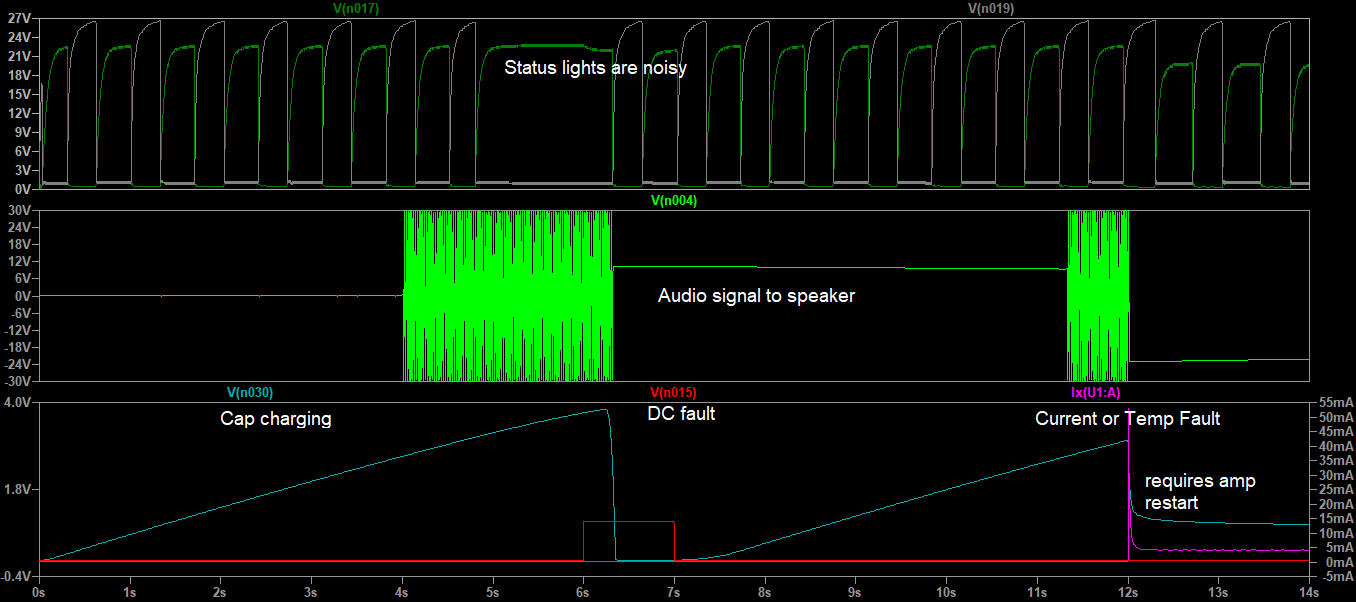

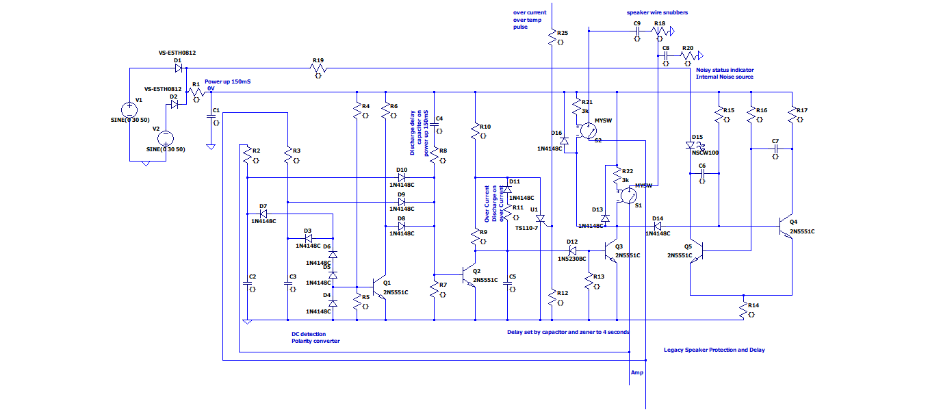

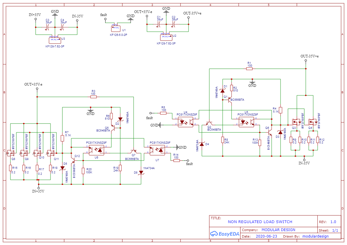

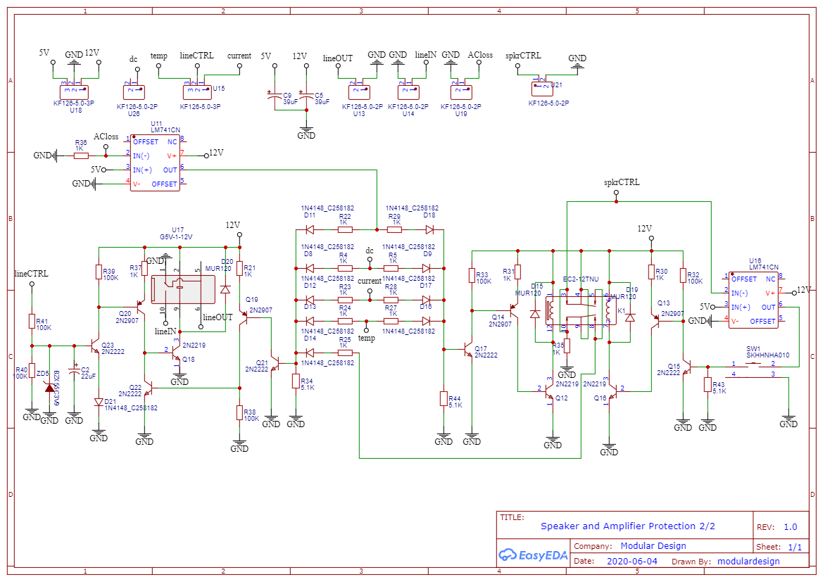

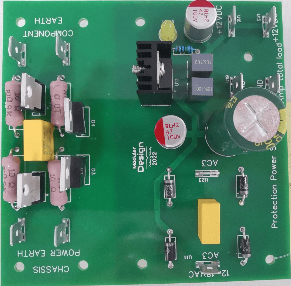

The circuit https://www.diyaudio.com/community/threads/protection.391839/post-7428567 demonstrates exceptional performance and serves as an ideal complement to a fast-blow 6.3A fuse in this specific application, whichever is triggered first. Its effectiveness in safeguarding your output devices is highly probable. Unlike a fuse, which might not offer comprehensive protection in all scenarios due to its limited overdrive-only rating, this circuit is meticulously engineered to comprehensively address potential issues. False activations are a rarity within this setup. Any activation that does occur would likely play a pivotal role in upholding the integrity of your output devices. This dual-layer protection strategy is anticipated to operate exceedingly well. It's important to note that this analysis assumes the presence of two output transistors per side, within the +/-50VDC ±10% rails.
"Likely play...".False activations are a rarity within this setup. Any activation that does occur would likely play a pivotal role in upholding the integrity of your output devices. This dual-layer protection strategy is anticipated to operate exceedingly well
"anticipated to operate exceedingly well."
Am I to infer that all you have done is simulated this design, and that you have not actually built and tested this protection circuit for real?
If that is the case, then how on earth can you honestly expect anyone to trust the protection of their speakers and system to some undocumented over-complicated unproven circuit off the internet?
Ant.

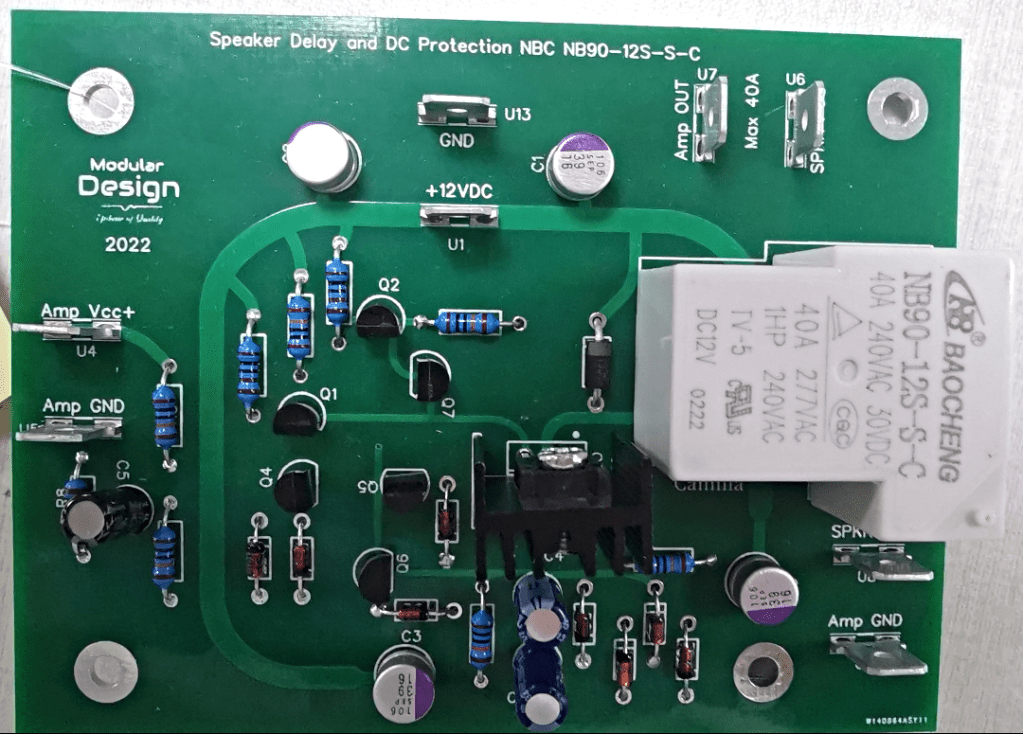

Someone could built it and test it - and then decide if he wants to use it. I’ve built and tested protection systems as complicated as this. Just the “DC detect, and open the relay” parts are quite simple and reliable.
This is an amp with a comprehensive protection system. It was used to test the protection system, prior to implementing it in a much larger amp (still in development). Only a small portion of it is “amplifier”. Doesn’t need all of it working, to protect speakers from DC. In addition, it has power supply sequencing and fault detect, fan control, and 4 stages of temperature protection (Different features kick in as it gets hotter, ultimately shutting down entirely at 90C).
Thanks for your interest. Some of my ideas are revolutionary and sometimes abstract for purposes of reasoning and generalization , some are more aimed at industry experts so that when you buy an audio product from your favorite brand, it may have those modification built in for a better experience for you. Not all ideas are good, time also does play a role in evaluating whether it is a good idea. Check out this video"Likely play...".
Ant.
