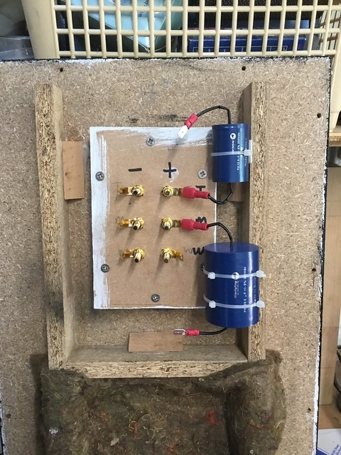

I am using the Morel EM1308, very similar to the CAM558 (round faceplate version of the MDM55 iirc) and have a 39uF protection cap on it, if that helps. I am using one as I have an active crossover so the power amp is directly connected to the driver. This give me a 1st order roll off at approx 500hz. Obviously this is in place when taking measurements so any active components include this roll off i.e. to get a LR2 roll off I just add another 1st order high pass filter.
For completeness I am using it with a Morel ET448 tweeter and have a 12uF protection capacitor on that. This equates to around 2200hz 1st order roll off.
I am crossing the EM1308 to a SB WO24P-4 at around 700hz and the ET448 at around 3500hz. I am still optimising but seems to be working fairly well and the Morel mid sounds very natural, great for acoustic instruments and human voice especially female.
I chose ClarityCap PX as a good compromise on price.
