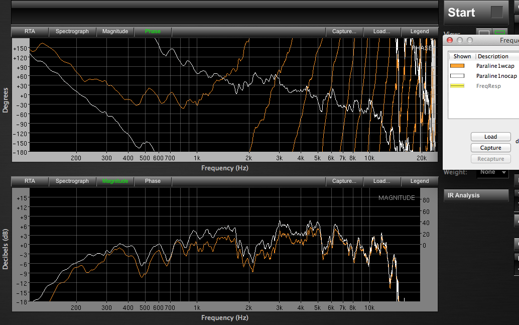

I (finally) pulled the series capacitors out of my cabinets several years ago after seeing (and hearing) how much they messed up phase and frequency response.
The graphs below show what an 18 mfd series cap does to a 16 ohm horn driver response- nothing like one would expect, and would not afford any protection other than from DC.

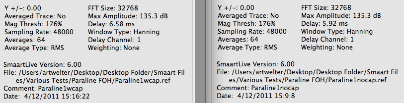

I don't know about the response, maybe the impedance of the driver on the horn would tell the tale, but I think something went wrong with this relative phase measurement.
Yes, for some reason the delay time was changed.
IIRC, I left the cabinet and the mic in exactly the same position.
Although the capacitor should induce a phase lag, normally I'd think the added delay time (no cap 5.92 ms, with cap 6.58 ms) would have flattened out the phase response, but just put it behind by 90 degrees.
Smaart's "Auto sm" will calculate the correct time delay, but in this case it looks like it was somehow mistakenly changed to an incorrect value.
I have had some screen lock ups, the delay time probably reverted to a previous test after rebooting the program, and I did not check the time of the first test after rebooting.
At any rate, the frequency response differences are correct, and show up octaves above what I'd have expected.
