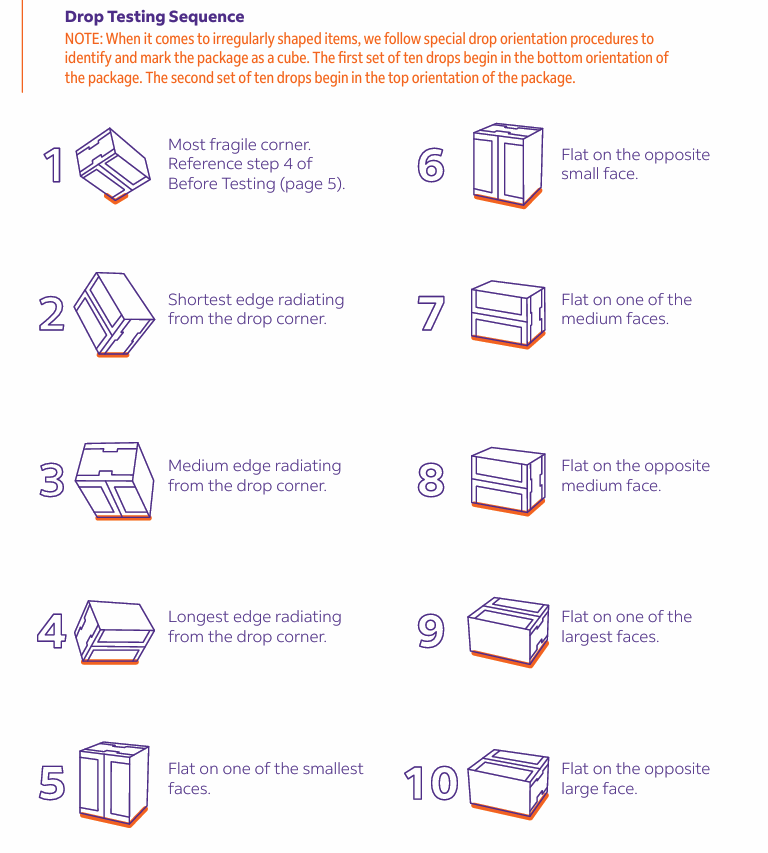

Preferably more than oneeverything needs to be packaged to survive a 2m to 2.5m drop on concrete
https://www.fedex.com/content/dam/fedex/us-united-states/services/PKG_Testing_Under150Lbs.pdf
"FedEx package testing procedures are based on data from shipping studies within our networks, industry procedures, international testing standards, and development methodology and practice to provide reliable packaging tests.
Impact Tests Using Free Fall Drop Tester
Drop Heights: 18-30”
Drop Count: 10-20 individual drops
Bridge Impact for Elongated Packages
Drop Heights: 30” to package surface
Drop Count: 1 drop in center of package
Equipment Used: Wooden Hazard Box
Vibration Test Using Rotary Table
200 CPM (cycles per minute)
Length of time: 60 min
Vibration Test Using Random Vertical Table
Frequency varies by profile used
Length of time: 45-90 min"
For packages under 75lbs, we use a 30 inch drop height. For packages between 76-100lbs, we use a 24 inch drop height. For packages between 101-150lbs we use an 18 inch drop height

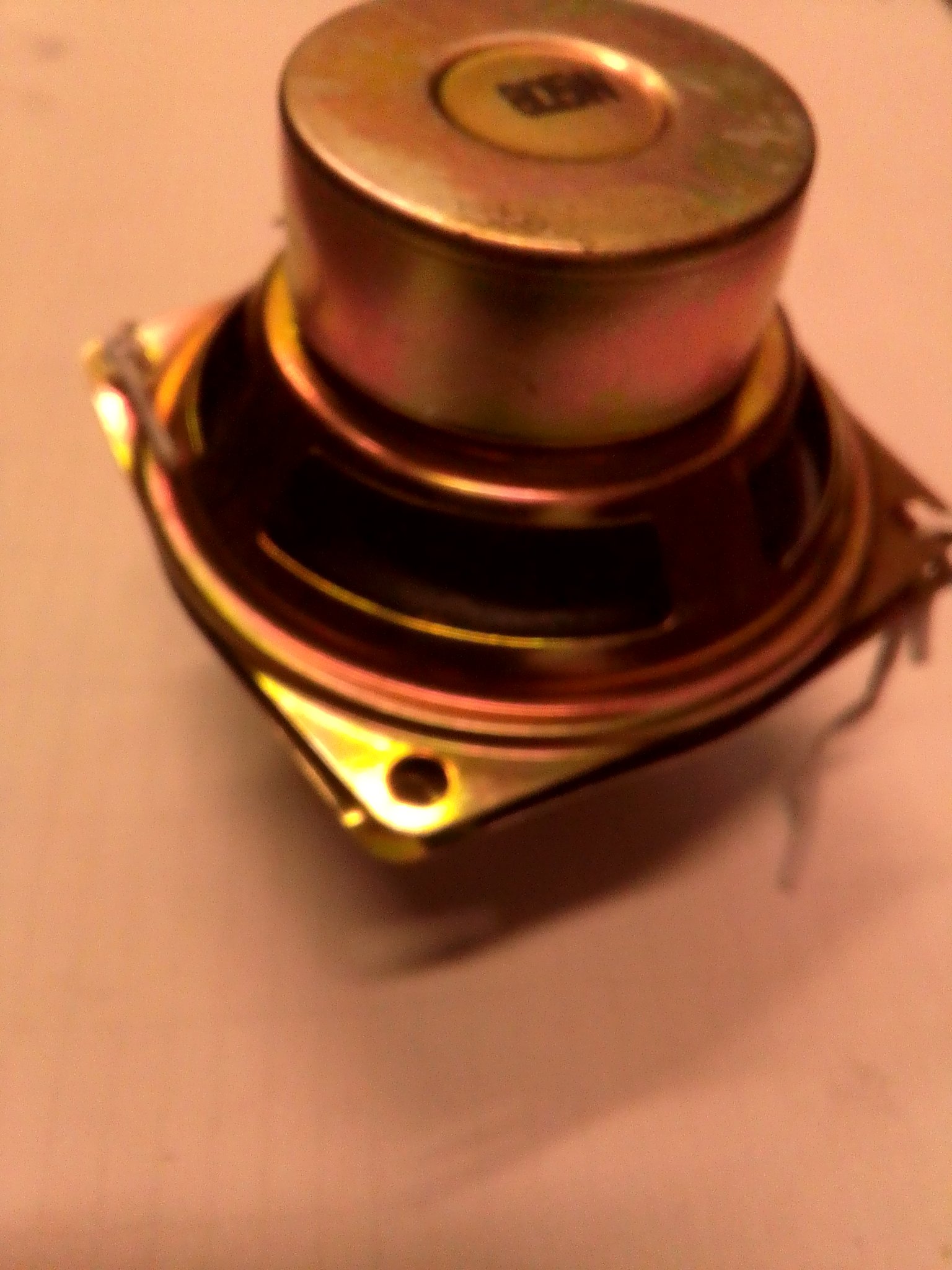

It's not only heavy stuff, today I received some replacement dust caps, 6 were ok, 6 have dents. There's something ironic about getting a replacement dust caps, with a dent. It's possible that the bike peddles I ordered at the same time did the damage. Fortunately the speaker drivers were bound together with bread wrapper ties.
