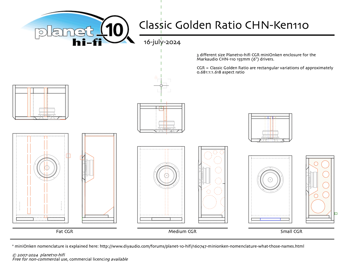

From what i have experienced, your target of making something a long bthe lines the BC1, and given this is your first diy build, and the recommendation is always to not go overboard on the first one, i’d piut Markaudio CHN-110 in the biggest reflex box they support. Scott has a few sketches on the MA site.
Or maybe something a bit more exoctic like a Classic Golden Ratio box.

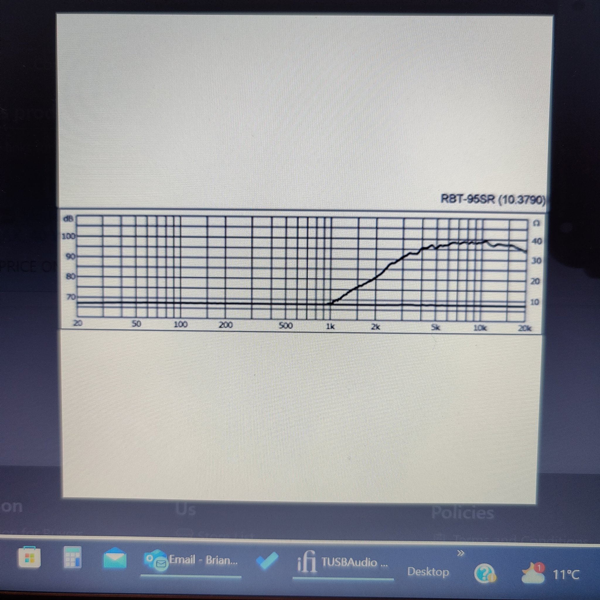

Given that Rutcho's rework addressed the area where the LF section rolls - off and the HF picks up, it is clear from his plots the response around the crossover wasn't very clean. For this reason, the Monacor looked considerably better than B&W's Tweeter.
So current thinking is to build an enclosure to house both the B&W mid range unit and the Monacor. However, with the CM7 terminal plate + port + LF portion of the CM7's crossover, this could provide the opportunity to fit a driver to cater for frequencies below the B&W Midrange driver.
Building an enclosure with the same footprint as the BC1, but benefiting from increasing the height to that of the BC1, inclusive of their trollies, doesn't seem too ambitious - with plenty of research and the kind of expert knowledge on this forum, will greatly reduce the potential for disaster - would it not?
In adopting this approach, given I am almost there wrt components, It could considerably shorten timescales, with the exception of how best to employ the Low frequency element of the CM7 and a suitable woofer - if not B&W's own from a pucker CM7.

However, the recommended crossover frequency for the Monacor is 5khz, the same as B&W Tweeter. But its rating is 40W continuous, which sways the argument. I could not believe how dirty the B&W tweeter's leading edge was, and Rutcho's modification addresses that nicely. However, the RBT - 95SR is as clean as a whistle, which will make for further improvements in the transition area.
It remains a two element loudspeaker, albeit with the extension below midrange being an option with the CD7 crossover. However, with regard to the drivers - I am unwilling to pay for second hand units on eBay, where what kind of life/abuse is unknown to me - for silly money in some instances. The number of damaged Nautilus' is staggering, so it doesn't inspire confidence in those that appear ok!
£84 for a new Monacor is a good base - line. I will have to source woofer/mid-range and am open to suggestions. Provisionally, I could go for a second hand unit, which coupled with new tweeters will give me more confidence in what it all sounds like, but ultimately they too will be new units. That way, there is only one variable - assuming everything else is close. I have absolutely no worries about the modified 601 S3 crossovers. So setting these elements up first, before any experimentation with the lower register driver, should allow for better understanding how the third driver dovetails into all this.
