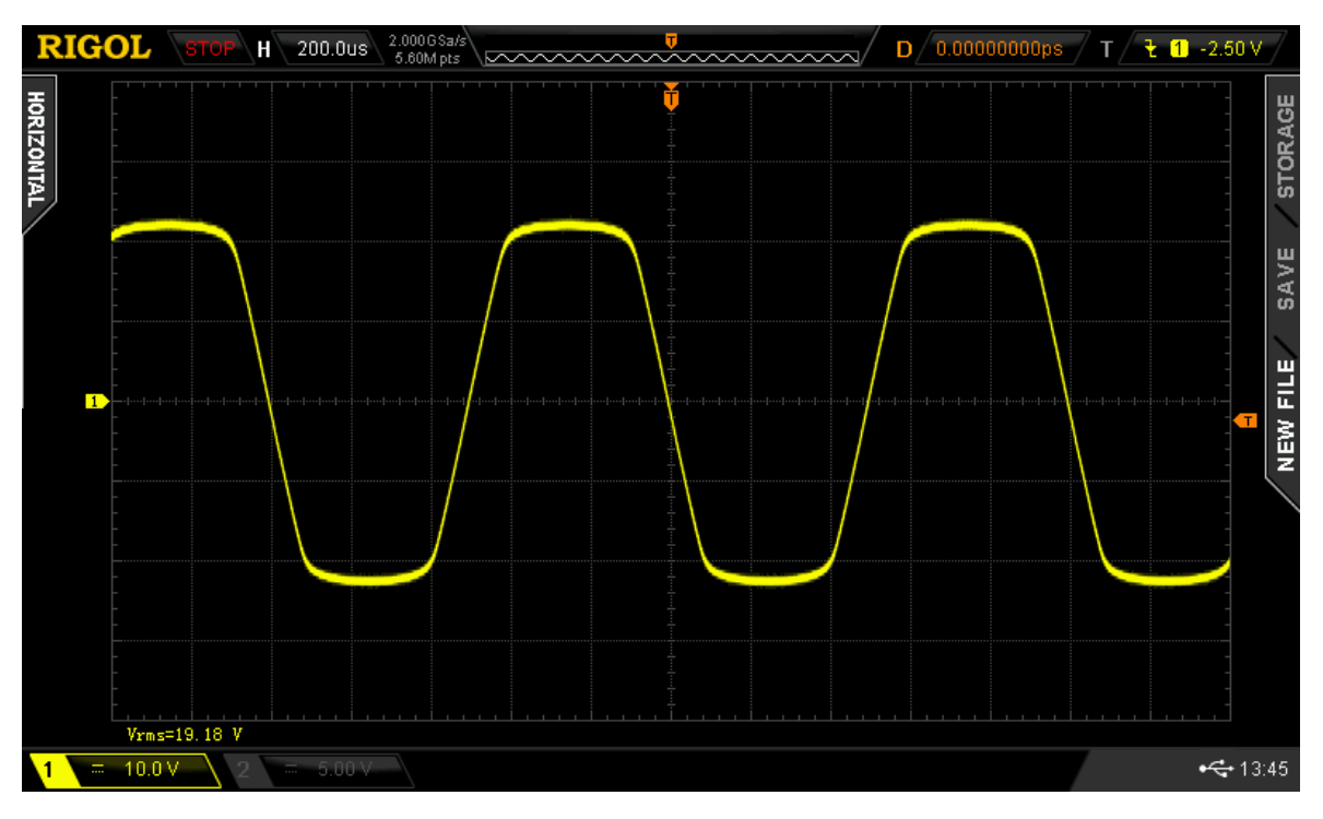

my mixer outputs over 9V. I'm now looking into a compressor/limiter since that is how it is handled in recording studios I think.

no pa or dj here. I have lots of equipment including analog synths. Everything connects to my mixer. The mixer would need to connect the the amp. I need some type of solution to prevent overvoltage going to the amp. This is common in larger recording studios. Not sure about 'hifi' but i'm about keeping my analog signals pure analog, including my analog synths and analog drum machine. I"m willing to build or buy the last piece of the puzzle to get that analog from my synth to the speakers without damaging anything. My ears are not as good as they used to be since i've seen many live shows which led to my interest in building analog synths. I don't trust my hearing to tell if the speakers are clipping. I realize this is not a popular setup and frowned up by 'hifi' enthusiasts at times. Someone even says it is the 'dumbest idea in hifi in DECADES', and I am truly proud of that accomplishment considering how long the hobby has been around.
Adjust gain of the mixers output stage internally and reduce 9V output levels to normal line levels. Solved. At the root. Without adding again extra stuff but by simply taking away the possibility/risk of amplifier damage. This is a 100% remedy for the issue as mentioned in the thread title. You don’t need to protect against what can not occur and your precious analog signals will not be altered/manipulated just like you desire.
However maximum allowable volume is a different matter with regards to loudspeakers and ears. This is not the subject but it is related. Even with for instance 2V line levels that can not damage the power amplifier. We don’t know if your amplifiers are 1W or 1 kW. We used to say the limit was when ears started to bleed but one is better careful as one only gets a set of ears once. If you get assistance from someone with good hearing once you can determine the maximum allowable volume and note that down. Keep it 20% lower and all is good.
Bob Cordell's soft-clamp circuit from his first book (pp. 368-9), might be one possibility. It's potentiometer adjustable, you can dial the "output voltage must never exceed ±X" setting to whatever voltage X you like. The soft clamp action makes a smoother and more rounded transition zone between not-clamped-at-all and the clamping plateau. Here it is, clamping the top of a sinewave whose amplitude is far too great. Does it increase distortion when the signal voltage peaks are a few hundred millivolts below X volts? Yes it sure does. That's what rounded corners give you.

@Mark Johnson wow, I think that is it, thanks! My biggest concern was sending the square into the amp. I would like to implement a peak voltage detector as well, but am keeping that separate for now to keep it simple.
For the peak detector, the closest design I've found to my peak detector is this one which uses op-amps but the ones built into a PIC. I"m using an STM32F373 which also has op-amps, but I was not going to use 64 leds... I have a bluetooth PCB/module done which is sending telemetry data to an iPad or web browser. I can then send all this to the iPad on top of my amp, like McIntosh does with its large displays.

Bob Cordell calls his soft-limiter circuit "Klever Klipper" and it's included in his Power Amp book (1st and 2nd editions). I don't believe he included it in his second book about Audio Circuits and Systems.
You and your circuit design team might decide to modify Bob's design a little bit, to work within the environment of a preamp instead of a power amp.

@roboDNA - We need to differentiate what I'd do personally (what I recommend), and what I offered as a solution to meet your stated requirements.
What I recommend is:
If you must have 'something' then my proposed solution to meet your goal (which is easy and allows flexibility should you later decide that this really may not be what you want) is:
You've got some unique requirements, IMO. My preference (and it is just a preference) is that the signal remain unclipped / unclamped. Prevention via attenuation could do that for you with what I'd consider little effort. That's why if I had to meet your goals with your gear, it's the route I'd most likely choose vs. building another circuit.
After re-reading a few of your posts, it seems like not only do you never want the output voltage of the pre-amp to exceed 3V, but that you want to be able to actively adjust it such that you run to nearly 3V at dynamic peaks for certain passages / music, thus why you may want some visual indicator. Still not completely sure... but most importantly ... have fun with it. Designing / incorporating something to meet your own personal need and succeeding will be super-cool, IMO.
All sorts of solutions are out there. You can now experiment and see what works best for your situation. Let us know. I for one, would enjoy seeing a 'Klever Klipper' in use for a pre-amp just as a curiosity. It works marvelously (why would it not) for the "gain clone" amps for which Mr. Cordell was kind enough to share some design options. Mark J then offered boards a group buy some time ago, if I recall.

An old post by forum member @Lee Knatta may be illuminating:
Knatta's circuit is noninverting and doesn't include any opamps. If you like, you can adapt his circuit idea to use different DC power supplies instead of +100V and -100V. You can also implement different clamping levels instead of relying upon two 4.7V zener diodes.
Here is how I implemented it (image below)
The main idea behind this circuit is less soft clipping, but to protect the amplifier input from gross over-voltage events like ESD, mains or loudspeaker level.
The diodes in reverse bias add some distortion due to variable capacitance, but the distortion is not too terrible.
