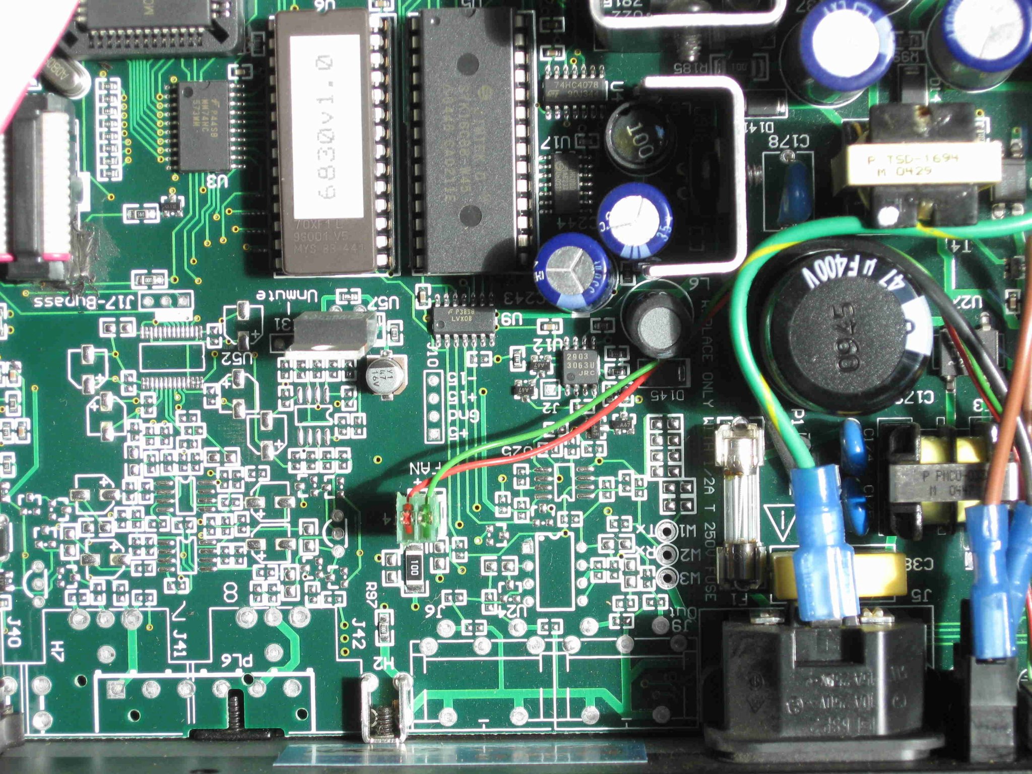

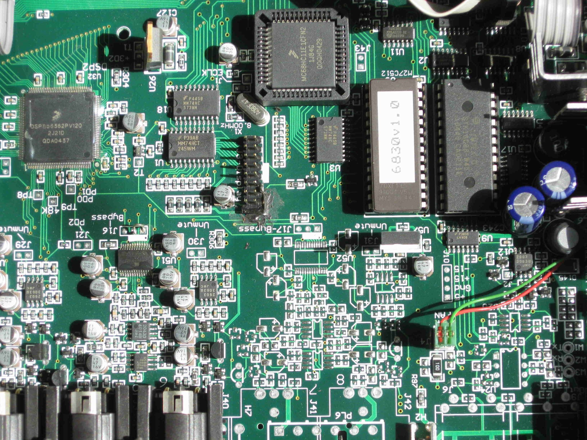

Take two...

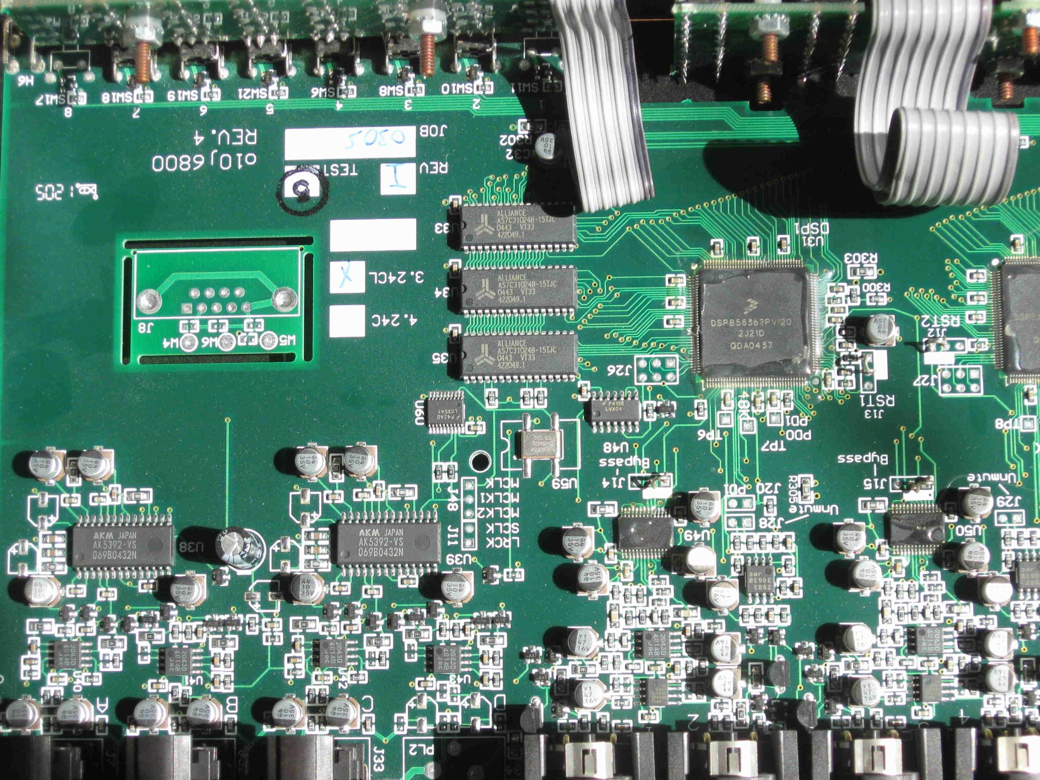

It appears this same circuit board is also used for the model 4.24C, where the one empty input XLR location, and the two empty output XLR locations would be populated. There is place for two DIN-5 jacks, used on th 4.24C for MIDI. No trace of provision for digital I/O unfortunately...
U59's markings are extremely small and hard to read. with the stereo microscope I could see:
CTS5-CB3
12M28800
(dot)04373C3
I suppose it's 12.288 MHz.
for voltage readings I'll have to find an appropriate set of probes so that I don't blow my unit up.
U49,50 and 51 are the dual D/A for the outputs, AKM AK4396

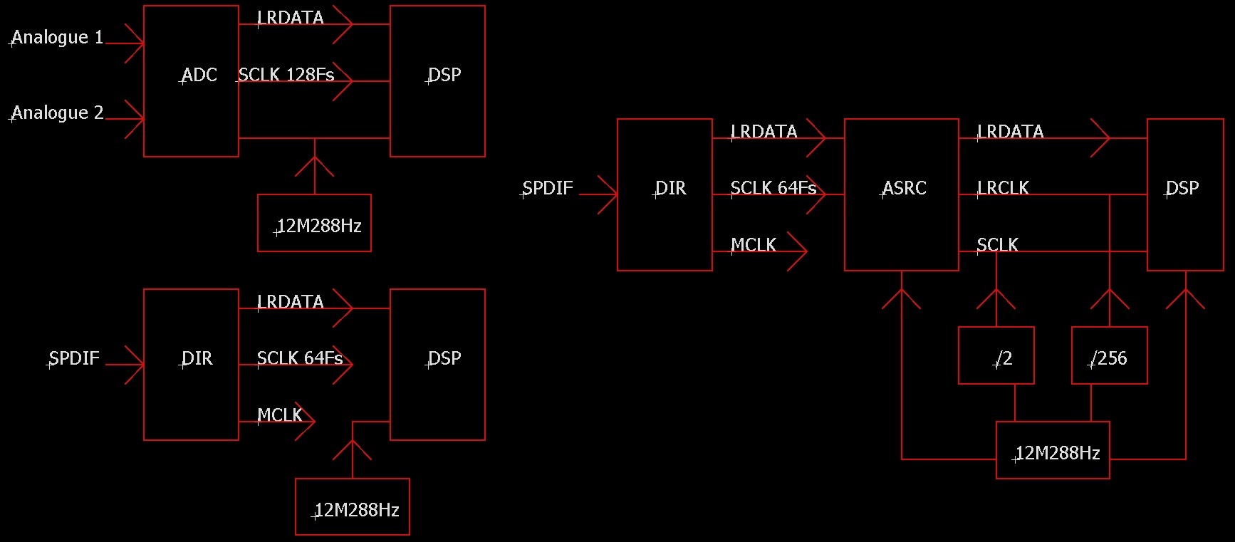

Why two SPDIF receivers? Do you mean one SPDIF receiver and one transmitter?
You have two 2-channel ADC's hence the need for two SPDIF receivers. The SPDIF datastream has its own clock domain as does the 3.24. The SPDIF receiver also puts out SCLK at 64Fs while the 3.24 expects 128Fs. The ASRC bridges the two.

I'd like to understand the diagrams you've drawn... tell me if I'm off.

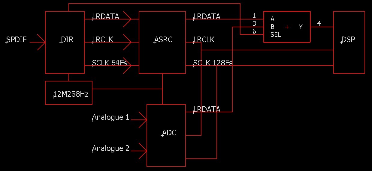

first block (top left) is the "natural" state of the Preotea?
second block (bottom left) would be first step for digital input to the Protea. Incomplete because SCLK is 64Fs ?
third block would be the complete circuit... ASRC would translate between SPDIF's 64Fs and DSP's 128Fs?
What are those /2 and /256 blocks? Will I have to implement that?
Another consideration I'd have is to be able to keep the analog inputs useable (not simultaneously but switchable). would that be at all possible?
The ASRC is slaved to the onboard master clock so, data aside, all clocks on the output side of the ASRC are inputs. LRCLK is the sample rate Fs which is the 12M288Hz clock divided by 256. SCLK is 128Fs or master clock divided by 2. The circuit below assumes that the ADC clock signals run all the time so long as the device is powered. The audio/non-audio signal from the DIR is used to switch between analogue and digital. Be aware that the circuit isn't quite the finished article.
