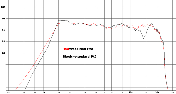

bombardon73 said:I recently build a system with the RS150 and the PT2(no MTM).
They build a perfect pair! The only thing is, I modified the PT2. It sounds better and it's much easier to xover.
Can you share any details on the mods to the PT2 and what the effects were?
The modfication of the PT2 sounds very simple but is a b.... to execute. It all comes down to this, the PT2 has some bad inner damping. The cavity behind the mylar foil has to be damped with felt (I hope this is the correct translation of the dutch word "vilt").
The results can be seen in these pics.
As you can see, the frequency response is improved, it can now be easily xovered at 2,5 hz or even 2khz.

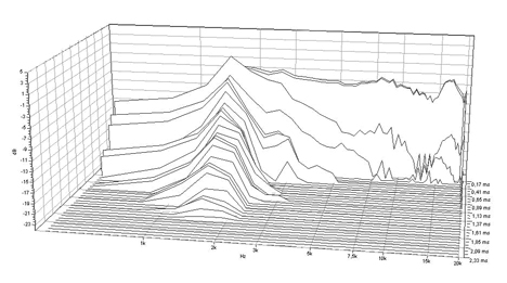

In the decaygrafic you can see how much the resonancefrequency decay has been improved.
