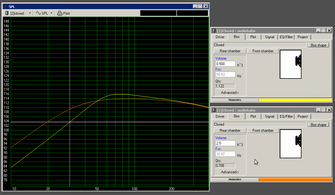

I would try to give them a little more box space than "as small as they will fit in" myself. 0.5ft^3 per driver is about as small as I would suggest. Larger would be better....
The graph below shows a pair of the drivers you are looking at, compared first, crammed into 0.5ft^3 of space (0.25ft^3 per driver, yellow plot) vs the same drivers, given 2.5ft^2 space (1.25ft^2 per driver, orange plot). In each case, your Pe as limited by Xmax stays above 500W per driver right down to 10hz so you can work to the full capabilities of the amp (provided it is clean) in either case without a power or excursion limitation.
Notice the larger box improves efficiency at 30hz by about 6dB. Another way to put it is that, the larger box can play 30hz at 250W, as loud as the smaller box will do it with 1000W.

Yeah 2.5^3 is way too big. That's why I had planned to do Qtc = 1 and apply LT EQ.
I realize the max SPL will be pretty low with that setup, but I'm just looking for decent low bass in as little space as possible. Being obscenely loud isn't a goal.

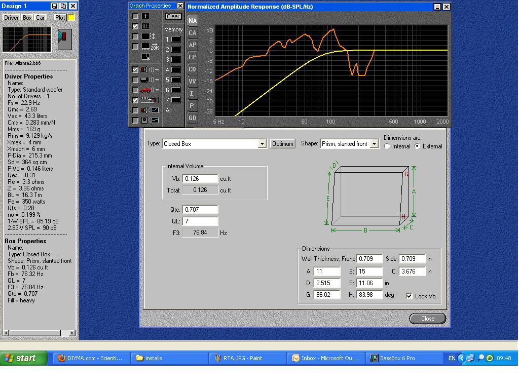

What car are you putting them in? I've gone "LT" in my car using the Aliante 10Si (undoubtably where Audiobahn got inspiration for your subs) and really haven't needed to apply any EQ what so ever-the car is a 2003 Mini Cooper S and cabin gain is my new best friend.
I was fortunate enough to stumble accross a Patrick Bateman thread on diyma and found the transfer function for my car mapped out by Harman when they were testing in the vehicle. I took the graph, entered the gains into BBpro and then started seeing how small my box would still model well at. Got the internal volume down to 0.126cf so I could mount the sub in the footwell of my car:

The Aliante is the better sub IMO. It has a pretty low XMAX, but it's 6dB more efficient and has about 1/3 the moving mass of the Audiobahn.
The Audiobahns need 20x the box space as your Aliante's for the same Qtc, which is way too big as I mentioned. Linkwitz-Transform is the only option I really see unless I just use one sub and build it into the spare tire well; there's at least 2.5ft^3 down there.

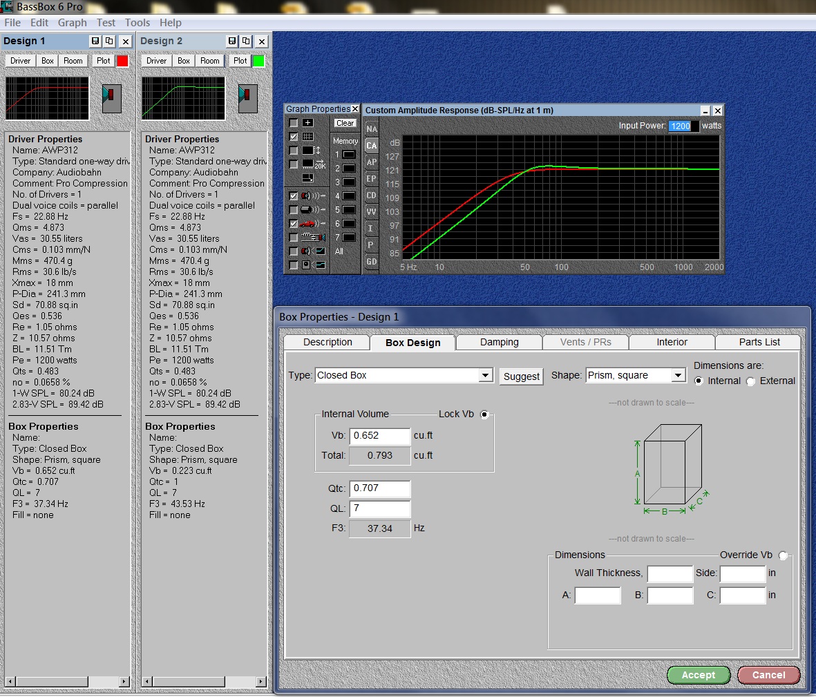

Loaded the measured driver specs into BassBox and get significantly different results. BB shows a box with Qtc = 0.707 only requires 0.652ft^3.
Well.. I modeled a pair of drivers, which would be 1.3ft^3 in BBPro I assume. There is still a discrepancy.
0.65ft^3 per driver results in a Qtc of 0.83 in WinISDPro.
I would be very interested in figuring out why the discrepancy.
I just did the math on paper and came up with ~27L (0.9ft^3) for a box alignment of 0.707, which doesn't agree with either program. Go figure.

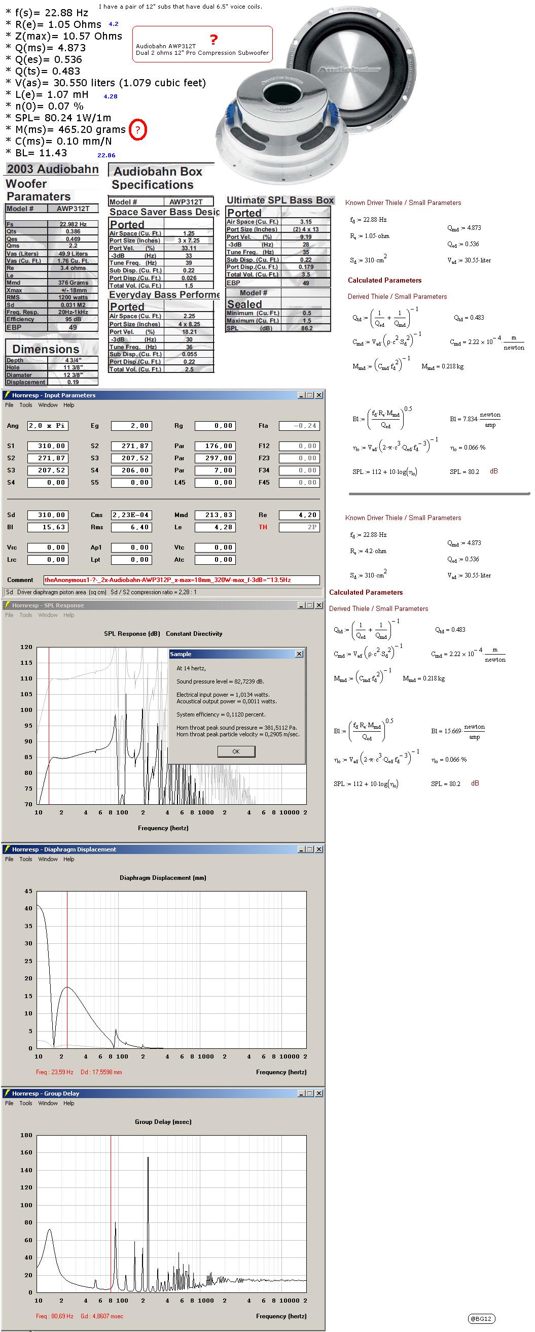

This is interesting. If we are getting 3 different results with 2 different programs and the on-paper method, then we know we have at least 2 wrong results, possibly 3. I'm really hoping someone else can offer up some possible reasons for this!

What are the TS specs you are using, I'll put them (or you can) in Hornresp and see what happens.

As you're getting such varying resultds I'll model you sub in bbpro for you too.
Hi, That's what I tried to do but.....
b🙂
b🙂
In bbpro it highlights any suspected "wrong" parameters-the MMS comes up with a green icon in that (yellow would be a little off, red totally off)
