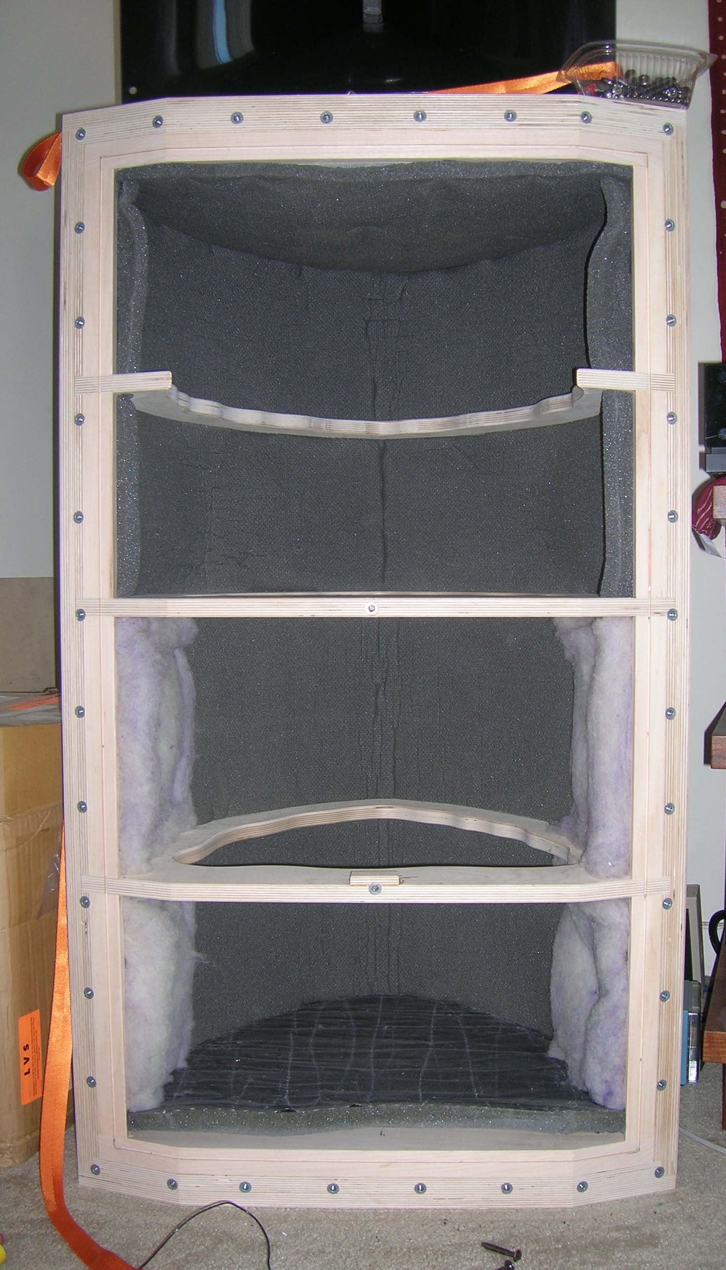

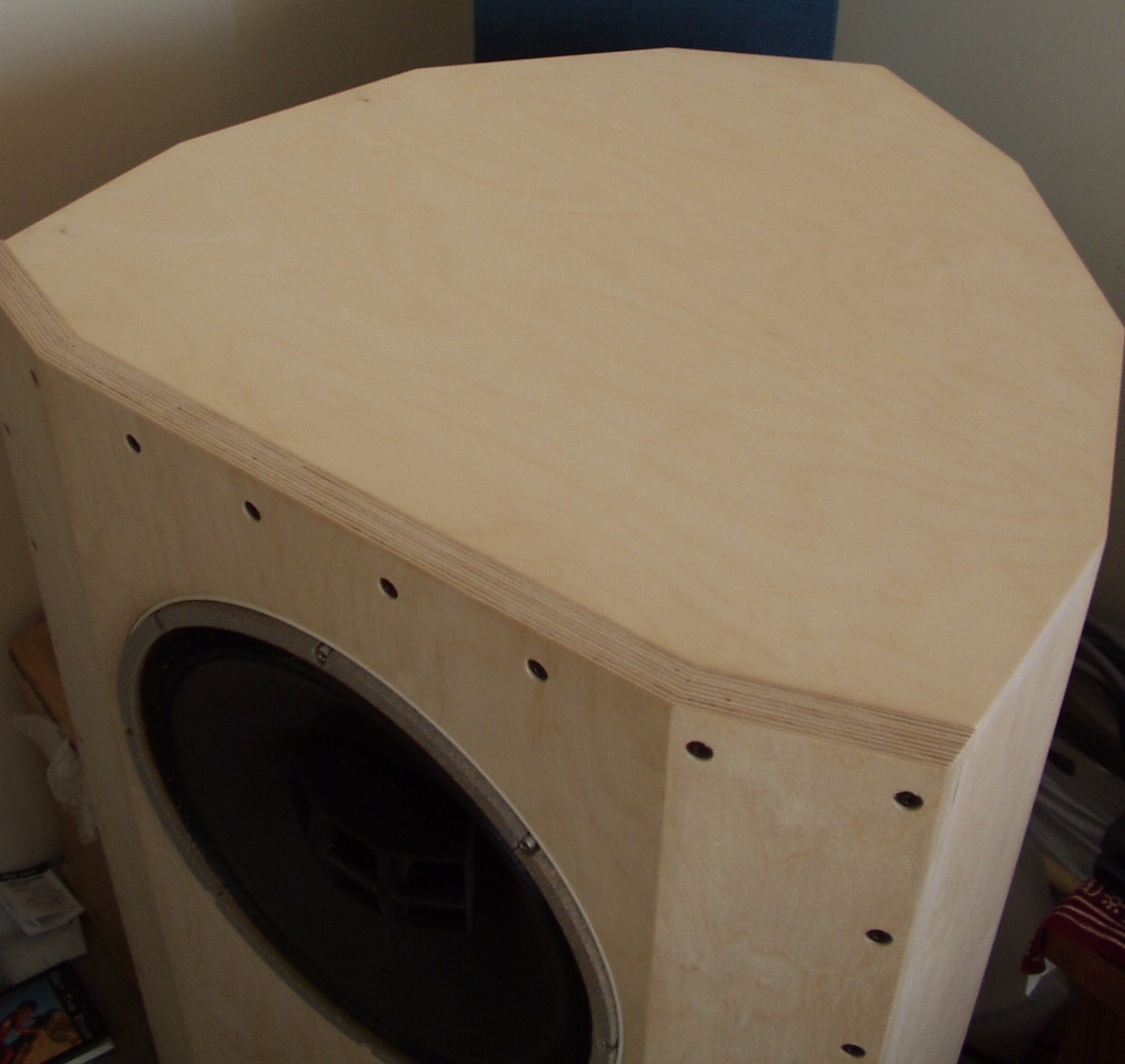

The way I did it was with large pan-head bolts through the baffle into threaded inserts behind.
To make more than one set of baffles (I made two) the thing was to make sure there was a way of accurately reproducing the position and spacing of the holes on the duplicate set.
I made drilling jigs, secured the baffle in place with ratcheted straps, put the jig on and drilled small bore pilot (like 1/64 or 1/32") holes through the baffle and into the cabinet frame behind. Then finished drilling with the right sizes (in the frame for the inserts and in the baffle for the bolt and the countersink).

Those look perfect, beautiful work Hearinspace. With the cabinets fully assembled what are the final wall top and baffle thicknesses? Those look seriously over built.

It wasn't meant to be over-built so much as it was to be sure that it would be able to handle whatever driver(s) might get put into it. At the time, I was given the chance to work in a good wood shop and knew the opportunity wouldn't last forever. I figured it would be unfortunate if I ended up with a resonant cab I couldn't fix later so decided to build a sturdy cabinet that would work as a platform for trying stuff, yet not look like a perpetual kluge.
I don't remember why but I couldn't get 1" Baltic ply so laminated 3/4" (18mm) with 1/4" for a roughly 1" ply. The walls and baffle are made of that.
The top and bottom are double thickness of the straight 18mm ply.
There is extra framing around the opening to make it a better interface with the baffle.
The braces are cut from a single thickness of 18mm ply.
What in the photo might make it look like there's a rabbet around the inside of the opening is actually a small dado meant to take a silicone bead for tight seal but the fit was tight enough without it.
