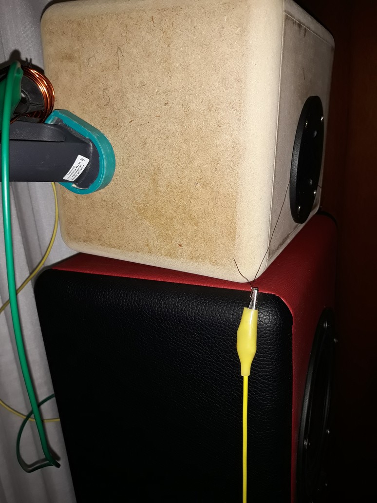

I'm testing in my DIY speaker this configuration, also by align the vertical acoustical centers for physical time-alignment, and the focus I have obtained is incredible.
[I've done this as I'm modifying my actual loudspeaker, thus the added tweeter is quite distant from the woofer (>> XO wavelength)].
But the "angled speaker" is impossible to simulate in conjunction with the below not angled driver, and I didn't find any literature/documentation/study around internet. I can only test and adjust on the field...
Do you know pros and cons of this configuration? Or share any comment or documentation?

In the two examples of Focal and Wilson I see that the woofers are oriented/angled while the tweeter remains on ( ears') axys. You said it opposite way.
With three ways it's much doable, as long as the WTM disposition is used, with 2-way speaker I cannot see the utility - except those examples where the woofer(s) sit on a tilted baffle, which gives a certain directivity.
