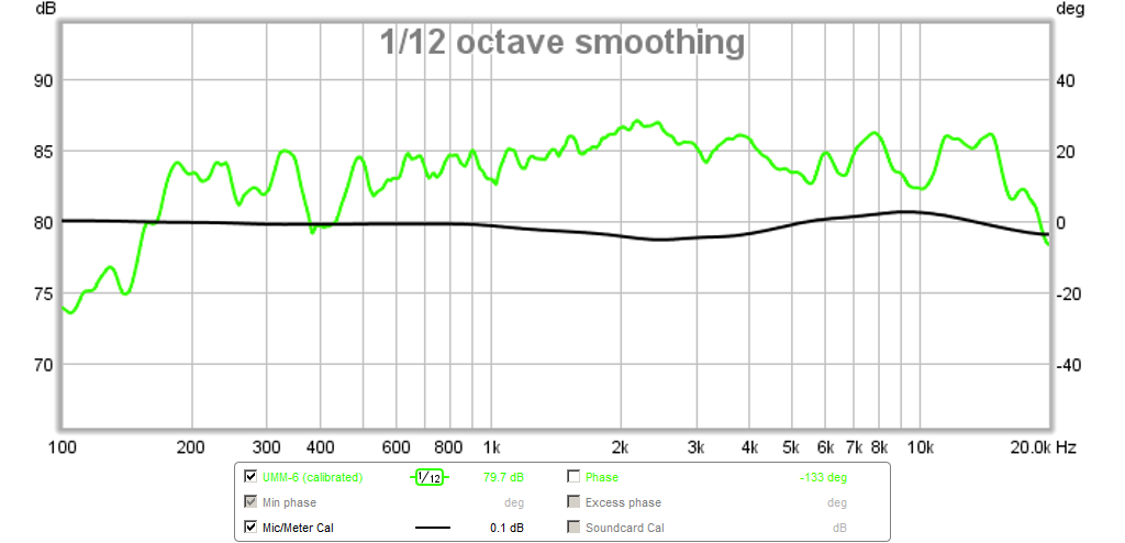

The 5dB high 7.8kHz peak in the data is a feature of B80. Both mics are within 1.5dB uncorrected. The cal file shows about +0.5dB correction should be applied to the UMM-6 raw at 6.8kHz. This would make both mics measure spot on at 7.8kHz, with the Zoom actually be more naturally accurate there. All this complaining about whether or not mics are valid seems moot given the small differences.
I'm adding the cal file to the response of the Zoom. It doesn't matter what the B80 does, you take the difference of the earlier B80 graphs with the Zoom & the UMM6 and then add the cal file.

That makes no sense. The cal file is for the UMM-6. I only used the B80 as a convenient noise source for pink noise because it happened to be hooked up.

The second plot with the B80 and cal file was there just so I could show you the cal file. Ignore the B80 plot. The cal file is a flat line that wiggles up and down by 1.5dB at most.
The cal was for the UMM-6 but go ahead and apply it to the Zoom - so it changes it in places by 1.5dB. Big deal. We are talking about much bigger things when it comes to the dips and peaks that give these drivers their voice. By wanting to apply it to the Zoom does what though?

It makes perfect sense. You used the raw response of the UMM-6 as a reference for the Zoom. To know the response of the Zoom, we need to compare it to the flat response of the UMM6. So we subtract the cal file from the UMM-6 response, assume that is flat (ie assume the cal file is correct for the UMM6 at this time) and look at the difference between the flattened UMM6 and the Zoom. This is the same as adding the cal file to the difference of the raw responses.

If you look at 8k, we have the calfile at +1.5-2 dB (hardto tell without a better scale), and the Zoom above the UMM6, 3-4 dB. This gives the Zoom about a 5 dB peak at 8k. That is not relevant?

UMM-6 Cal File
The cal at 8k is about +0.85dB. Meaning, at 8k, Zoom is about 1.5dB greater than UMM-6. If you apply +0.85dB cal to raw UMM-6, you get the Zoom and UMM-6 to match within less than 0.5dB. I don't see the problem, in fact, it all looks very good to me.

With the cals i have you subtract the cal curve. I put the difference between UMM6 & Zoom at 8k at at least 3 dB. Higher rez graphs with more graticles would be useful.
Given the age of the mic a fresh cal would be nice.

To be fair, the mic cal really needs to be EQ'd out. +0.85dB is audible when over a large frequency range. Shouldn't be hard to correct that mic curve with a few PEQ points on the miniDSP.
Mic cal is for (frequency response) measurement mic UMM-6. Zoom H4 mic has no cal and records 96kHz 24bit WAV sound clips as is (raw). There seems to be confusion as to which mic is used for which purpose.
The point of this figure is to show that the mic for the Zoom H4 is not some totally unknown element in the audio signal train. It is in fact, quite similar to the mic used for the frequency response measurements. Anyhow looking at the following graph should see that there is not an issue with the sound clips presented as "misleading" or far from the truth of what the reality is of how they sound.

So the with the pink noise comparison graphs this is the raw response without any calibration files applied to either microphone.
If this is the case then if you apply the calibration file for the UMM6 to the UMM6s response then we would have a useful comparison.
In that way we'd have a measurement of the B80 with a fully calibrated system (UMM6 + calibration file) and a measurement of the B80 with a non calibrated system, the Zoom.
Given the two all you'd need to do is subtract the calibrated systems response from the uncalibrated systems response and you'd create a correction file for the uncalibrated system. Or do the subtraction the other way around depending on the requirements for the correction file.

Yes, but this is only part of solution since X's preference for recording clips based on his live experience is using Zoom H4.
1) record IR of a finished system with UMM-6 at point Zoom H4 will be used for sound clips.
2) further EQ system such that UMM-6 response without calibration file applied matches response from 1)
3) substitute Zoom H4 into recording position used in 1) and measure system response at same sample rate used with UMM-6.
4) EQ system response so that Zoom H4 response matches results from 1)
The above is core of microphone referencing by substitution using a known microphone (UMM-6 with calibration file applied) and unknown microphone (Zoom H4's two microphones).
