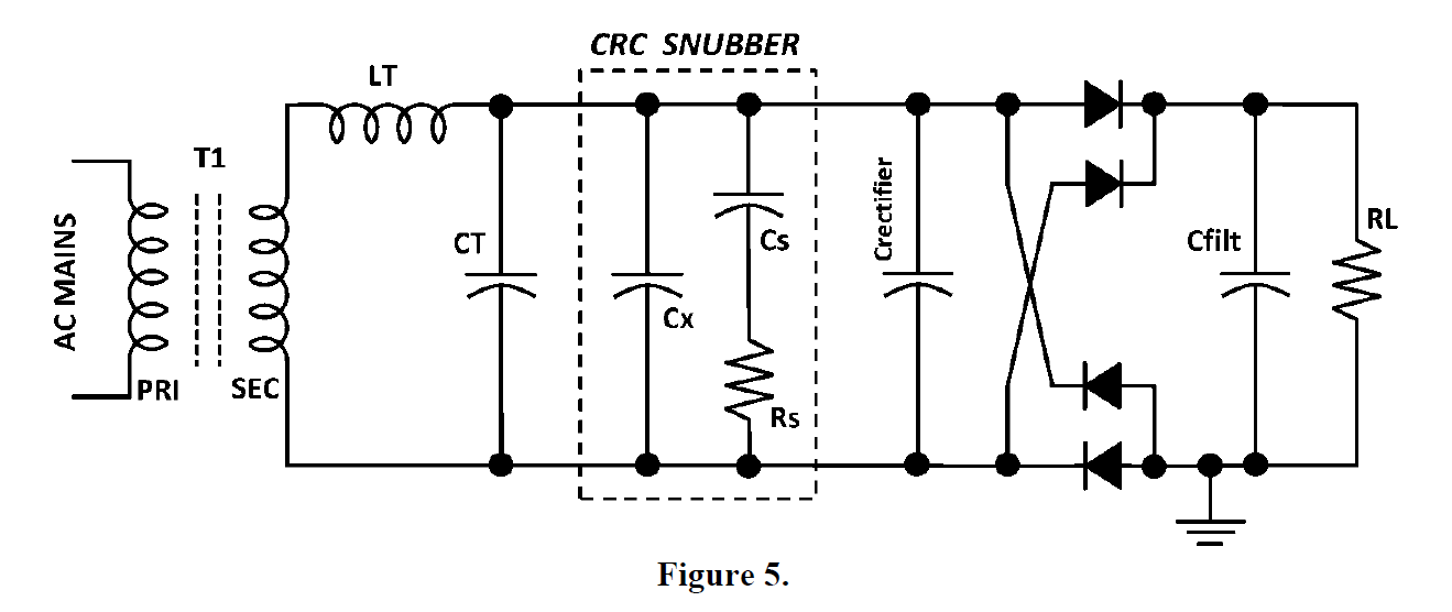

Abstract: Power transformer secondary ringing was measured with 48 different semiconductor diodes; ringing amplitude was 10-20X lower with the best diodes than with the worst. They all rang, including Schottkys and HEXFREDs. { but some rang a lot less than others }
... The Soft Recovery diode with the highest datasheet "softness ratio" (tb/ta), was among the eight double gold medalists.
... It was also found that CRC snubbers eliminate ringing completely, even with the poorest diodes.

How to build a CRC snubbers? is there a kit? or we could build on a bread board or universal board. Following your thread says, I have ordered Sanken bridge rectifier 25A/600V, instead of 150V, 120A Schottky diodes (x). So I am exicted to install this CRC.

Perhaps @fjc is equating C-R-C to a pi filter.
If so, in that nomenclature the snubbers would be C-RC filters.

build a quasimo do test jig
By the way, I have ordered ordinary bridges for my power-amp, instead of purchase expensive power schottky diodes because that this thread tell us all the diodes ring, no matter it is fast diode, soft recovery or even schottky, or HEX.
Yes thanks to everyone, specially Mr. Johnson. Where can we buy this quasi test jig? It seems that the parameter Rs is quite individual. No universal solutions unfortunately, each transformer, add up different secondary voltage set up need to be tested. So we need a power-supply, a signal generator, and a jig to determine the ultimate Rs value free from the ringing? Forgot, there is a scope to read the osc also. Sign generator should be set at 120 hz for 60hz AC, What about the voltage supply value? match the secondary output, 36VDC in my case?A picture tell a thousand words. Now I know exactly what you were talking about.

you don't need a signal generator.Yes thanks to everyone, specially Mr. Johnson. Where can we buy this quasi test jig? It seems that the parameter Rs is quite individual. No universal solutions unfortunately, each transformer, add up different secondary voltage set up need to be tested. So we need a power-supply, a signal generator, and a jig to determine the ultimate Rs value ...................
The fast switching current circuit is inside the quasimodo jig.
You do need an oscilloscope.
The fast switching current circuit is inside the quasimodo jig....
Further to Andrew's points, the switching circuit doesn't need to be at 100Hz or 120Hz; the bell's ringing frequency and dampening values are independent of how often Quasimodo smacks the bell.
Same for voltage; ringing frequency/dampening values are independent of how hard Quasimodo smacks it (as long as he smacks it hard enough to ring).
Mark's document is well worth reading; it covers these points and others of interest.
