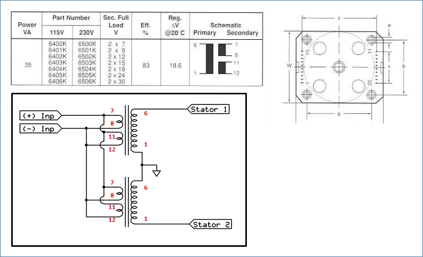

Bummer... I'm finally getting back to this project and realized that my Talema sealed transformers have neither center taps nor dual sets of wires on the 230V side. Anything I can do with these to make a bias supply ground?
You can connect the 9V windings of two trannies in parallel and their 230V windings in series.
Requires of course two trannies per panel.
I prefer the 2-tranny solution, since it results in the highest (internal) flashover limits.
The flashover treshold (typically specced at 4 or 5 kV rms) applies to primary-secondary.
Inter-primary or inter-secondary values can be considerably lower..
Also potting increases the capacitance values .... unpotted trannies may be a better choice in this regard .... besides the single prim, single sec, unpotted types are typically the cheapest tformer versions availabe.

…my Talema sealed transformers have neither center taps nor dual sets of wires on the 230V side. Anything I can do with these to make a bias supply ground?

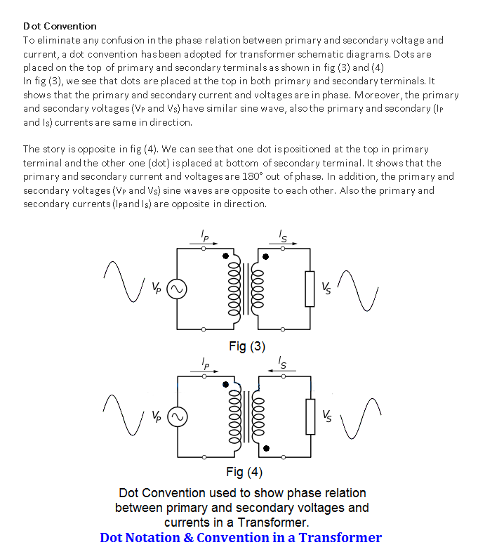

As Calvin mentioned, most people use 2 in push-pull to provide an easier center tap and double the step-up ratio. I must admit, I thought that was what you had intended to do. This configuration will give you a step-up ratio of about 1:50. The Talema data sheet does not specifically show the phasing of the different windings with the usual dot notation. The attached schematic assumes the dots are at the top of each winding (ie positive phase entering at pin 6 of the primary will produce positive phase output at pins 7 and 11 of the secondaries.)
If at some point you want to use a transformer without a center tap and not in a 2 transformer push-pull configuration, you can use the Acoustat method of adding a virtual center tap using resistors.

You know, I guess I did intend to do this in series/parallel since that's been talked about a lot, but it must have slipped my mind when ordering and then when they got here I assumed I had what I needed for both channels. I'll probably just try hooking them up on one channel to do some A/B measurements and see what I find. Got some issues with my measurement gear to sort out before then though... measurement mic is not sounding good when recording voice as a sanity check and is showing a noise floor of 1-2%THD I think. Hopefully soon though...
