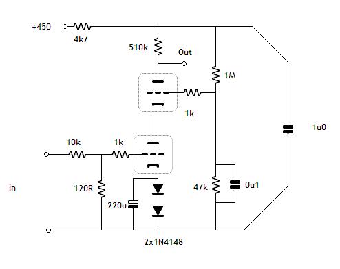

I'd probably not bother with the cascode. Just disconnect the top section by removing the 620R, then use a plate resistor or outrigger CCS from the bottom section to B+. You want a high mu there, maybe a 6SL7. The other problems with this design remain- there's not even close to enough open loop gain to make the feedback effective. Me, I'd get an Xacto knife and do some trace surgery and put a FET on the bottom and a 6SL7 on top, but that is not a job for the faint-hearted.
Another alternative for the brave is a starved-current cascode with a very high plate resistor (perhaps that what this designer was aiming for, but didn't pull off correctly). That will take a lot of bench experimentation. I'll try to dig up the version I tried and post it (though perhaps I already have); it could be adapted to a 6SL7 if memory serves. How are the sections divided, i.e., are the bottom and top of the cascode a separate tube from the phase splitter?

Sy, whats the theory of operation on that last circuit you posted?
120R for grid leak seems awful small. All the values seem a bit
out of whack, but then again you said it was starved. Maybe its
intentional to be that way? I just can't put 2 and 2 together and
figure how this works to make a cascode any better behaved?

The large input resistor and small grid leak were used as an input attenuator for test purposes- the gain is so high (51dB) that with usual input levels, the output saturates. In real-world use, you'd have a more normal 100k or so grid leak and no input resistor (other than the usual grid-stopper).
I suppose if both were held to a truly constant current, then
both should amplify linearly by Mu (and then by Mu again)?
Starved of plate voltage, Mu might be far less than usual.
Thus the square of Mu*Mu might be a manageable number?
I am not entirely sure even that large a passive plate resistor
would enforce a sufficiently constant current onto a very high
impedance cascode for Mu*Mu linearity. And then to drive any
sort of a load?!?!
I would want a solid state Mu follower on top, with overwhelming
transconductance, and maybe a source resistance tapped for bias
with bootstrap from plate to gate to sufficiently stiffen up the load
line as seen by the cascode.

I was trying to stay with a triode restriction and to use bf's boards (if he can't return them).

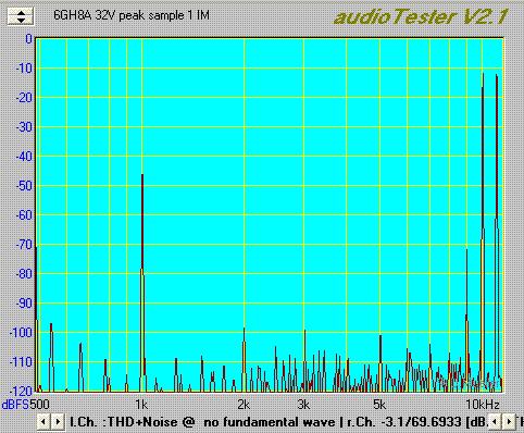

Linearity of the test circuit was actually pretty good. At 2VRMS out, second harmonic varied from -54 to -60dB, third and higher all under -90dB.
Pentodes will give the requisite gain, but linearity is the question- unlike a Mullard input stage, the splitter is unity gain, so the input stage has to swing the full 35V or so needed to drive the outputs. That can get ugly.

There are some basics to designing the cascode properly....
Consider the TOP triode as a voltage regulator, ie it is a cathode follower voltage regulator....with a reference voltage on the grid...Your best best is to REGULATE the voltage going to the grid of the TOP tube...this will improve the PSRR and inprove linearity...
This TOP triode is acting as a trans-impedance amplifer.... So you dial in the voltage on this grid you want to get on the lower triode plate... The lower triode is has it's plate voltage fixed by this top regulator tube...You choose an operating point that yields a descent gm...
The key is to not waste too much voltage drop on the lower and top tube.... The lower tube is simply a gm amplifer, use as small a voltage across this lower tube as possible to get the gm where you want it.. SAme with the follower, don't waste more voltage drop than need be... SAve most of the voltage drop for the Load resisitor...Since this will give you the best optimum swing...
