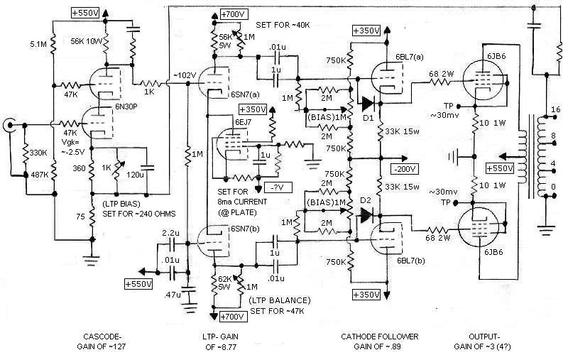

I think this MIGHT actually WORK, this time!!
Changed a lot of stuff.
Went back to the 6SN7 for the LTP... it just could swing the voltage better, while being able to use the right DC grid voltage (relative to ground) to match with the output of the cascode (direct coupled).
With the 6SN7 as the LTP, that led me back to the 6BL7 for the cathode follower... no reason NOT to do that.
Still have the 6N30P as the input in cascode... but with a PARTIALLY bypassed cathode resistor. Got the gain up to 127...
The LTP now has a gain of about 8.77... with a CCS and some corrective anode resistors, balance should be pretty good. Bandwidth of the LTP should be around 210KHz... OK, I would think.
NOW I have enough gain, to get me around 20dB of negative feedback, AND still be at the same input sensitivity for full output as the Berning original circuit (about 1.5v input for full output). Depending on the outputs (which may give more than a gain of 3, according to my estimation), I MIGHT get even another few dB of open-loop gain, which might allow as much as 23-24 dB of total feedback.
My main trick I want to try, is as someone suggested (Douglas?), using a PENTODE as the CCS in the LTP. Looked around, and the 6EJ7 looked good... could handle the current, and had a suitably high plate resistance. HOWEVER- I would REALLY like some advice, in how to set up the pentode. I know I need 8ma of plate current... but EVERYTHING else is still unknown to me... what negative rail voltage on the cathode (I'd prefer to be able to use the same -200V as the negative rail on the cathode follower, if possible?), what positive voltage (assume probably something like 100v?) on the screen, what cathode resistor, what bias voltage (to set the resistors on the signal grid), etc... any assistance GREATLY appreciated!
I do thank all involved with their patience with me in this affair... I'm learning a bunch as I go along here.
Gordon.

Hmmm, I'd still want more gain from the driver but...
Let's start with the cascode. Your choice of that topology means that the power supply rail will have to be REALLY tight and clean- there's almost no power supply rejection. The RC circuit in the cathode could be replaced by an LED which will outperform the inevitably crummy electrolytic cap; it looks like your required drop is pretty close to a 1.7V red. The grid of the upper tube needs to be returned quite a bit more directly to AC ground. And RF ground, too, if you don't want a VHF transmitter.
The driver LTP can be simplified. If the CCS is worth a bucket of warm spit, the plate resistors (and grid resistors of the next stage) can be fixed and equal on both sides. Matched.
I'd just set the candidate CCS tube up on the bench to determine its operating conditions. Screen currents vary a lot. Of course, I probably wouldn't use a tube there anyway...
For the LED voltage-drop idea- I need more like 2.4 volts... but what, if anything, would be the problem with using a series combination of an orange LED (2v drop) and something nice like a .4V forward-voltage Schottky diode? That'd be pretty much exactly the right voltage...
Also, with diodes/LEDs... since there's NO switching involved here (it'll always be on), the normal issues with diode noise should not be any sort of an issue, right? I'd think that most ANY diode should work pretty well, right?
For AC-grounding the grids of the top cascode tube- John Broskie has a suggestion one of his pages at TubeCad, about putting caps in parallel with the resistors... which can be "ratioed" to cancel out some of the B+ noise, if done right. I'd think that might take care of both problems at one time?
One other thing- it was suggested that I change the grid-stop resistors on the cascode sections to 1K, instead of 47K. That was duly noted, and will be done...
As for the CCS tube- I actually went back and did the voltage drop calculations correctly, and determined that the 6EJ7/EF184 doesn't have enough B+ voltage handling (250V DC max across plate and cathode). So, I'm thinking something like a 6AU6... 300v B+ max... and a negative supply between -150 and -200 volts. Should get it in its "happy" range... 😀

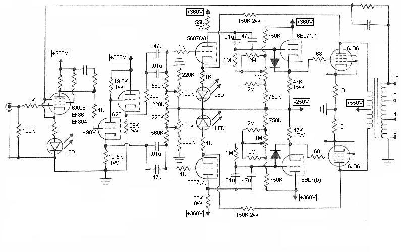

Wholesale changes...
I'm frankly tired of banging my head against a wall, trying to get this thing to work with a LTP phase splitter. Obviously, this is not something that can easily be done with tubes that are commonly available, or with reasonable B+ voltages.
Decided to try something different... a concertina phase splitter with equal output impedance (cathode follower on the "top" side), and a second voltage amp stage... more like the original Berning EA230 configuration, but with steps taken to get around the limitations (voltage swing, bandwidth, gain) of the original design.
Once I decided to do this, I discovered FIRST off, that the 700V B+ rail is NO LONGER needed. I AM still going to use separate power transformers (one for the output, one for the rest of the amp), but I no longer need a voltage doubler on the second transformer.
Also, I was able to use MUCH MORE NORMAL tubes. Some of these changes might actually make the whole thing more linear than before...
I'm getting MUCH more voltage swing out of this, without the extreme B+ voltages (the most across ANY stage is 610 volts, for the second voltage amp and output cathode follower driver). Like, this thing MAY be able to put out as much as 80w/ch, depending on the behavior of the output tubes. I'm getting like close to 180v available at the screens of the output tubes, by the sims!
Also, the predicted bandwidth is MUCH better. Doing the Miller-capacitance calculations for likely alignments of a few of the different options for input pentode tube, I'm getting something like 450KHz... and the REST of the amp is "greater than 1MHz" according to TubeCad. And this time, the math actually agrees on paper! In this, the output transformer will be the only "wild card" as far as bandwidth is concerned... and I am pretty confident that I can take care of that situation with the Zobel on the input stage or the cap in the global feedback loop. If needed, I can always add a cap from a tube plate to the global loop, or try some of the things Bricktop did to "fix" the Heath W4... using the plates voltage on the output tubes as a "partial drive"/feedback for the second-stage voltage amps (see this thread on AudioKarma: http://www.audiokarma.org/forums/showthread.php?t=149678&page=2 )... stuff like that should be able to take care of things, I would think, at least in theory.
The astute viewer 😀 will notice that there are 3 LED's... in the cathode circuits of various stages... I will set whatever voltage drops I need (and whatever LED's I need to string together in series to do that) depending on whatever voltages I wind up needing, to properly "partially bypass" the cathodes of those tubes, to get the gain I need. That does seem like a much better idea than a resistor and an electrolytic cap!!
I don't have resistor values for the first stage yet; I'm planning to set it up for a gain of right around 100. Should be no problem for any of the tubes I'm thinking about. Gain of the cathodyne/concertina is of course just below unity (.95, IIRC), gain of the second voltage stage is about 13 or 14 (depending on what values I finally wind up using), the output driver cathode follower has a gain of about .9... and I'm assuming AT LEAST a gain of 2.5 from the output tubes (even in screen mode, they should do THAT much, if not more). If I wind up with lots of gain on the outputs, I'm going to drop back the gain on the first two stages a bit, so that total feedback (from the two loops, combined) is around 17-20 dB.
Wow... it's nice to actually have GAIN TO SPARE, at least in theory!!
So, any thoughts on this one????
Thanks!
Gordon.
