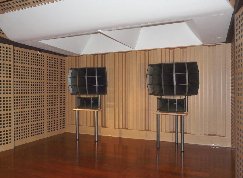

The combo absorption/diffusion thing is a big aspect of Bogic Petrovic's designs. He's over on gearslutz and I'm a fan of his work. Here's another link for you to ponder over that (to me) looks more appealing and fairly cost effective to do, the wood slats over the insulation, if you need to add some diffusion back.
That looks quite nice indeed, thank you for that link. One more thing to consider trying out... 😱

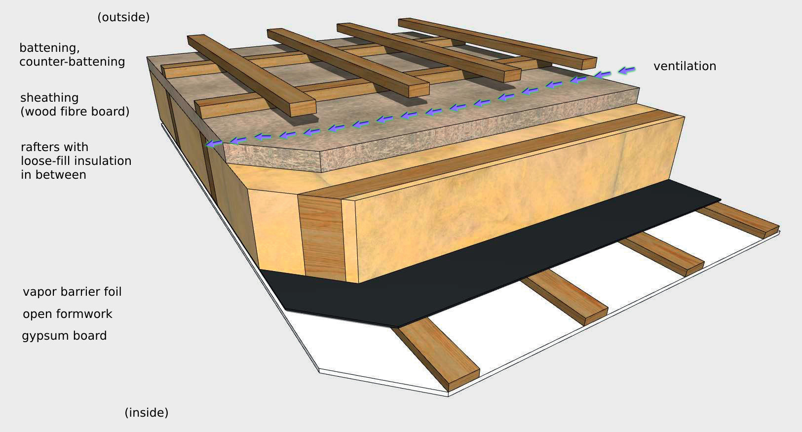

The problem is, you have created a new heated environment.That's true, under the attic floor there's a foil layer. According to the contractor this foil was not needed on the attic, because of the OSB. Was that wrong?
Vaulted ceiling attic venting 101:
Heat holds moisture
Heat and moisture pass through OSB. The perm rating is ok but it's not a vapour retarder
Air cools, condensation forms at the dew point, often on the underside of the decking (fiberboard)
With no air flow to dry the condensation, mold forms
Mold can be an irritant or worse depending on the person.
Rot OTOH takes years but can give you a heck of a headache if you're in the room when the roof collapses
Question is, why allow either to happen in the first place?
Again, if I am misreading you then disregard, but what you've said so far has me concerned.
Your Contractor may or may not be fully aware of these things but please don't trust the guy who's swinging the hammer as his primary interest is contracting, not design.

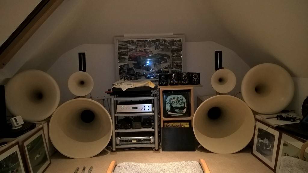

We moved from a regular rectangular listening room to a loft room for the HiFi.
Mine is a different kettle of fish system to yours.. horn system.
I had no problems with the upper channels.
No correction or any tricks there.
Just plonked down and all worked and measured well.
The mid bass, mid, upper mid and tweets sound just fine.
The below 90Hz bass however was like a rollercoaster. Suck outs and peaks.
I use DSP x/o (a DIY audio Najda set up) spent a good while working a solution that sounded good enough.
Got more powerful bass channel amps with higher damping factors.
That helped too.
I'm pretty happy with it.
Sounds a bit different and does something's better, some not quite so to my ears.
A few hifi visitors who have heard both have even commented that it sounds better than the previous room!
I would not know where to start with acoustic room correction stuff.
The tapped horns are lying down either side and point upwards. Worked best like that..
Pic of room.
Not sure, but now you have me concerned that my roof might collapse anytime soon... 😱
I've attached an image that pretty much resembles how my roof was built. The graphic comes from another contractor, who built several of my neighbor's homes. I tried to translate the descriptors as good as I can.
In my case (for the attic only) the foil, formwork and gypsum board were replaced by a single layer of OSB. Would you say that the missing foil (and probably the formwork) is a real problem? Should I do anything about it before it is too late?
Otherwise the construction is pretty similar to how the other walls of the house are built. The whole house, including the attic, is pretty much air tight to pass the blower door test, which it did. To counter the development of mould we have a whole-house ventilation system. The attic, as a heated room, is of course attached to the ventilation system, too.
Please tell me that everything's fine... 😱
So the issue is having the right stuff in the right places, and all of it works as advertised.
I see. The more often I re-read your posts, the better I think I understand them now. Many thanks again for your thorough explanations!
Looking good 😎. I'll show this picture to my wife and tell you what she thinks 😉!

That won't happen but the roof does not meet building code standards where I live and I expect not where you live either. Moisture is moisture and it cares not where it livesNot sure, but now you have me concerned that my roof might collapse anytime soon... 😱
There are some words being used that do not coincide with what we use here so I won't be using the term fiberboard (OSB here), open formwork (battens or purlins here), I will simply use terms like sheathing, etc.I've attached an image that pretty much resembles how my roof was built.
I see trouble on the horizon. The designer has taken certain ideas and implemented different materials that cannot do the job as intended. If the insulation fills the cavity to the top of the rafter, it must be air free. No air means no moisture. That's works fine but is difficult to implement. Batt insulation does not eliminate the air so you require a gap between it and the sheathing, with air the flow from the eaves right through to the ridge. You don't require ventilation above the sheathing, you usually have a breathable watershedding membrane on top of the sheathing to catch the small amount of moisture that get's by the tiles in really bad weather.

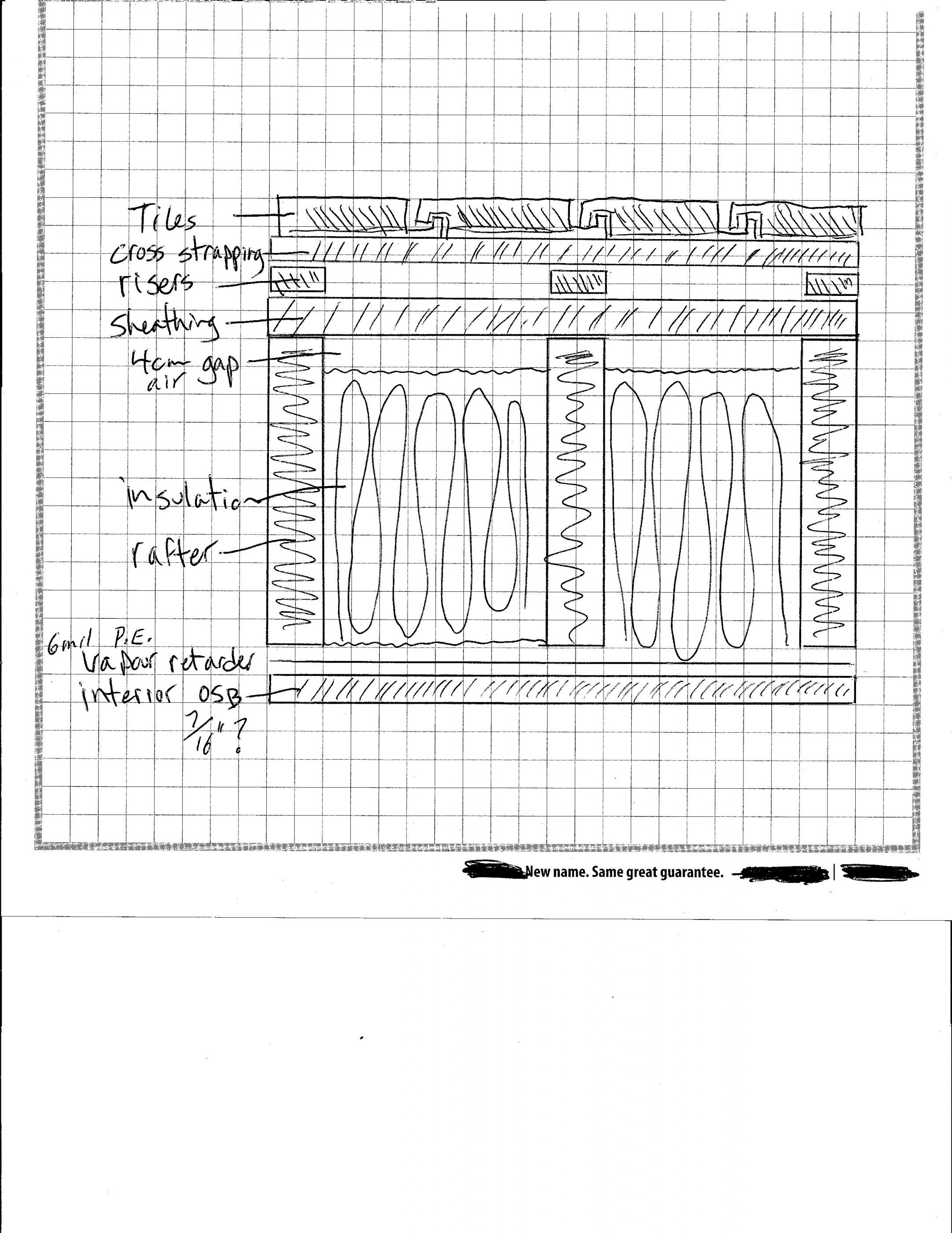

The correct way to build your roof with the materials at hand is as follows:
The insulation must be kept lower than the top of the rafters by 4 cm. Often some form of retainer is used like battens or WHY, that prevents it from billowing back up and blocking the air flow. At the eaves you must have air intake. The amount is determined by the total area. Around here it's a 300:1 ratio meaning 1 cm^2 of air flow for every 300 cm^2 of roof deck area. 50% of the ‘breathing’ is done at the eaves and 50% at or near the ridge. If that is done everything above that is fine the insulation is fine. The vertical battens allow for uninterrupted water flow during really bad weather and the cross strapping allows for the use of static breather vents rather than continuous ridge venting.
The easiest and least painful way of dealing with this is to pull down the OSB, remove the insulation, ensure there is a means for the air to flow at the eaves and at or near the ridge, add insulation retainers so when you reinstall the insulation it stops 4 cm short of the top of the rafters, then add a proper vapour retarder like polyethylene sheet making sure it is well sealed and reinstall the OSB. The OSB does not need the joints to be sealed, you can place the interior finish right over it or you can fill the holes and seams and do whatever you wish.
I will do a little chicken scratch drawing and post it a little later. It, along with this outline will give you trouble free construction. Otherwise mold will move in probably in a year and rot will be evident in less than 10.
The soft fiberboard is not OSB in this case, it's something like this stuff: http://www.steico.com/en/products/wood-fibre-insulation/. OSB is OSB here, too.
Open formwork was what the translator gave me for "Sparschalung". It's pretty much the same as your battens or purlins. We call them "Latten" or "Dachlatten", so it's "Lattung" and "Konterlattung" on the outside, and "Schalung" or "Sparschalung" on the inside.
I'm looking forward to your scratch. I've seen a lot of roofs already, because I sometimes have to add some cables there, and the way that I pictured them is certainly not uncommon around here...
Since the insulation is a fluffy mess, it was blown into each of the cavities between the rafters through a hole. The holes were taped up afterwards. Like this stuff here: isofloc | Processing of injected insulation materials
