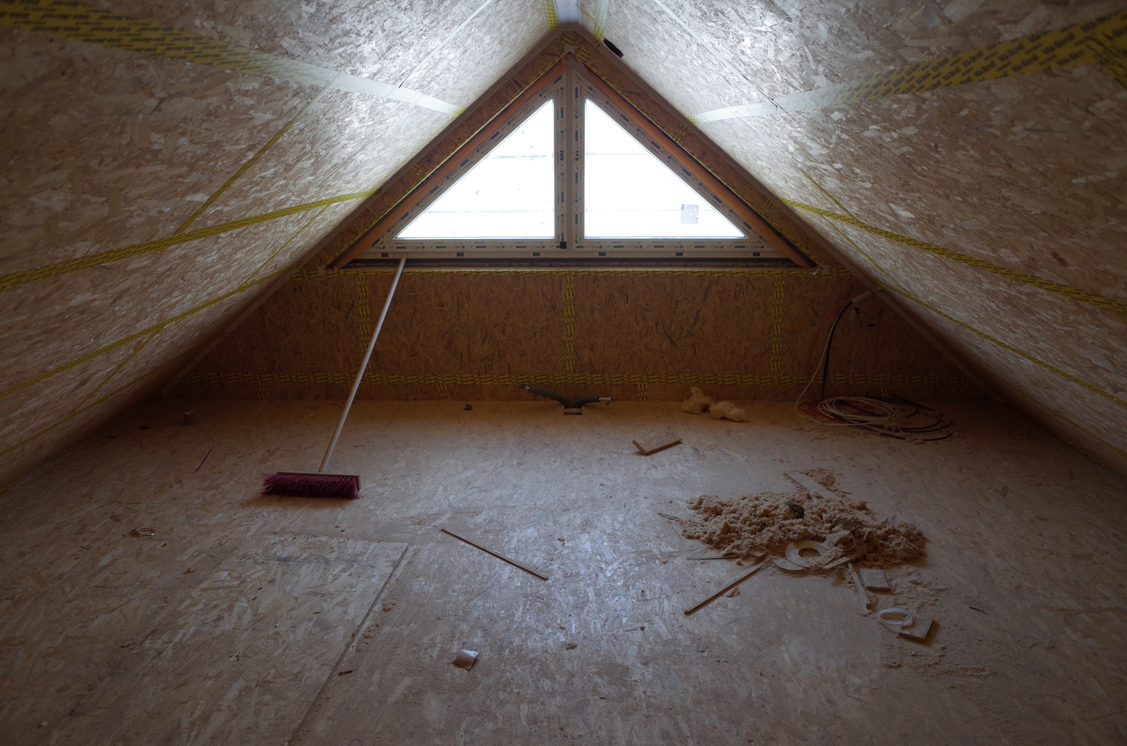

While thinking about finally tidying up my attic room, I've come across acoustic room treatment again. Been thinking about that a while back already, but never managed to try it out actually. Here's my probably somewhat unusual idea (haven't seen that done before anywhere), so please tell me what you think.
As you can see on the picture below, my room has slanted walls from top to bottom. I'm planning to generate some out-of-sight storage space by adding sliding doors to both lower sides, probably up to the height of the window sill. That will leave me with ~2m high OSB walls from above the window sill up to the top.
What about batten down those walls, put some 10cm thick rigid fiberglass in between, and then cover up that whole construction with fabric? I would basically hide the whole wall behind a huge absorber, instead of hanging individual absorbers to the wall.

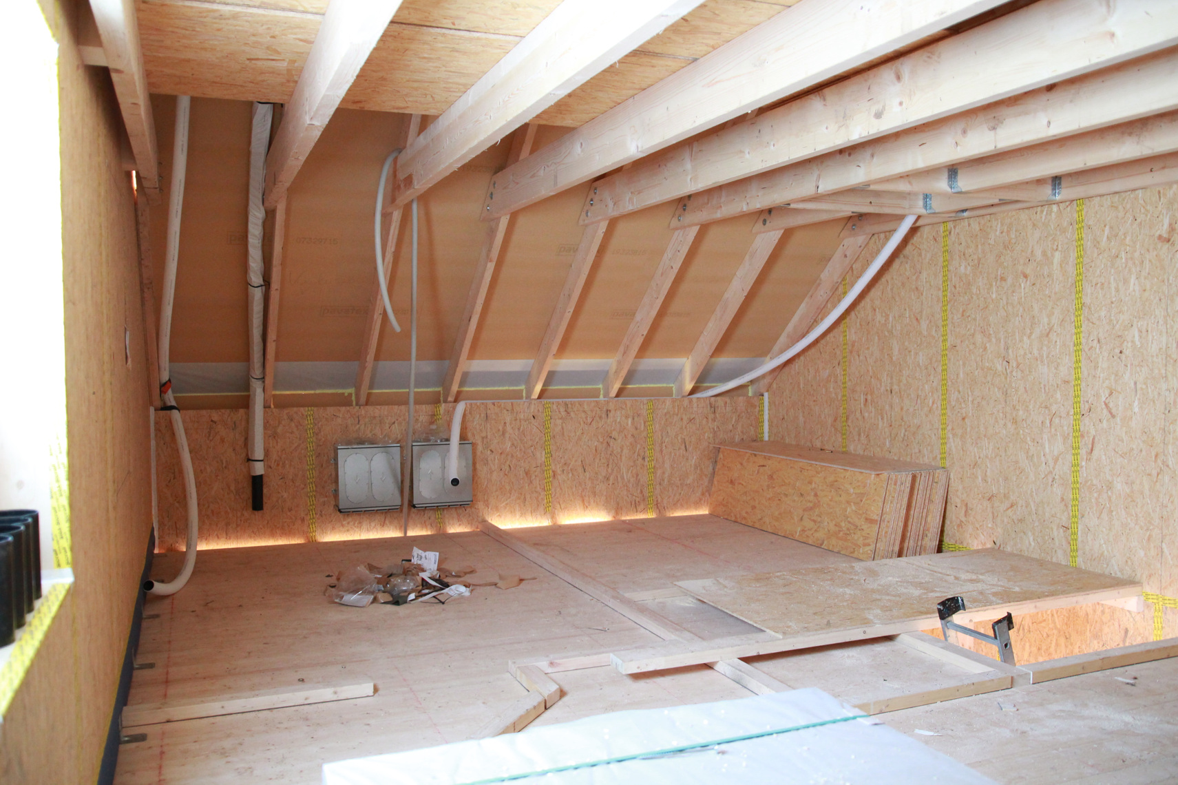

Hi Cal, I'm not sure if I got you right and what kind of drawing you mean, but the attic is basically sealed air-tight like the rest of the house, and a ventilation system with heat recovery is on duty.
One restriction is that heavy bass damping already buried under OSB will require powerful bass response from your playback systems. If not, the bass response will be simply too lean.
I've noticed that already. Listening to The Prodigy is no fun at all... But I'm fine with the lower end - for the moment, at least.
I'm not totally satisfied with overall sound quality though. I'm still moving around the speakers to find a good position, but there're huuuuge differences.
I'm afraid that those slanted walls are going to be a pretty severe problem, speaking from experience. Here is a picture of one guy's room after he finally tamed the room modes and the imaging-destroying reflections:

I'll give it a try (lots of new words I've never used before): The OSB on the inside is acting as a vapor barrier and all the seams are sealed with lots of sticky tape. It is mounted directly to the rafters. On the outside of the rafters is a wind brace band and soft fiberboard. On top of that comes the battening and then the roof tiles. The space between the rafters is filled up with loose-fill insulation (made out of old newspapers, judging by the look of it).

Hi again,
First, I'm only saying this because I hate to see you put something together only to regret it later.
OSB is not a vapour retarder. It is likely that condensation will occur partway through the insulation or on the underside of the fibreboard unless there is an air gap between it and the insulation and there is both air intake and exhaust for that gap. The amount of moisture that can get through even the best OSB, will not likely vent well enough through the fibreboard or through the gaps in the tiles. I am guessing the original vapour retarder and insulation is under the floor of the attic? If so you have now set up a second source of moisture and little means of venting it.
If I am getting something wrong with your structure, forgive my intrusion.
That's true, under the attic floor there's a foil layer. According to the contractor this foil was not needed on the attic, because of the OSB. Was that wrong?
Takeaway message for me is that putting rigid fiberglass directly to the outer walls is a bad idea. Leaving a little room of a couple centimeters would be fine I guess, but that would increase the complexity by a fair amount, so I could just as well build individual diffusers and hang them on the wall individually.
