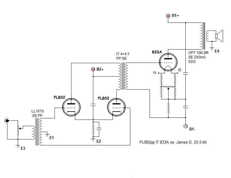

Now I just need a design... well I have knocked one up using PL802 in pp as a driver (see diagram). but I am not sure what operating point for the 8333 to use. I like the look of Va=750V, Ia=350mA and Vg=+25V. It looks like I can get a very linear swing for +/- 25Volts input with maximum input of +/-50volts before clipping the output. This with a 3K OPT. However I am wondering what op points other people have used or would suggest???
I will make the high voltage supply bipolar to half the B+ to earth risk at the cost of doubling the number of caps and chokes in the power supply - a worthwhile trade off for me. I have most of the components for a +/- 400V to +/- 800V supply at 400mA so that will do one channel! Just one to go...
I am lucky that I have two surplus switch-mode psu of 12V at 10A that I can use for filament supplies. I'll feed the psu through CLCLC rf filters to reduce the switching noise even further and connect that to the filaments.
Any suggestions or thoughts are most welcome
