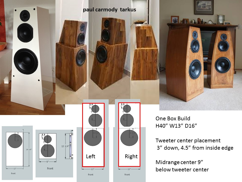

Proposed 3-way design - your recommendations?
Some thoughts:
- Ditch the super-tweeter, use a better 1" driver.
- You should really be using a measurement mic and a custom crossover. This won't sound good with a generic crossover.

But I will forgo all this retail pre-made speaker nonsense and venture unabashedly into a DIY level-up larger format 3-way speaker, at my own peril - at a similar cost if possible! :hypno2:
Pasive XO parts for a first build will satelise the whole budget, try & error, curiosity factor and so on is a wallet trap. Advices above if the loudspeaker is to swap the main are not bad advices.
The best chance to limit financial collapsing are indeed a cheap mic and a free software and those cheap chip T-Amp or clone that have 2 o 3 ways electronic XO qnd DSP... but not the a 300 usd budget with the drivers and wood.
Frankly there are tons of good second hands that can be tweaked for few or reliable kits famous enough to be named "good enough" approval in the 300 range.

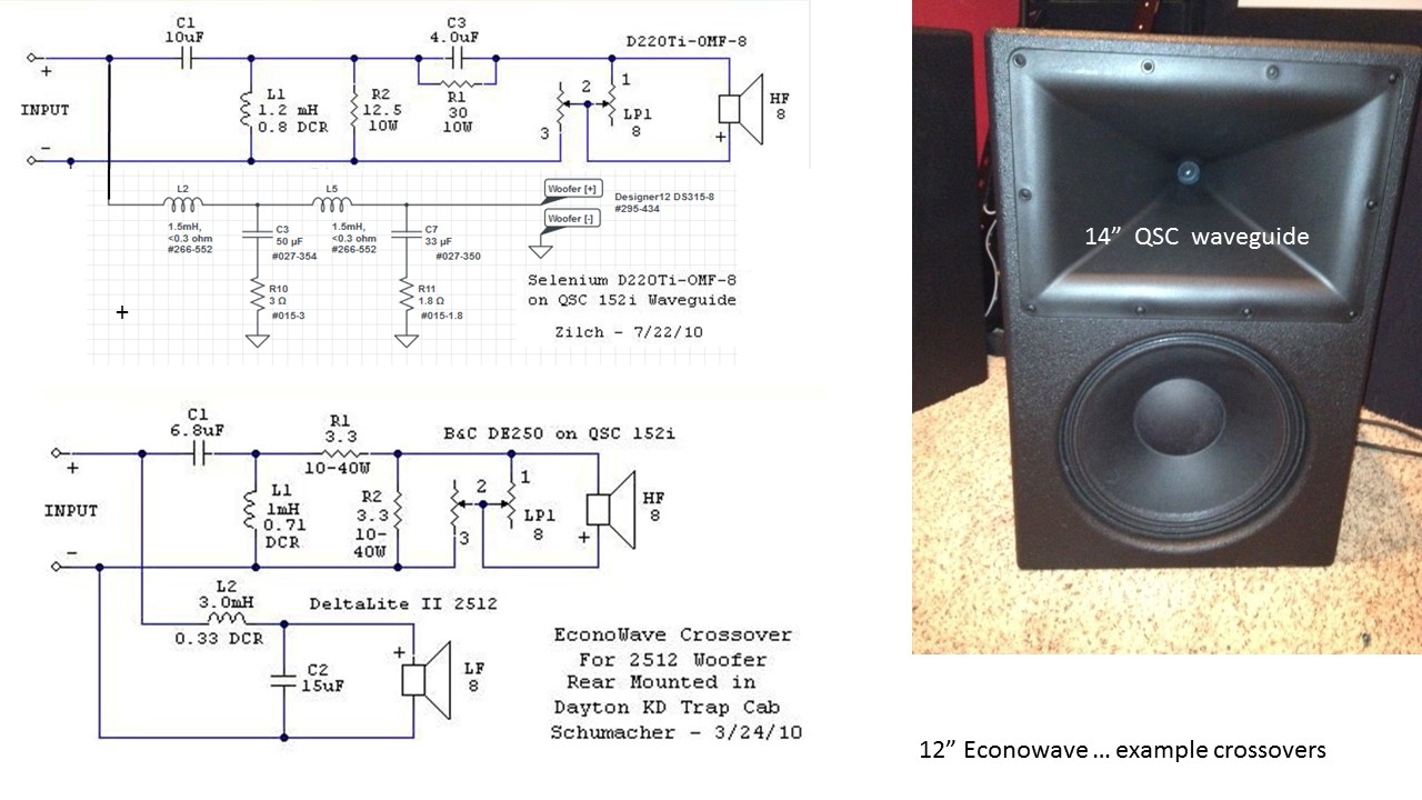

Happy Listening For You ... $350 Parts Only 3-way Speaker Design
---Build the full cabinet, and you have the option to start with a 2-way 12" + 1" CD EconoWave and expand to 3-way when you build a tube amp.
$40 analog 3-way crossover (ebay). Uses 3power amps (or 4 for 1 amp/subwoofer)
-- must solder in a few small capacitors and resistors on the opamp PCB
$160 for 2*Dayton 12" aluminum cone woofers (DSA315-8)
$80 for 1*Dayton 12" paper cone midbass DS315P-8
$64 for Peerless 1" compression driver DFM 2544R00-8
$13 For B52 waveguide/horn(14"W x 10"H)
$357 with free USA shipping .. before Parts Express discounts(often 6% to USA buyers)
If you can increase the budget to $400/speaker parts, purchase the $140 Eminence Delta 12A midbass
