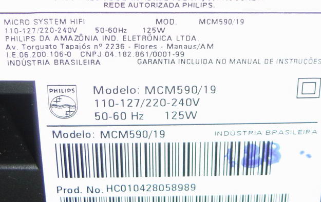

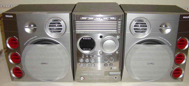

I can understand why you are discussing that matter so deep, and those things will are confused to me too, as i am completely crazy with things happening here, at my home.
I bougth a very good audio system (sorry, not rich) from Phillips, and its power consumption (written in the back panel) is 125 watts... so i expect to have something around 96 watts power...but as specifications are "manipulated"..... "tricky informs"....i will acept 60 watts of sound....and this is perfect in my mind.... very nice power....because those 45 years, i could realize that normal (not hard to move) speakers, goes to limit movement with 4 or 5 volts.....and the heavier ones need 10 to 15 volts...so.....30 watts is OK!....each channel, perfect!
The main problem are specifications...they informed us, power as their top maximum, short time....not even continuous seems to be.... specifications talk in 10 percent distortion....and that distortion is enormous...sounds terrible, it is not more sound, it turns noise!..... and when you go searching, you will find a very small power...i could see 12 watts to a 120 watts amplifier in some Philips Class D chip....and they are making those crazy things with us....mine, with 125 watts consumption, is rated to 200 + 200 watts (they did not tell us what kind of "watts" are those).
This is impossible....125 watts consumption producing more power than consumption....creating energy!
So i connected multimeters....in AC range...good to 60 hertz bass....those instruments can measure with less than 10 percent error, and having some continuous tone, we can avoid problems related to pointer weigth...i tried digital too..... could measure 7 volts over 4 ohms...and, increasing volume, could reach 20 volts, but distortion was a hell, as i use external hi level drive signal, and beeing square waves, measurements loose precision, as turns almost alike continuous.
So, for the good old days ...this amplifier can produce 12 watts each channel, clean watts.... can produce some square crazy wave of much more power.
But this is not what happens hearing....that crazy thing sounds alike 100 watts each channel.... and give a punch in bass enormous...and kicked all my amplifier's s without too much effort, not only in quality of watts produced, as in quantity of watts produced.
So...i cannot understand?....what is going on?
Can i respect those calculations you are discussing to have some idea of the power produced?
I am a hell confused.... those watts i cannot measure with multimeter!!!! HELP!!!

The equipment is heavy...have enormous transformer; 3 X 3 X 3 inches
This size makes me believe in much more than 400 watts.
