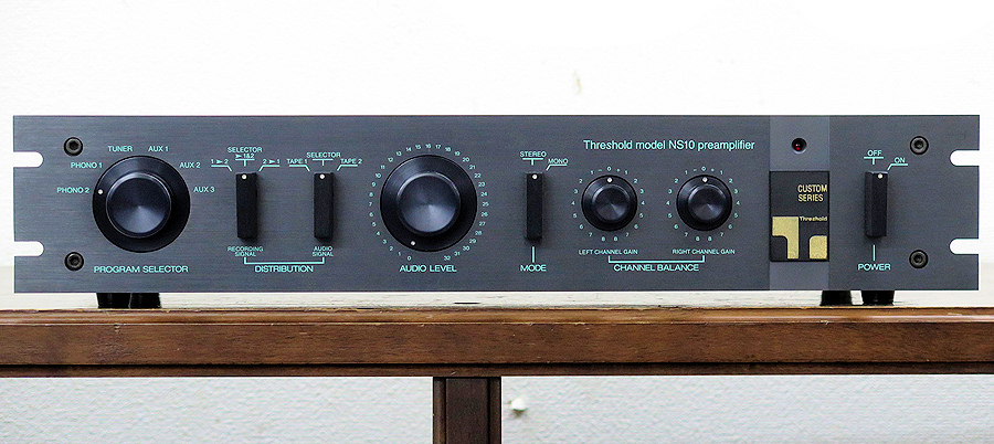

Why not copy the idea Nelson Pass used in his "Threshold NS10" design: use two potentiometers for balance and one more for volume? See image below.

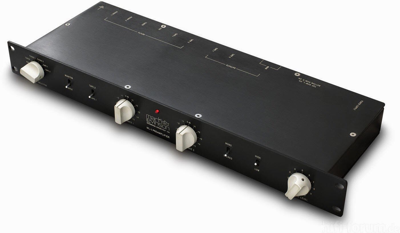

With two independent "channel balance" pots you have independent knobs and independent shafts. If you want, you can set the left one to 30% rotation and the right one to 55% rotation. You can't do that with a dual gang pot having a single knob and a single shaft.
The First Watt B1 with Korg Triode includes two separate, single-gang potentiometers for gain adjustment. One pot for the Left channel and another pot for the Right. Link to review including photos.
A diyaudio member inquired, "When you have dual mono pots without any clicks to ensure same setting of both pots, then you have to do the "tracking" by "eye and/or ear"?"
And Nelson Pass answered, "I would have thought, but I find that separately dialing them up makes you more aware of the balance. It doesn't bother me at all. Perhaps Mark Levinson's preamp had something....."
(Here is a link to his post.)
I've attached an image of the Mark Levinson preamp which I (MJ) think Nelson Pass is talking about. It has two balance pots and a volume pot.

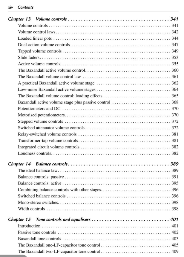

Have a look at Douglas Self's book "Small Signal Audio Design". The 2nd edition has two full chapters about this (ch. 13 & 14), with large numbers of tables, graphs, formulae, and discussion. The publisher's website (Focal Press) has the book's Table Of Contents online and viewable; I took a screen capture image of one page, attached below.
