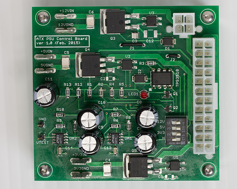

Yes, this is what I mean. I have attached a diagram as well as something I built. Without a load, I can easily and accurately adjust the output voltage with a trimpot. Once I attach it to a load, I will monitor the voltage and temperature.
What kind of load? If it is constant, then theoretically you can change output voltage by altering inductance, or by a phase splitter (hehe, this will kick tha *** of sound quality). But do you really have to alter the voltage? Load will decrease it by 10-40%, did you consider this?
The proper way is selecting the trafo with proper secondary voltage. How much do you think it mismatch?

I really do appreciate you taking the time and answering my questions. I did not ask or mention what I was intending on using it for because that was not what I was trying to find out. I had also previously did my research on replacing the SMPS that a computer uses with a linear power supply. I acquired an ATX power control board which serves the function of an SMPS. I acquired this from Steve (SGX) who was extremely helpful and is currently using it in his music player. I have attached a picture of this board. All that was left to do was to supply the separate voltage.

No, I do not believe it is a constant load. Yes I have selected transformers with secondaries that are very close to the desired Vout. The drawback is the bridge rectifier increases the volts which I would then have to decrease. I was not aware that introducing a load would decrease the Vout that much. I just wanted to make sure it was safe and reliable before I connected it to any thing.
If not constant, then you have to determine minimal, maximal current, frequency limits of the fluctuation, and voltage tolerance of supplied device to determine if your lclc network is capable for the task. It doesnt provide stable voltage, it varies with load, so a simple adjustment can be insufficient.

I am now totally confused! Adjusting the output of a conventional linear PSU by adding a shunt load is a good way to waste energy and encourage significant problems with magnetic induction. Is this supposed to be 'audiophile'?
There is a simple rule in electronics: to improve a circuit you need to understand it even better than the original designer. To replace a circuit with an alternative when seeking better performance requires similar knowledge and experience. SMPS designers know what they are doing. With respect, someone asking about adjusting PSU output voltage by adding loading doesn't know what he is doing, and therefore is most unlikely to end up with a better system.
I remember seeing a thread on here where somebody made an ATX compatible power supply using linear regulators. It was no trivial task too as the finer details make it far more complicated than you would initially think. The rails need to be closely regulated, have clean start up and shutdown, the various rails need to start in a specific order within a certain time frame, needs a standby/soft start circuit to trigger it, not to mention the current demands which can change rapidly.
