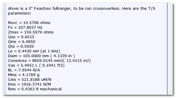

Sounds good - if you want, I'll modify the output filter L/C values to suit the 16 ohm load.I will jump on the occasion to buy a full PCB, if it is built to suit a Feastrex 5",driver, 94db sensitivity, 15min. 25 max. RMS, 16 ohms impedance Full Range speakers.

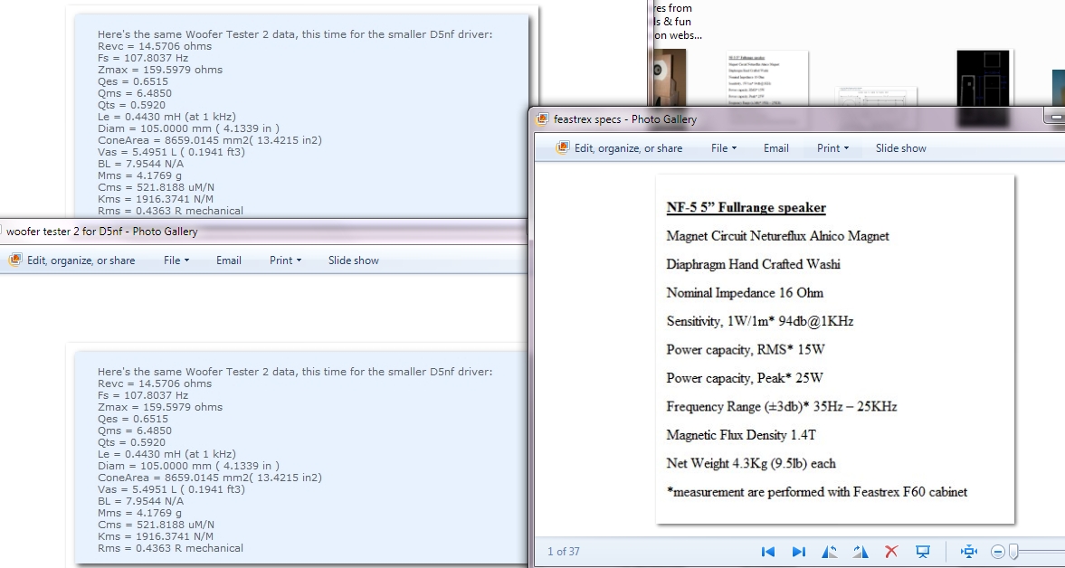

16 ohm minimum impedance, so with Zobel Feastrex is 16 ohm, without probably over 100 ohm at filterfrequency (40khz), adjustable switchingfrequency of this board could be helpfull getting massive peak further away I guess
This is the information i have gathered in time to try to zero in on the driver efficiencies or lack of. Hope there is good information in the photos.
thank you.....
PS i should have added this one also which seem to be more relevant to...
thank you.....
Perfect - knowing the Re/Le values lets me calculate a snubber specifically for it, and then calculate the LC filter so there won't be any peaking.
