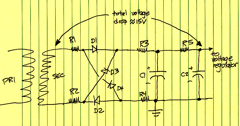

mikolaj612, perhaps you should consider using a transformer with a higher secondary voltage, and include a high series resistance with the secondary winding, and a small first filter capacitor. Then use further RC filtering plus a regulator if needed.
Secondary winding current is then almost entirely resistively loaded, and so you have no snubbering and rf filtering hurdles to jump in your quest. You can then rejoice about having a near unity power factor input preamplifier which effectively eliminates all those nasty rectifier current waveforms and Mhz noise generators and the need to vacillate over which filter will give you sufficient CM and DM attenuation, and how well you have to dampen leakage inductance ringing.
... a transformer with a higher secondary voltage, and include a high series resistance with the secondary winding, and a small first filter capacitor
An obvious modification of that idea is to split the "high series resistance" into four individual pieces, two of them upstream of the bridge rectifier (R1,R2) and two of them downstream (R3,R4). See attached figure. It reduces dI/dt, which reduces the stimulus for oscillation L*dI/dt.
On the other hand, snubbers are inexpensive and, if tuned properly, bullet proof. The Murata PHY isn't terribly expensive either. So ... why not use all three?? If some is good then more ...

Mark, yes using balanced series resistances such as R1, R2 or R3, R4, will alleviate parasitic capacitive current flow between PT secondary, and PT chassis and primary windings. Using a PT ES would also be a benefit in managing such currents.
I get the impression that the OP has fixated on a few technical 'solutions' used by others, without any observation that the solutions are indeed needed for his equipment, or what 'solution' performance level is needed, or that the OP has any means to test whether adding a 'solution' is actually performing as intended.
An outcome could well be that the OP adds all the 'solutions' to his power supply, but in reality poor management of wiring between transformer and pcb, or poor pcb layout, has not really achieved what careful layout could do without those 'solutions'. But I guess the OP would have a smile from a job well done, and relax whilst listening to music without the gnawing thought that parasitic currents flowing in his power supply were negatively colouring the sound scene and consistently distracting his attention.
The proposed alternative of using a higher voltage secondary certainly has the disadvantage of lost power, in this era of switchmode efficiency, but otherwise it does have 'green' merit in that it acts like a resistive load to the mains, and so doesn't continue to exacerbate that flat topping that your post #10 so eloquently displays.

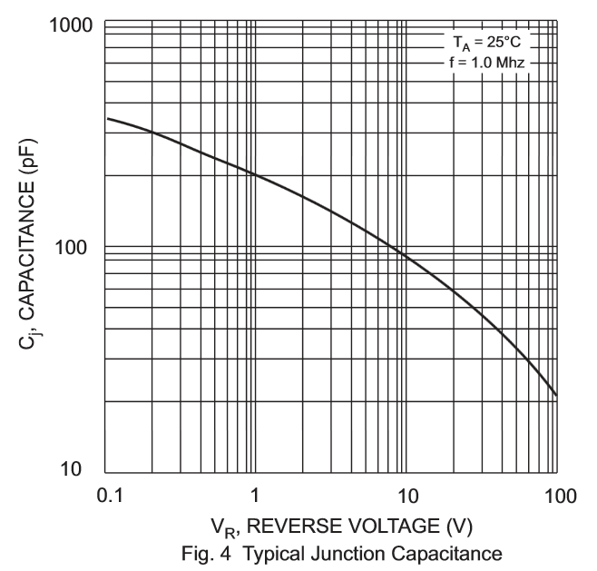

I strongly recommend that when calculating your snubber values, you employ a conservative OVERestimate of the capacitance of each of your diodes at zero bias. For example (the datasheet of the Schottky SB5100) shows a capacitance versus voltage plot in Figure 4. I suggest that you assume this diode's capacitance is 500 pF at Vf=zero.
Since your transformer secondary drives a bridge rectifier composed of four individual diodes, you will have to decide how much capacitance this entire assembly places across the secondary, at the instant of diode cutoff. Is it (0.5 * SingleDiodeCapacitance)? Is it (1.0 * SingleDiodeCap)? (2.0 * SingleDiodeCap)? Since the zero bias junction capacitance of an LTSPICE diode is known (it's SPICE parameter "Cjo" in the presupplied model), perhaps you can run some simulations to help you make this decision.

Experimental reverse recovery waveforms indicate that diode junction reverse voltage starts to be sustained at the inflection of the reverse current flowing through the pn or sbd junction. Given that the inflection point is where the PT secondary winding experiences the affect of the diode switching dI/dt (ie. the toll of the bell), then the reverse voltage of two diodes is starting to increase above zero, and the other two diodes have voltages starting to fall from Vdc. The effective shunt capacitance of the bridge would vary a bit during the time of highest dI/dt, but I doubt the actual experimental snubber 'optimum' values would be very sensitive. Mark, have you seen any in-situ experimental waveforms with a given snubber that purposefully vary sbd capacitance (eg. by comparing waveforms using sbd with different current rating)?
