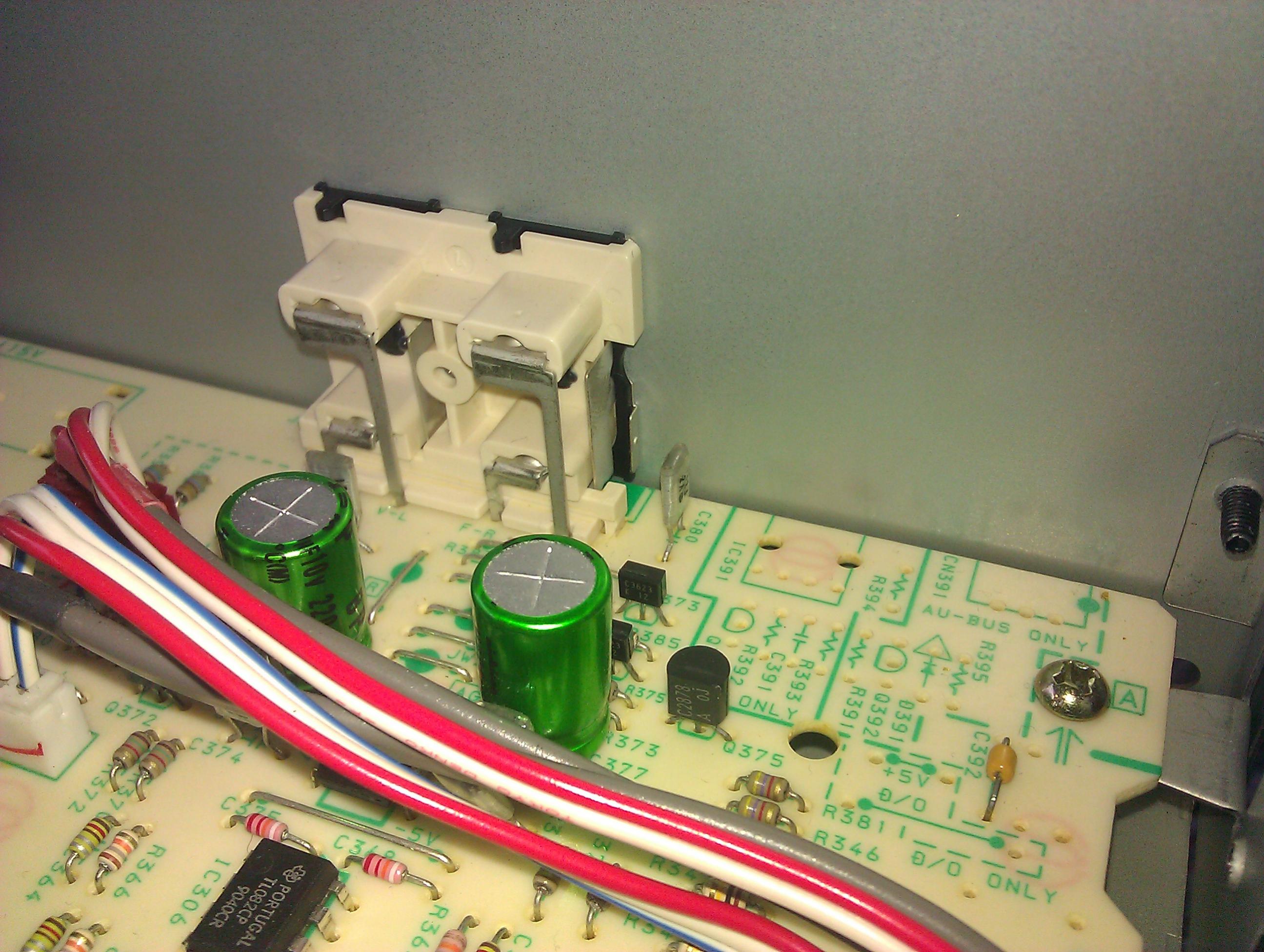

I have been tinkering with a Sony CDP-591, it is class II, so no PE.
The 4 RCA barrels are made from a single piece of metal and bolted directly to the chassis. The circuit 0V/output ground has a very short connection from the edge of the board to the RCA's. What they have done is place small 100nF capacitors throughout the circuit connecting 0V/GND to the chassis.
Then their ClassII (double insulated) construction is relying on the double insulation between all mains connected components never failing by sending Mains voltage to any isolated component/chassis.
That gives a clue to how onerous the Design, Manufacture, Test, and Guarantee is for a ClassII product. And how much more difficult that is to achieve in a metal chassis that is exposed to touch.
