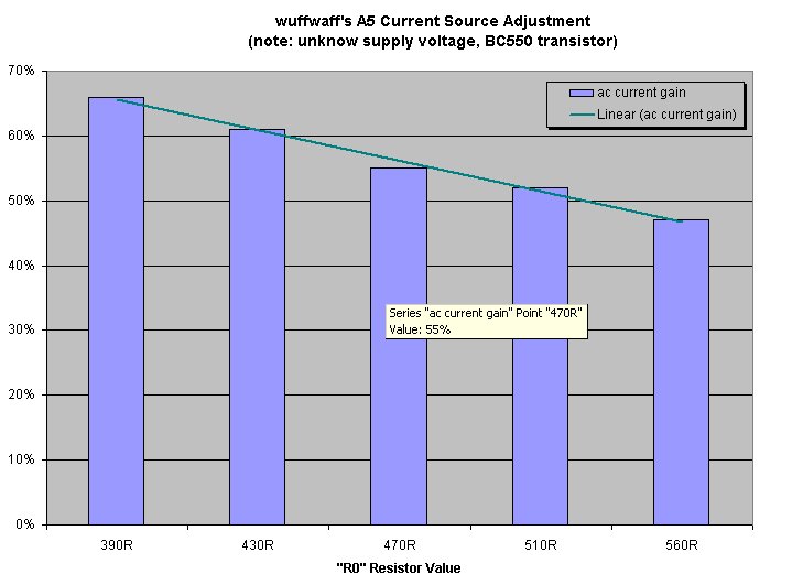

I measured ac-current-gain at a few resistor values for my Aleph5 with BC550C:
390R 66%
430R 61%
470R 55%
510R 52%
560R 47%
I tried this at different bias values (from 1,9 to 2,4A) and loads (4 and 8 Ohms) and frequencies (1k / 10k) and the gain faktor stayed more or less the same. I somehow always thought that ac-current-gain would change with different bias values but this doesn´t seem to be the case......
Between channels there was a difference of around 1%
William

Thanks again William,
I will have another go this weekend and chart the values as they may help others in the future but for now I have used your values to show the relationship.
