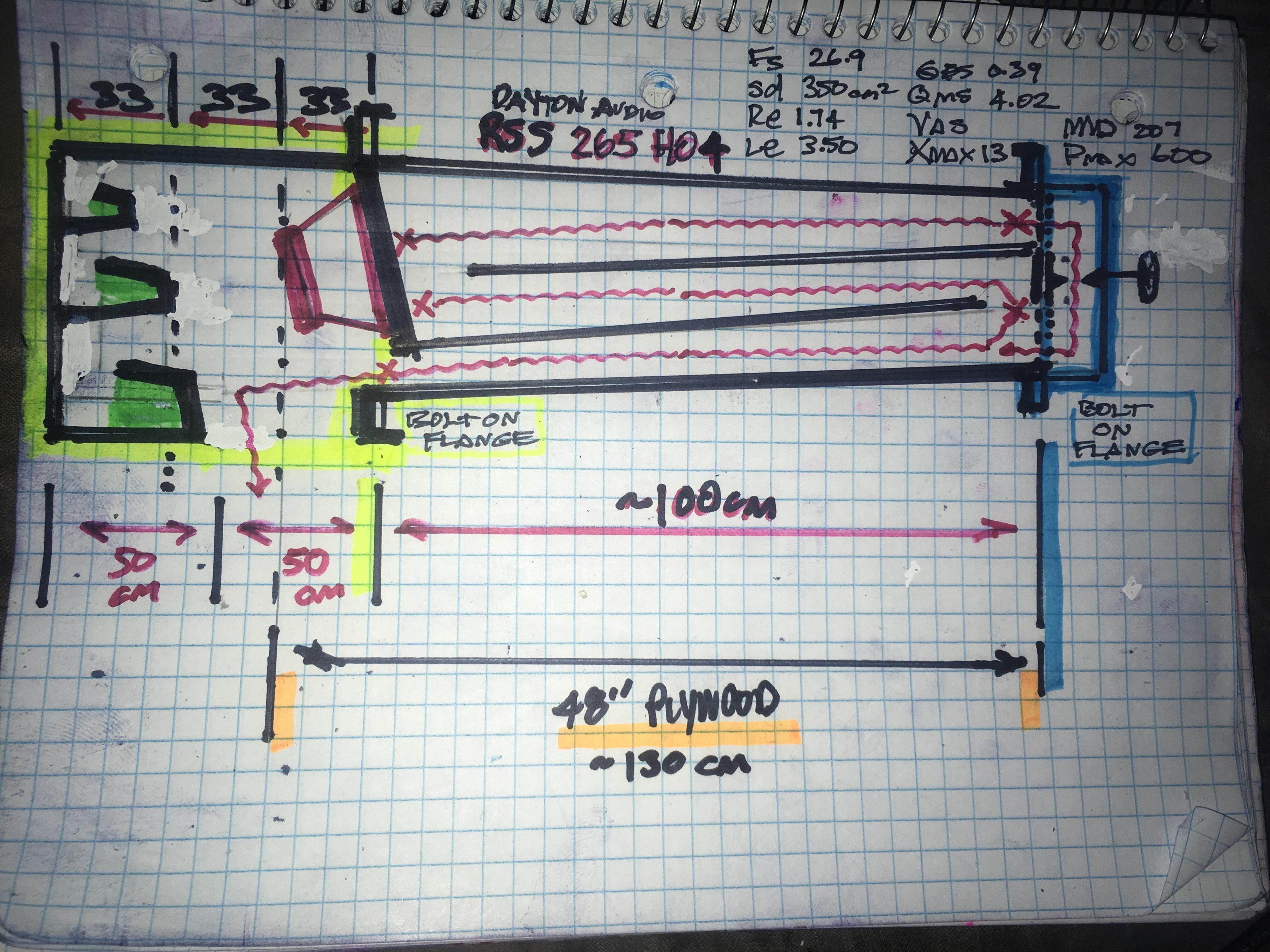

Chasing the idea i can use offset and harmonic intervals in a way that can yield some type of ‘recipe’ that is more useful than attacking a sim software blind or without a base reference to use to tweak and create a ‘character’ or a type of filtered and amplified ‘bonus’ to the 4th order qw pipe in existence already. by massaging the wave in hopes to compliment the front instead of just shove two ill aligned opposites together from 90 degrees at ‘exit’ length and ??
treading water in a rabbit hole during a flood. Thats what this is, throw me a buoy or tell me to sink. its okay, ive still got the original 4th order pipe to use as a decent subwoofer. the rest here is just for ‘science’ or entertainment??
