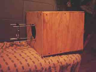

Got bored and made one out of wood - wood
box and focus like the mark 3 - I cant say that I
Would watch that - it was way to dim - I was better
off with a flood light and cheap lcd -
I used the meniscus lens from a OHP - bad -
I used the fresnell from it - split - it did better
but its way to dark - I ether am doing some thing
wrong - or have bad eye sight
It just plain looks bad - I would like to
see one that worked -
Am I using the wrong lens???
Sorry if this is a little thread jacking - but
I to want to know how to make it work
Here is a pic of what I made, it took about 6 hours
- I tried the focus inside and out of the box
- I just put the fresnell center-erd over the hole
when I used it - I was not using both, just one at a time

Ancorp not trying to knock you here but it helps if you can see the image. Ive done about 5 years of fooling around with crt's and there is no way its gonna be bright enough to watch in any decentcy, lol come on now🙂
With projectors a day scene is meant to look like a day scene, the objective here is to have the image as real as possible, how can we have an image as real as possible if we dont have the brightness to back it up? Fair enough about contrast but that contrast is no good if you can bearly see it.
Crt pro projectors are another story im talking about the tv enlarging here. There is also no way that a triplet is going to be brighter then a singlet lens of the same size or focal, a triplet lens will always chew more light then a singlet lens, it comes down to reflection, no matter the specs. You cant cheat science, ive tried, and lost everytime. There is no way a tv is ever going to be bright enough for a decent projection.
