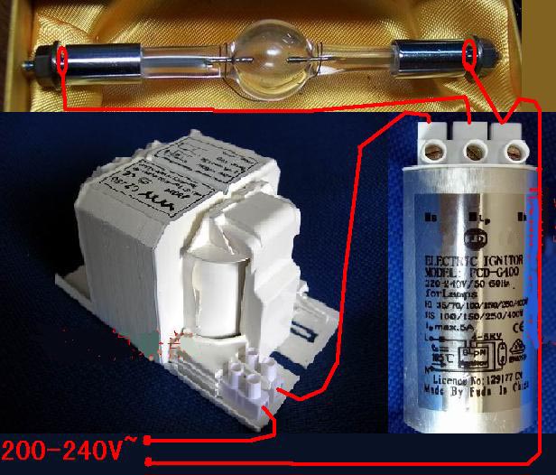

and you there is a condenser too, the condenser is not in your pic, but it is important.
and you can get this short arc MHL, 400w too, work in normal magnetic HQI ballast. point light. only $40 each
