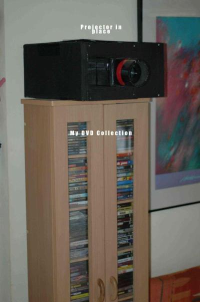

Hi this is a fellow Diy builder in Delhi, so please take my advice as i have finished making a 92" (7 FEET 8inches across) Projector forIts no use hunting for lcd panels as they are hard to come by.resolution is also way below modern lcd screens as you are talking about technology at least 8 years back before lcd projectors came in.you will pay alot for used or busted units that are bulky and difficult to put in a sleek box.
Hack open a lcd screen from ones menant to be installed in cars.
I have just finished my projector in Delhi with a 8" screen from a car roof mount type screen available in wholesale electronics shops for Rs 3,500!! Go for it!!
My pictures are coming up as soon as mods allow it!
Best of luck!
