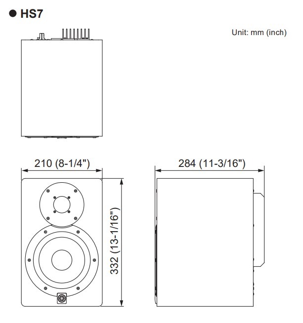

The boxes are made out of 20mm MDF, and are 210x332x284mm giving ~12.8L (internal).
The woofer's center is 6.5" and the tweeter's is 1". And they have a port behind the tweeter that is tuned at 50Hz.
The woofer is at around 120mm from the bottom. The tweeter is at around 65mm from the top. Both speakers leave around 10mm from their own edge to the speaker's edge (end of tweeter waveguide and woofer plastic bezel)

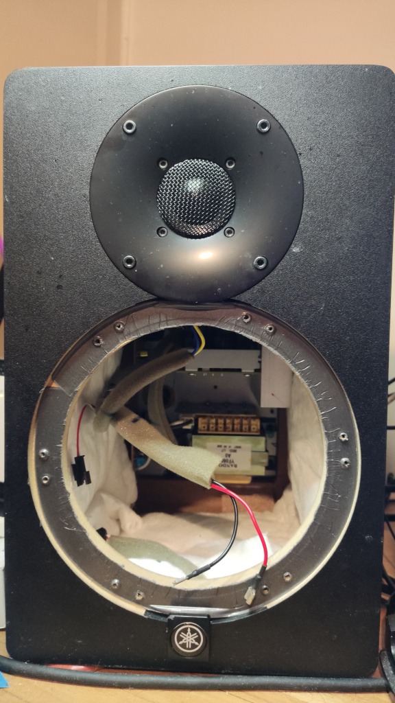

The vent is around 40mm in diameter and 170mm in length. I understand that it's thinner than most vents, and has a weird resonance at around 600-900Hz. But I guess the backplate and the vent are probably the easier things to replace and redesign. And I would definitely prefer it over replacing the front baffle which would probably be a no-go since it would also require a refinishing of the entire speaker

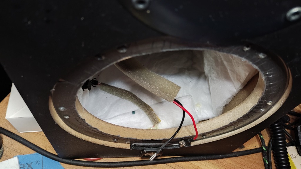

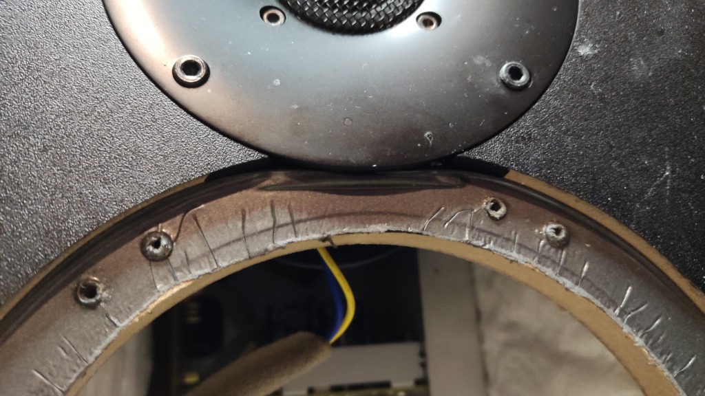

The woofer also sits 5mm lower than the front baffle. From what I understand Alpairs are designed to sit on top of the front baffle and not inside or flush with it? In which case I could cut some 5mm mdf or plexi rings to bring them to the right height.
Here are a few from the front, showing the woofer cutout. I don' think the other sides are very interesting. And I just noticed that the depth dimension I had included the heasink and front plastic bezel. The external depth is actually 250mm or 225mm internal, giving 11.17 liters

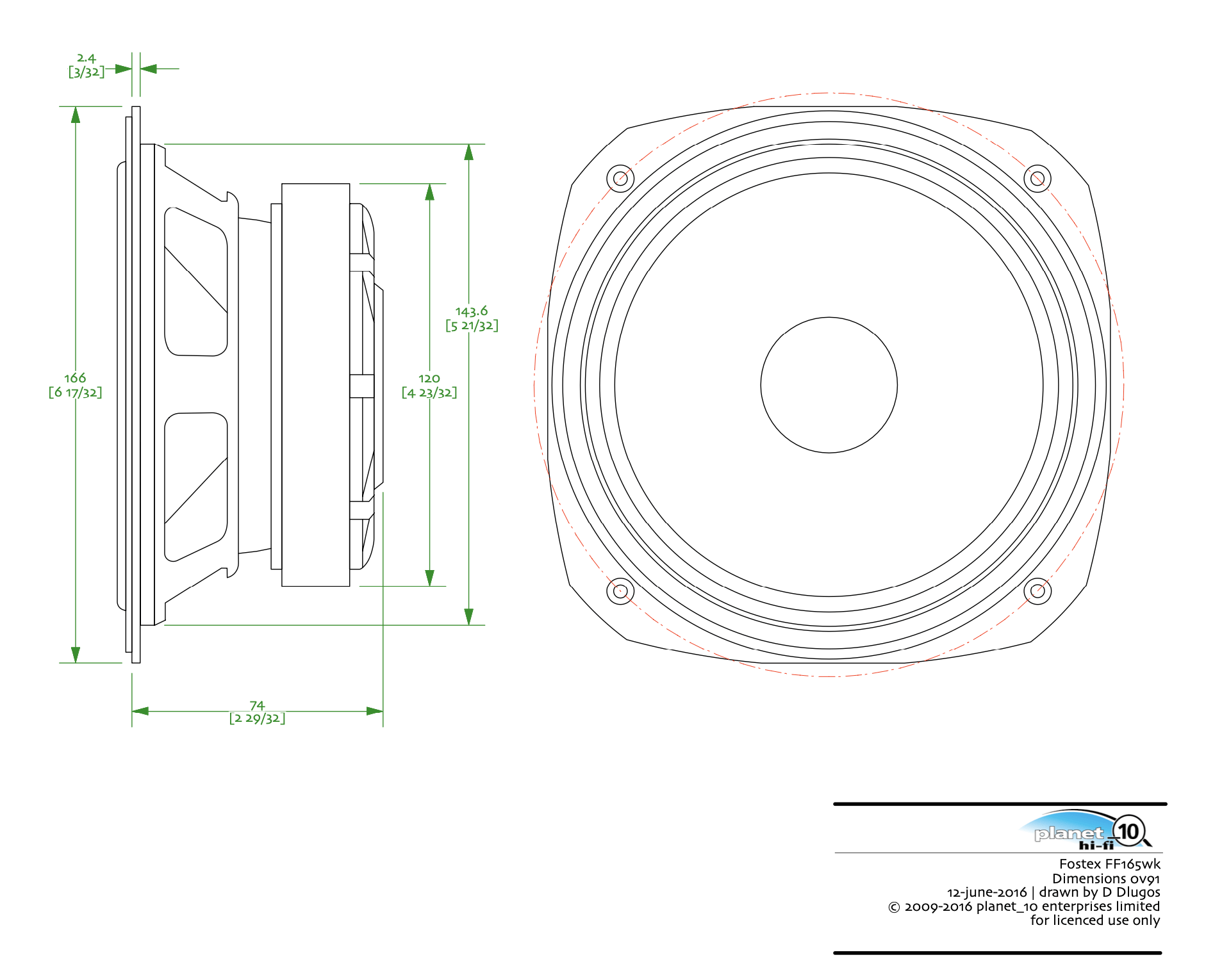

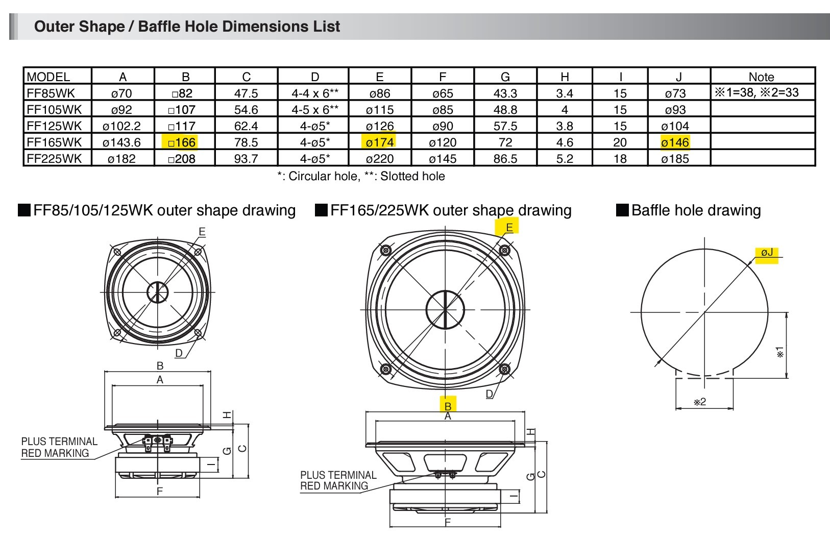

Fostex FF165wk has a bigger bolt circle, not as large a cutout, and a non-round bezel.
The pdf gives a cutout of 146mm. Does it have to be precisely the defined diameter or to be that close to the body of the speaker?
The bolt circle is 174mm so it falls on the existing routed slot. The non round bezel is 166mm on the small dimension, so it will cover the cutout. Unfortunately the pdf does not give the diagonal, so I don't know if it will fit inside the 183mm. What I can do is cut a ring that would bring the routed slot to be flush with the baffle, and then the speaker can just sit on top of everything.
