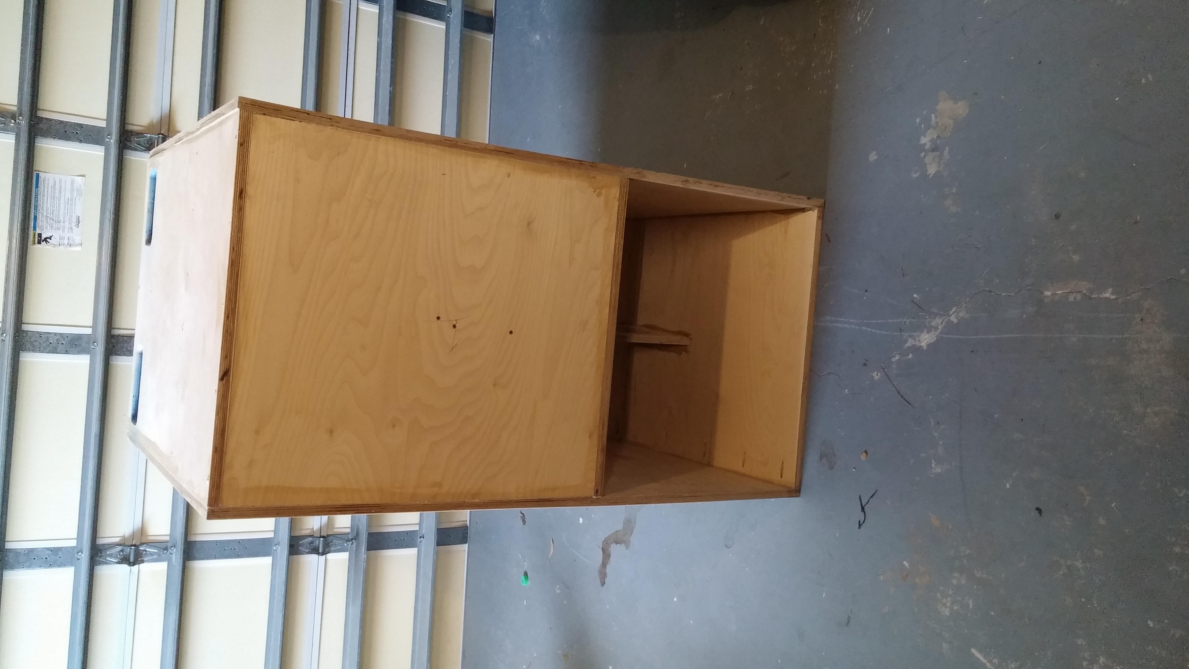

Picked up some baltic birch today. Still need to select horns/drivers and decide how I want to build the tops. Not a lot of DH1a's on ebay, the ones listed are much more expensive than what is shown on "completed listings" so I may just go with a 1" exit driver.
Sub is almost done. Need to do some sanding and painting. Fun project and tested my skills to get all the bevels right with a $40 ryobi circular saw (with a lot nicer blade than came with it)
Any suggestions on enclosure volume/tuning for the tops with the Dayton 310-8 12" driver? It would make sense to tune them to be useable stand alone or with the mega sub.

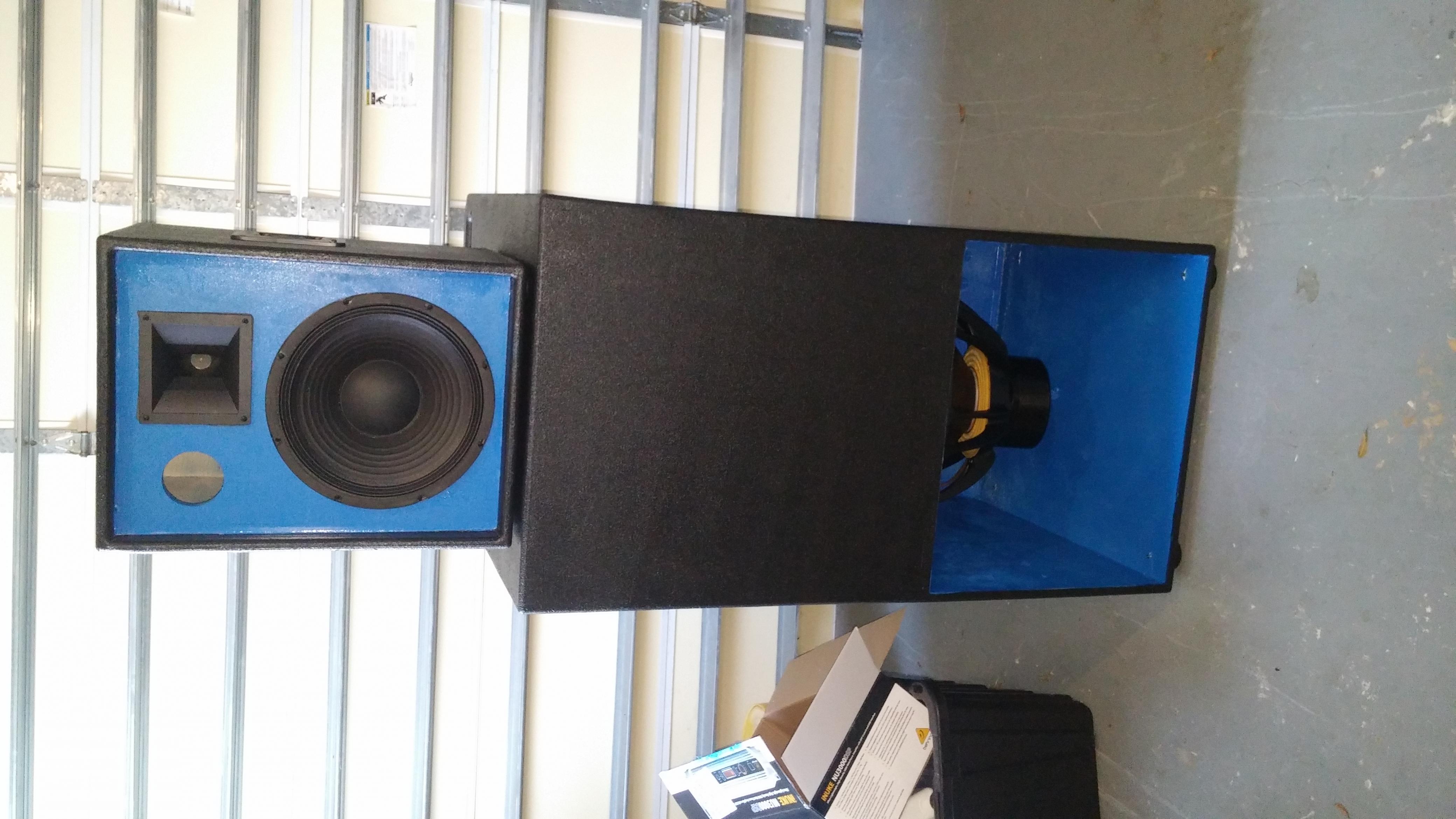

The sub is basically done along with one of the tops. Have briefly played around with it in the garage. Sounds decent together but need more time for a proper assessment. Can't crank it much as I don't want to annoy my neighbors.

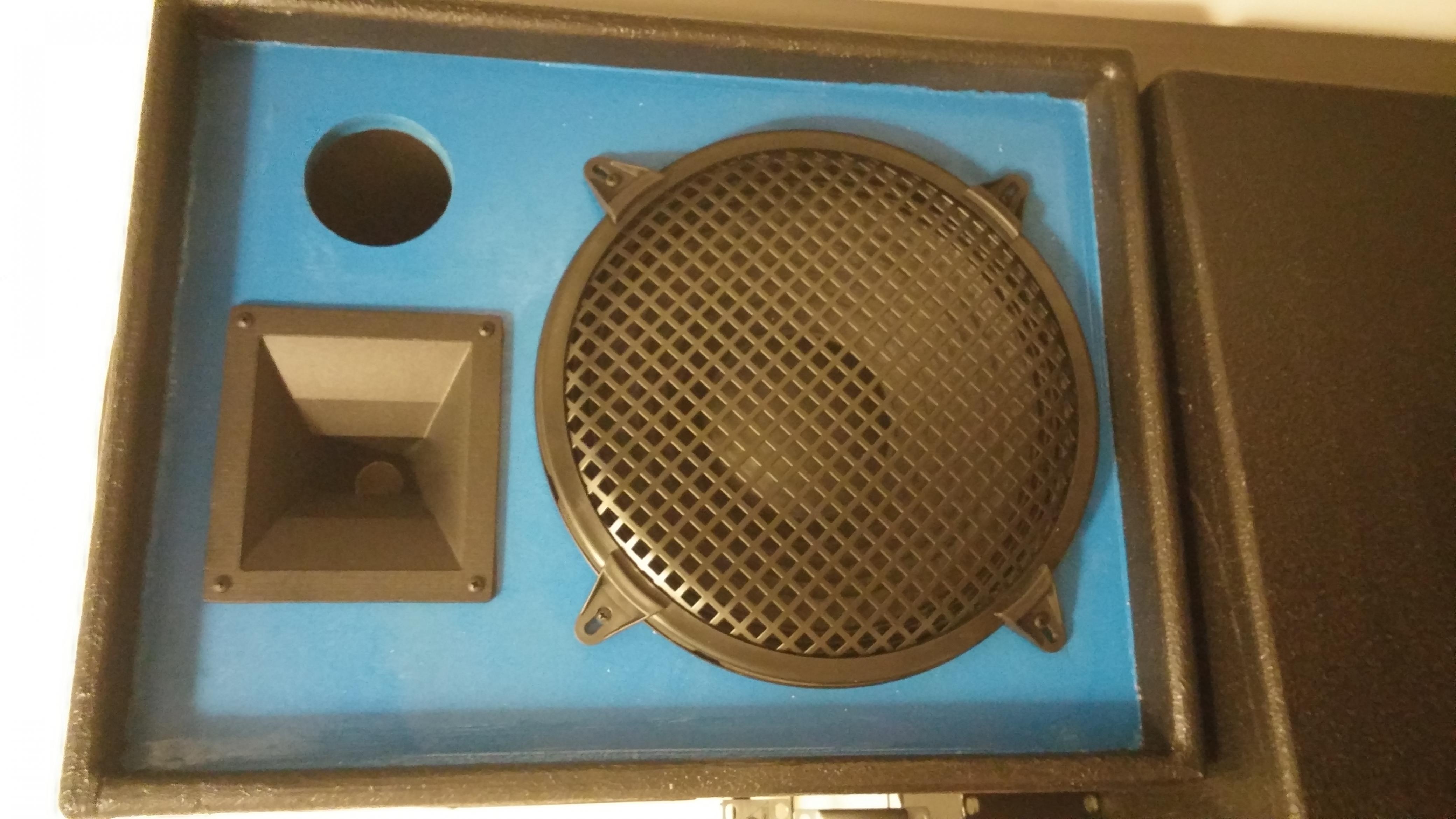

Was borderline unhappy with the Dayton PA310-8 there was a few resonances that just made it sound off. I figured it might be the enclosure so I got some acoustical foam panels from amazon and lined the inside of the enclosure. Much happier with the sound. I do have to add quite a bit of boost to the low end to use the speakers without the sub. Also I resigned myself to using the ugly waffle grilles as they are off the shelf and inexpensive.
