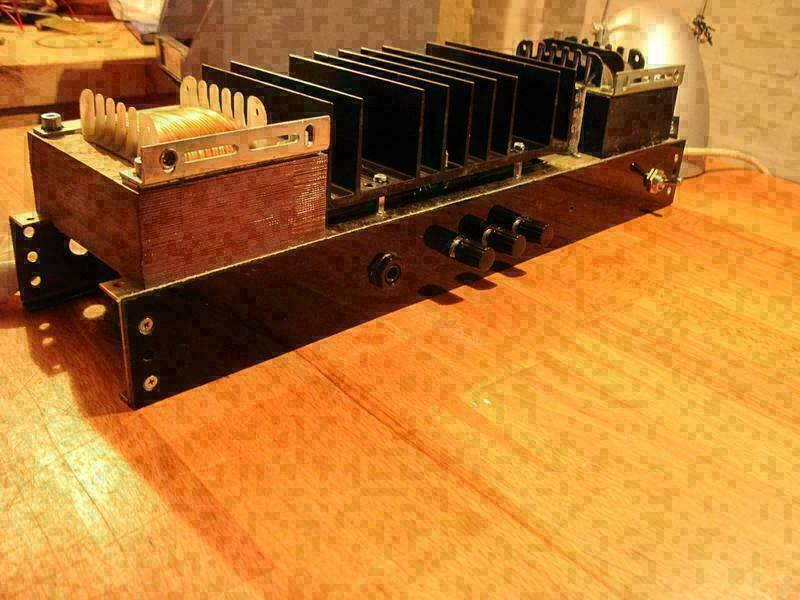

I have a thing for light weight amps now, been thinking about it for a while. Many ways to skin a cat though..
Small light weight amps are good for many things. Many years ago I made a 3 watt tube amp that went inside an electric guitar. It had a 4 inch speaker and ran from a 7.2 volt nicad battery from an RC car. Today we have lithium ion and bluetooth wireless. If I make another tiny amp that's on the menu.The tube amps you have are too heavy and loud......I threw together a 25L6 amp......
This little amp head chassis weighs less than 3.5 pounds. The cabinet weighs about 1.5 pounds. It makes 4 watts. The entire cost of material for this amp was under $50 when I built it. Some parts have gone up, especially the transformers. When used with my small speaker cabinet that contains a pair of 6 inch Parts Express speakers it is very loud in an 1800 square foot basement. maybe it's worth spending a few $ to get a transformer that's known to work.

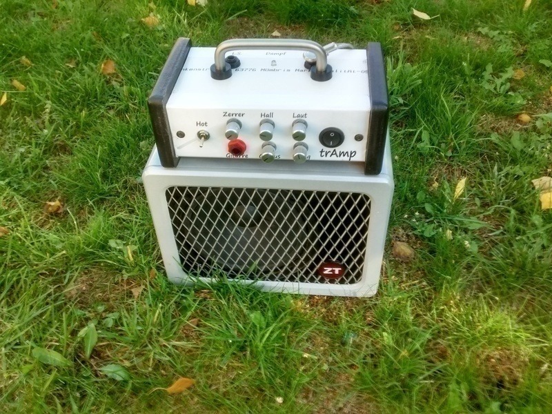

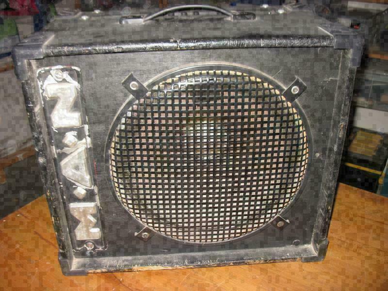

The little 4 watt 4 tube amp that I mentioned earlier is seen here on top of my budget "test speaker." The test speaker was made with a pair of somewhat inefficient $20 "Pro Audio" speaker drivers and a $15 "bullet tweeter" for testing high powered amps. I used cheap stuff so that I wouldn't cry much when I blew them up. Over 10 years later they still rock. The tweeter is mostly hidden by the guitar's neck, but part of the "bullet" can be seen just below the second fret. There is a switch on the back of the cabinet to turn the tweeter off. This is absolutely necessary when cranking even the 4 watt amp to 11 to prevent your ears from bleeding due to the HF content and I'm using a $5 OPT.

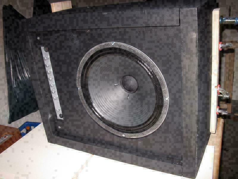

It was a push-pull stage with 2xBZ11 that were configured as voltage controlled current sources. The output iron was a M84B laminated core with two intertwined primary windings, wired as a center tapped primary. Hand wound with 2mm dia magnetic wire. And that was all. The speaker was connected directly to the driving drains resulting in about 30W into 8 Ohms feeding with a 12V car battery and about 100W with the 20Vdc supply.Tell me more. What was your output topology? What were the turns ratio on your output transformer? What voltages were you running?

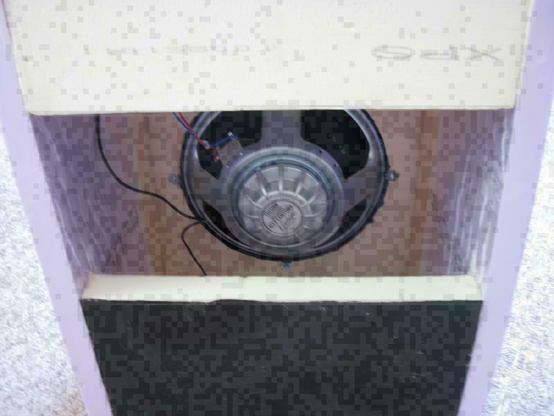

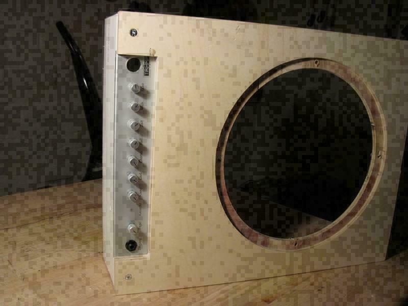

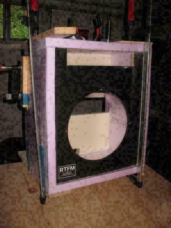

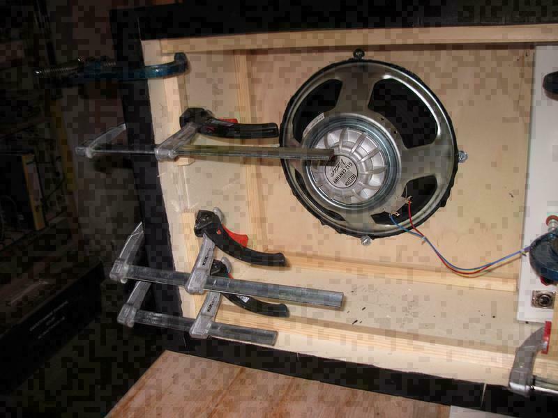

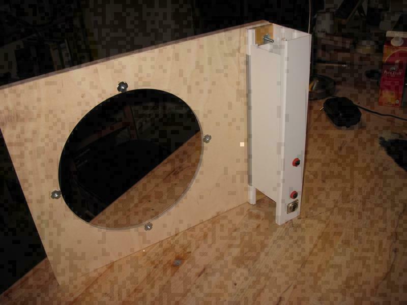

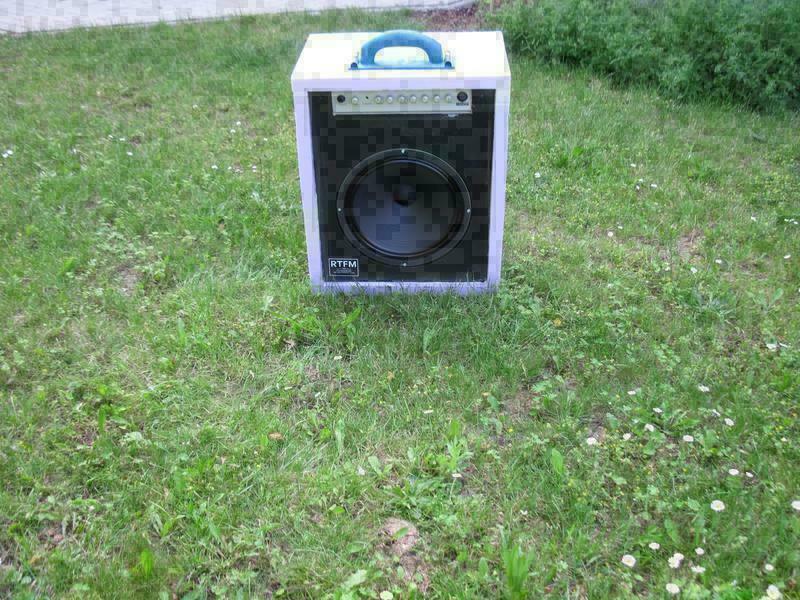

I've been wanting to do that for years. 🙂...I build an amp with ...a foamcore housing
Care to share any details on how you built the housing (cab)? For instance, what did you sheet the foam with (thin plywood?) How did you join the foamcore edges to make the cab? What sort of reinforcements did you add to carry the weight of the speaker and electronics? Et cetera. 🙂
-Gnobuddy
Usually wood baffle, foam core sides.
essentially Just a mold for the fiberglass fabric and resin
which makes it work.
Could be anything cardboard or foam
just a fiberglass enclosure.
Bass player forums use to be full of foam core builds.
Not much different than plastic commercial pa speaker.
Except Diy dont do injection molding.
So you have to build " a box" out of something
and cover it in fiberglass.

The front was regular baltic birch plywood that gave a good deal of stability. Glued it with regular white colle. There was no edge protection at that time - a big mistake! Besides the light box the amp is a light version as well, housed in a plastic cable tube.
