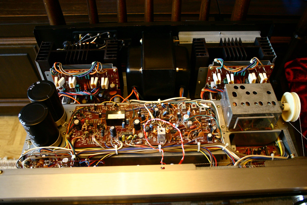

I'm thinking of building a stereo power amp based on Bob Cordell's error correcting MOSFET design.
For maximum laziness, I'm thinking of removing the power amp PCBs and power BJTs from a 1970's era receiver and replacing them with the new amp (probably built on proto strip board) and power MOSFETs. The idea is to reuse the existing heatsinks, power supply, chassis, and the entire tuner and preamp sections of the receiver. Optionally you could tune up the preamp by deleting tone controls, deleting coupling caps, and upgrading to a modern opamp. You could also use the existing speaker protection relay circuit.
Has anyone done this?
I guess the hurdles would be--
1- Identify a receiver or integrated with separate PCBs for each power amp that could be easily removed, and plenty of room for a replacement. Sanyo JCX-2600 or Onkyo TX-6500 mkII could maybe work? This is the Onkyo, look at all that space!
2- Identify a proto strip board that can fit in the target unit. Like one of these: https://www.futurlec.com/ProtoBoards.shtml
3- If the heatsink is set up for TO-3 output devices, identify suitable MOSFETs that come in TO-3 packages.
4- Can the amp design fit on the proto strip board selected?

Maximum economy may be. You didn't mention anything about transformer voltage rating. That's the first thing you have to check. Cordell's have dual secondary transformer requirement. That's difficult to find in cheap amps. At least you have to add small transformer to lift the voltage for the driver/input stage. Maximum laziness?? I can tell you from experience that the chance you will complete this project is very small. Need huge effort here.

The Onkyo TX6500 II is already a decent 2 x 100W amplifier with dual 55V rails, uses well respected low noise components and after a refurb. with new caps, would sound great. The limiting factor will more likely be the parts you aim to keep, such as the old tuners, preamp, controls and and the wiring, which is a big factor in noise, crosstalk, hum etc. with all-in-one products.
If you like the style and functionality of this one, keep it as is. Transplanting the best SOTA amps in there will not only be inordinately difficult as Jay points out, but much of the benefit of improved amplifier designs will be lost in a receiver. That's an opinion of course, but I've done this myself and seen others try it to no benefit in big Akai, JVC etc. receivers. I'm just giving you my 2c to let you consider the practical aspects of putting the cart before the horse, electronically, so to speak.
The beauty of these old products is in their originality and those amps aren't really all that bad. See the service manual details here. If you have an amplifier that you want to completely gut, that's a different matter and you can make a much cleaner, low noise start where the quality of modern amplifier design and simpler, well separated power arrangements can be made to work together for better performance, as they should. 🙂

The amp boards are attached to the heat sinks.
layout your cordell amplifier single channel boards matching the output transistor and mounting positions on the heat sinks.
you can also place connectors in the same places. not as important as the mounts. The middle board is likely the tuner replace caps if nescessary.
Replace both the large caps with equal or greater values of voltage and uF.
the 50v supply can come from a voltage doubler and regulator off the main output winding of the transformer. this may require another smaller custom board.
