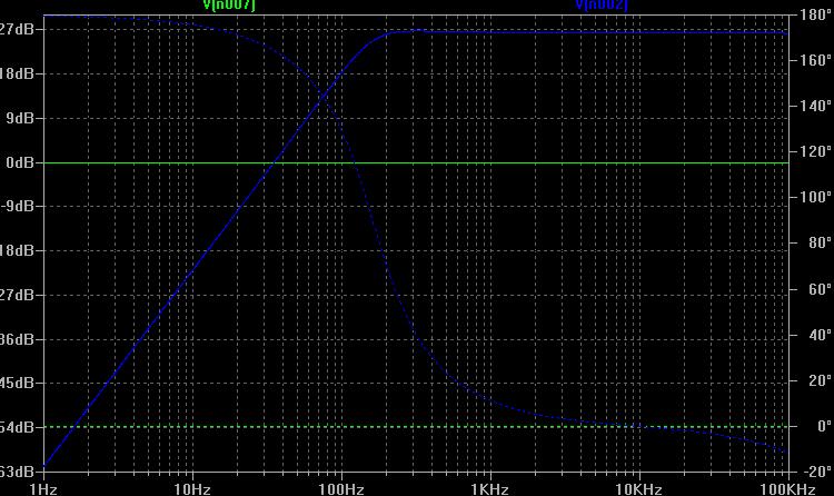

I've been thinking about doing this for a while. I wanna build something like the Keiga 2.1, except chipamp based. Targets:
-Single stereo input (RCA or 1/8")
-Summed (stereo>mono) lowpass filter to subwoofer amplifier.
-Highpass filter to bookshelves/mains/small computer speakers
-Linkwitz Riley 4th order crossovers all around.
-Single chipamp for each top (or a LM4780 half for each side)
-Chipamp based amplfiier for sub (2 parallel or 2 bridged, or 4 bridged-parallel).
Tentative crossover is attached. Uses 12 opamps, to be determined. Pulls a LOT from sound.westhost.com
I'm currently thinking point to point since I've never done PCB prototyping, but I dunno how well that'll work.
R and C are chosen for crossover frequency. Right now I'm thinking ~120-160 Hz, kind of high but I'm thinking about using CHR70's from Markaudio/CSS. Sub is some small 8"/10" (Tang Band or Dayton Reference or something from CSS)

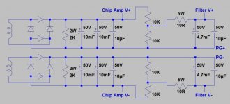

For the op-amps I was thinking in terms of the CRC style Pi filter (4 caps and two resistors in a split supply). Easier than using inductors. The right values would depend on the specifics of the op-amps used and the rest of the power supply, but a crude rule of thumb is 470 uF per cap per op-amp. So in your circuit’s 12 op-amp case 4,700 uF caps and something around 10 ohm 5 watt resistors (while not needed for normal operation, using the bigger resistors gives the supply some tolerance for grazing shorts). It also usually helps to parallel the output caps with some smaller value like 22uF. Some people also tack on a small value film (around .1 uF) cap, but in my experience that’s a case-by-case sort of thing.
For typical power amps I just use a regular bridge/capacitor power supply. High current inductors are just too bulky for my taste, and resistors cut into the available power to some degree.

The power supply looks similar to what I was thinking of. Dividers for applications like your x-overs probably aren’t the best choice, the load can vary too much. In that situation it’s better to use a separate transformer/bridge/filter for the x-over. If you have to run the low level stuff from the power amp’s main supply, then using regulators is the way to go in that case.

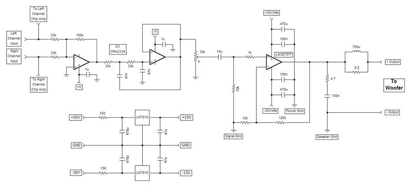

Something like this is what I had in mind(below.)
I used a similar setup for several years, and was quite happy with it considering the minimal effort involved to build and tweek it.

kaos said:The power supply looks similar to what I was thinking of. Dividers for applications like your x-overs probably aren’t the best choice, the load can vary too much. In that situation it’s better to use a separate transformer/bridge/filter for the x-over. If you have to run the low level stuff from the power amp’s main supply, then using regulators is the way to go in that case.
I think this'll depend a lot on the transformer I'm using and the opamps (and min/max rail levels) that I find. I'll avoid the resistor divider though. If I use regulators, each opamp shouldn't take more than a couple mA right?

Mostly nearfield, but ideally with the capability to get decently loud if necessary (movies and such, watched from across the room).Michael Bean said:Do you intend to use this setup for near-field listening like typical computer speakers are used, or did you have something else in mind? If that is the case, and you plan to keep your hearing intact, a small full-range speaker in a sealed cabinet designed for that kind of use shouldn't bottom out. Keep in mind that nothing about this hobby of ours is set in stone, keeping it as simple as possible (but no simpler!) will generally give the most rewarding results with the least amount of effort invested.
I'd like at least a little bit of highpass on the mains. Still debating between simple AC coupling (thanks pacificblue), separate active filtering (original plan), or possibly building Sallen Key into chip amp design.
What's the parallel LR on the output to the woofer? Some sort of additional filtering?

Would this work with the LM3875?
You'll have a massive offset of at least 800 mV, and quite probably more, with those values. To keep offsets to a minimum R13 needs to be coupled to ground through a capacitor, and R14 needs to equal R12. The 200K for R14 is also too large, it'll make for extra noise and stray pick-up, not to mention sensitivity to stray capacitance at the inverting input of the amp. The input at C4 will also need to be driven from a low source impedance, like a buffer, to even have a chance at stability. The non-inverting input may also need a "base stopper" resistor, as they're sometimes called. Not sure about that one though.
pacificblue said:Use it AC coupled and choose Ci and Cin with values that give you the roll-off you desire. They provide a high-pass filter without the need for an additional crossover stage.
