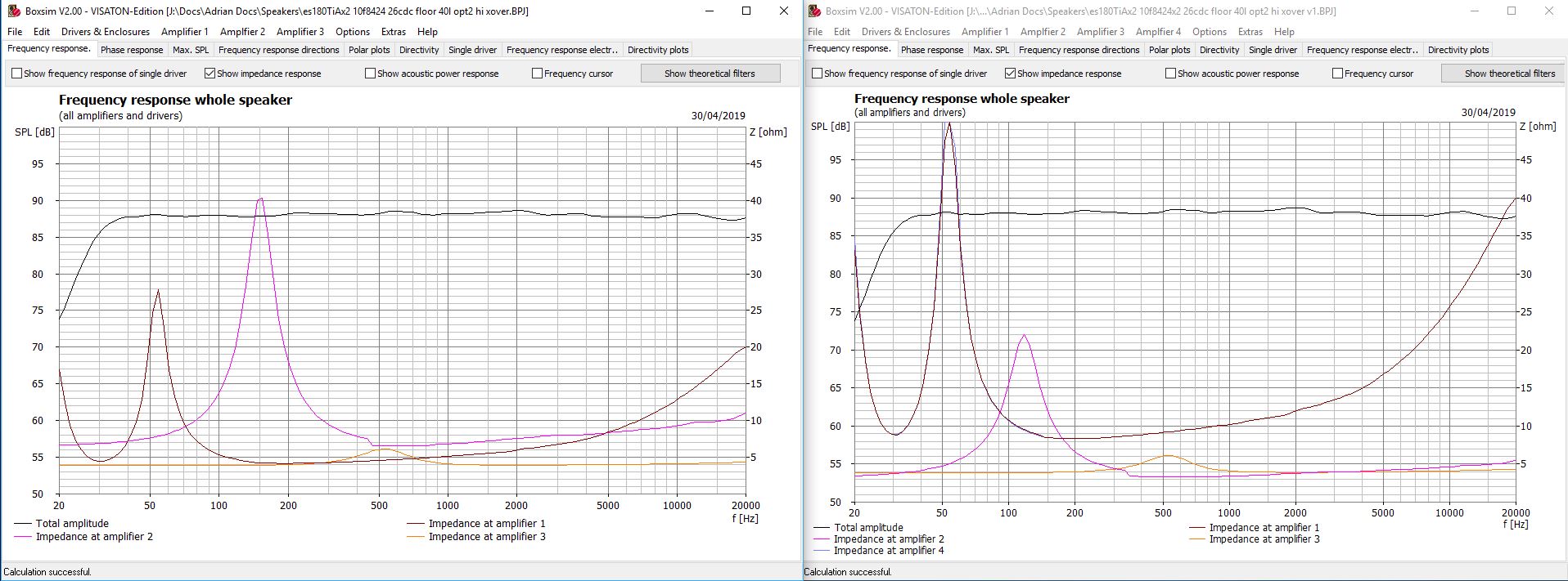

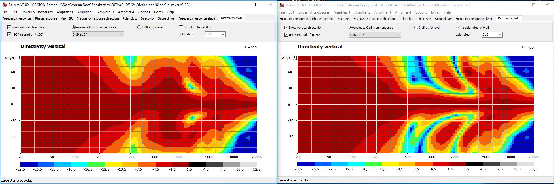

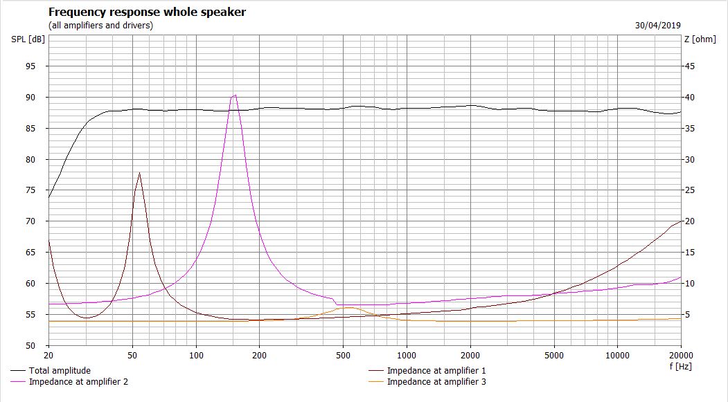

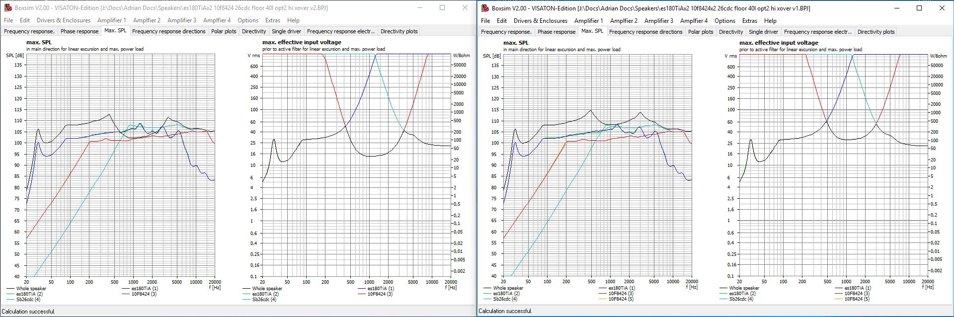

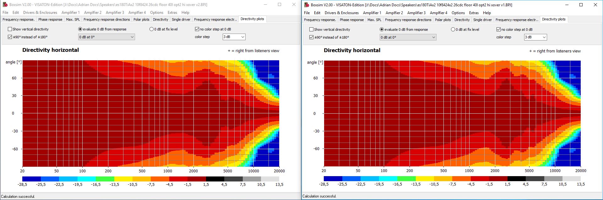

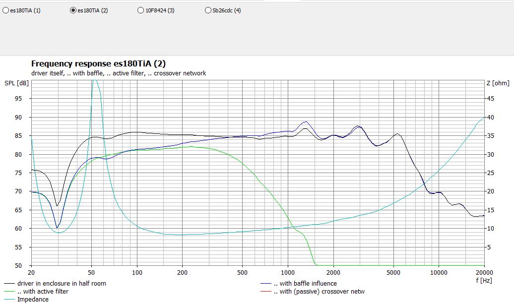

Paul Kittinger designed twin ES180TiA in an MLTL which calculates out to approx 44l without taking into account the drivers and bracing (37.5” x 8.5” x 8.5”) so looks like that concurs with my 40l plan, which is reassuring.
Quote “The modeling predicted an anechoic F3 of ~32 Hz, F6 of ~29 Hz, and an F10 of ~26 Hz. An output of 104-105 dB SPL range (at 1 meter and before BSC) was predicted with an input of ~40 watts, which creates an excursion of 15% greater than Xmax at 48 Hz and a peak port air velocity just under 17 m/s at 30 Hz.”. Again this seems to concur with my Boxsim models broadly.
These were with the original version though.

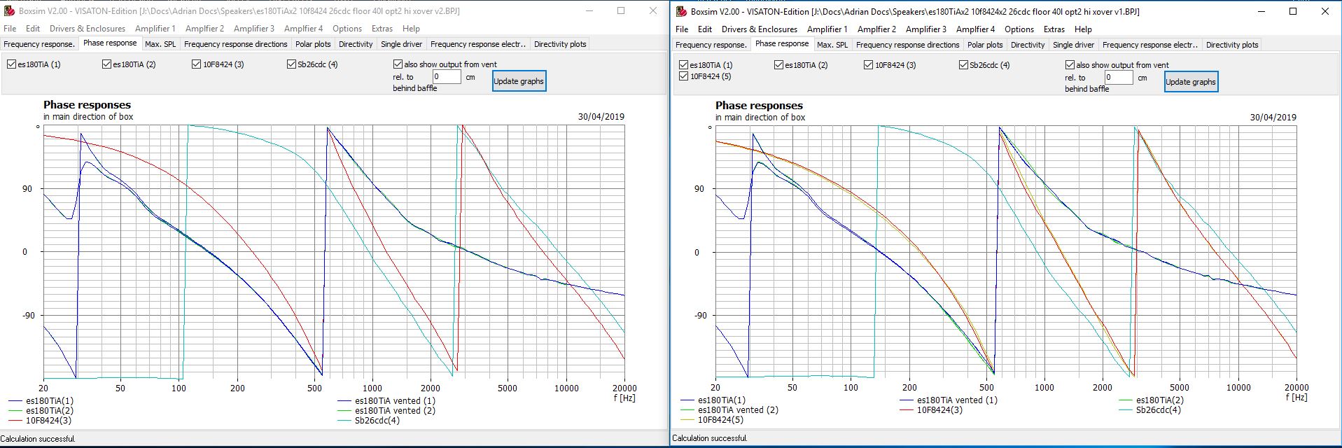

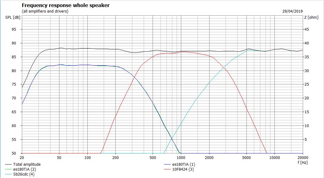

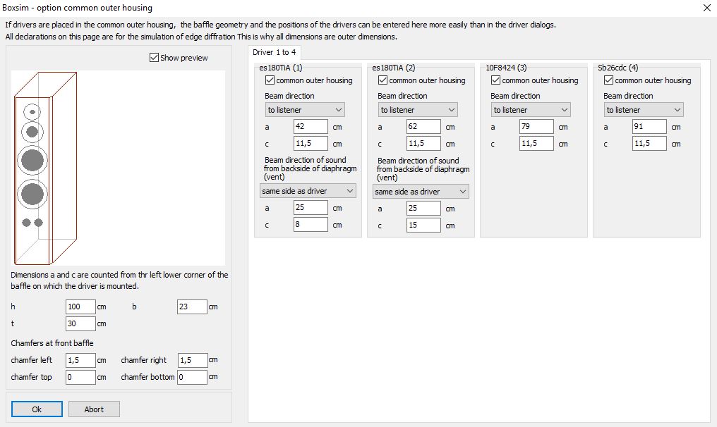

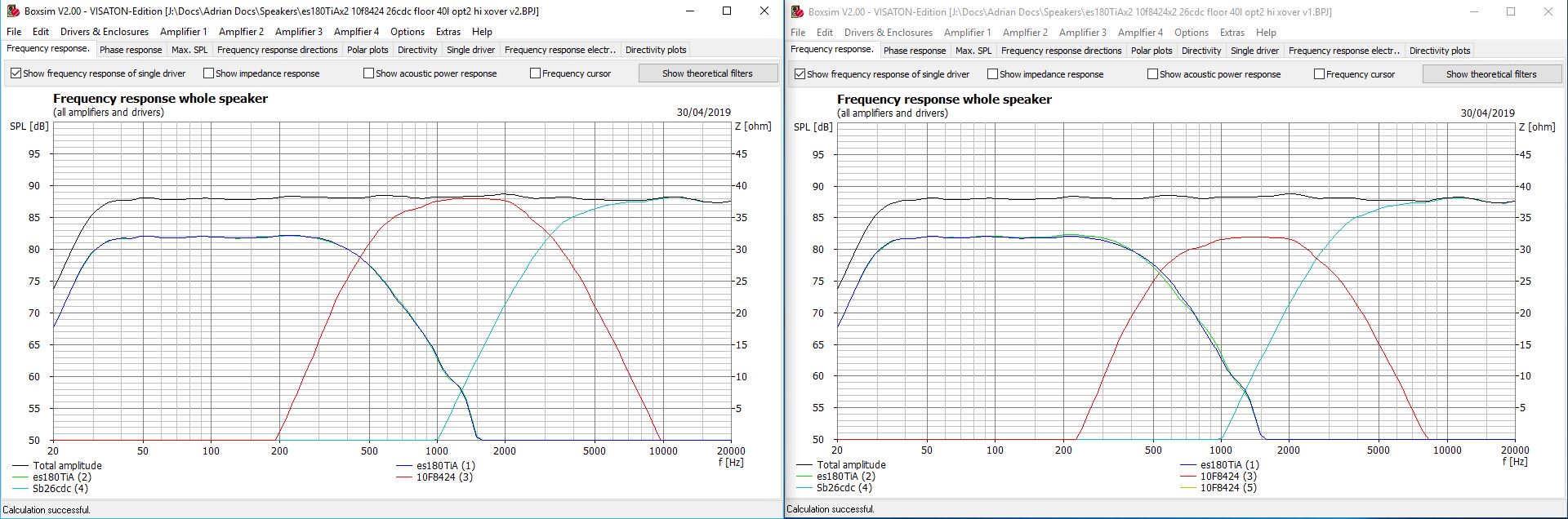

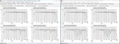

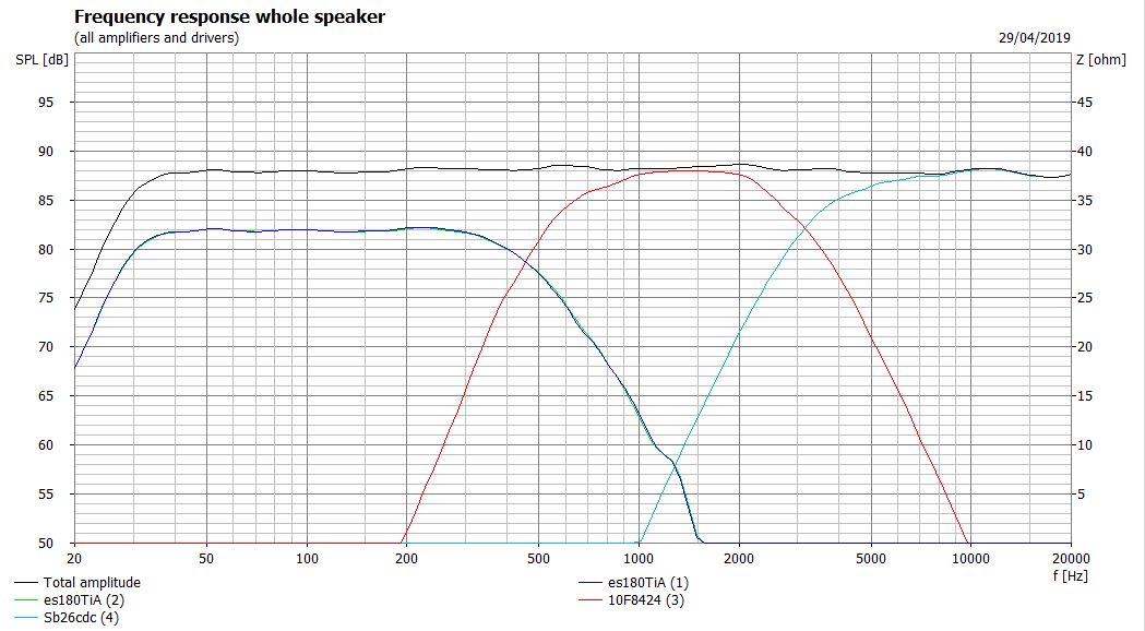

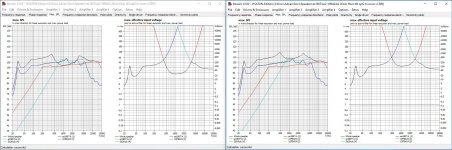

Spent last evening doing abit more refining.

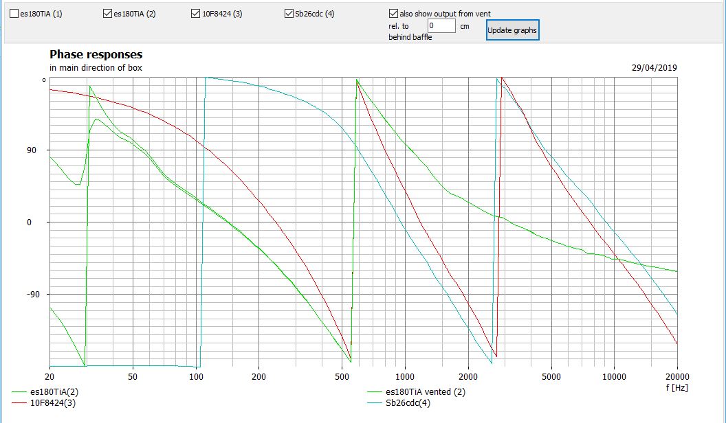

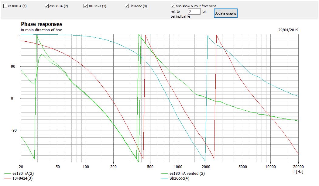

Biggest change is in the type of crossover filter. Read the Minidsp manual and found that they only use LR and Butterworth whereas my previous models used a 2x2nd order filters.
Other changes were - move to 2.5l mid closed box, change the spacing of the drivers to the minimum I think I can get away with and double checked the input data (all ok).
So the following are the inputs -
Woofers
LR6 lowpass at 350Hz
Parametric notches at - (Hz/Q/dB) 45/3/-1, 65/3.75/1.5, 240/2/-1
Gain 0dB
Mid
LR6 highpass at 390Hz
LR6 lowpass at 3750Hz
1st order high shelf at 1000Hz, -4db
Delay 0.07ms (2.5cm)
Gain 3.25dB
Tweeter
LR6 lowpass at 3150Hz
Delay 0.13ms (4.5cm)
Parametric notches at - (Hz/Q/dB)4500/1/-3.5, 11000/3/-1
Gain 1.25dB
So, I think I now have a scheme that can be easily implemented in Minidsp and still has the possibility of giving me a pretty flat response down to just over 30dB (-3dB) in a reasonable size box (empty 47l so plenty of space for drivers, mid enclosure and braces).
I also noted that the woofer is displacement limited whereas the mid is power limited but with 100dB at 30W that will be plenty. Looks like I have no need to run the RMB1066 bridged - 4x60W into 8ohms should be plenty.
Attached are the various graphs. Again any comments/ideas/criticism will be gratefully received.
