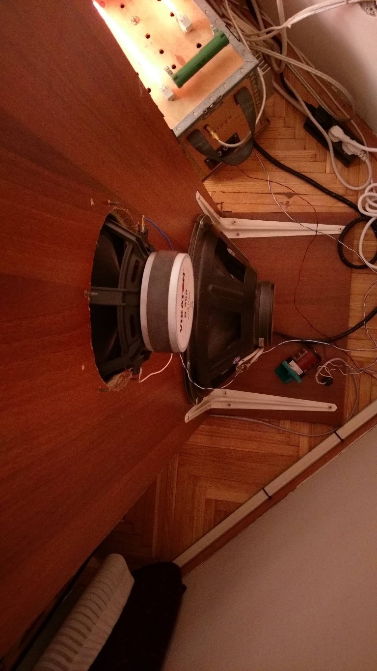

On my ex-Open Baffle speakes, I used Eminence Beta 15 (and a Visaton B200). Tried many passive crossovers, but was happy with none of them. The bass was alwayas "too light".
Until I went to biamping and EQ. I pretty much applied the crossover and an EQ from Nelson Pass "Slot loaded OB", 80 Hz low pass, 2nd order, and 160 Hz pass (2nd order). EQ bump aplied on the woofer and some some slight EQ on the fullrange. Only then I was really satisfied. (Until I got to move and dismantle the whole thing).
In summary: I don't think that Eminence Beta 15 can work well in passive OB.
I also heard Alphas, they subjectively give more bass, but again, I did not like them (Beta 15 with EQ sounds better).
But, with different drivers (High QTS woofer and a small, less efficient fullrange, like Manzanitas) things may work out differently.
Jerome, any chance that you can record a youtube video of your Open Baffles? That may give as a faint glimpse of how they sound.
Reactions: jerome69
